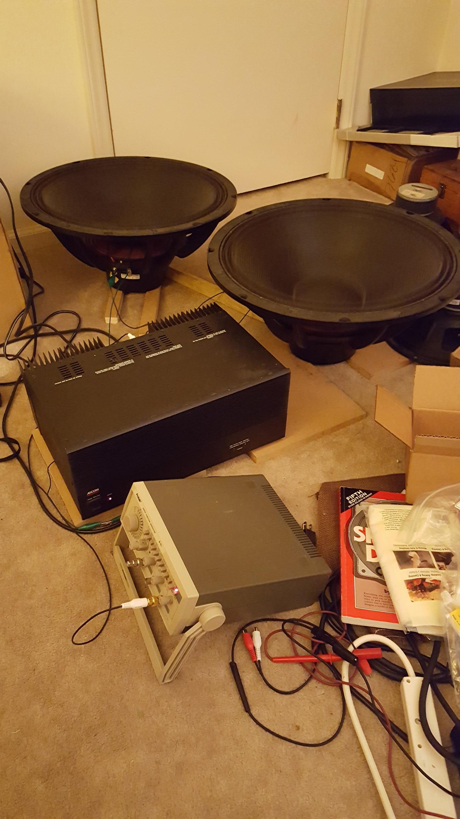

I'm breaking these woofers in with a 10 to 25 Hz sweep tone.
When in phase, these cones shake the floor!
This is considerable. Right now they're out of phase and the shaking is far less.
Having the pair thrust in opposite directions must make a difference in a cabinet, especially an ornate one with hinges and handles.

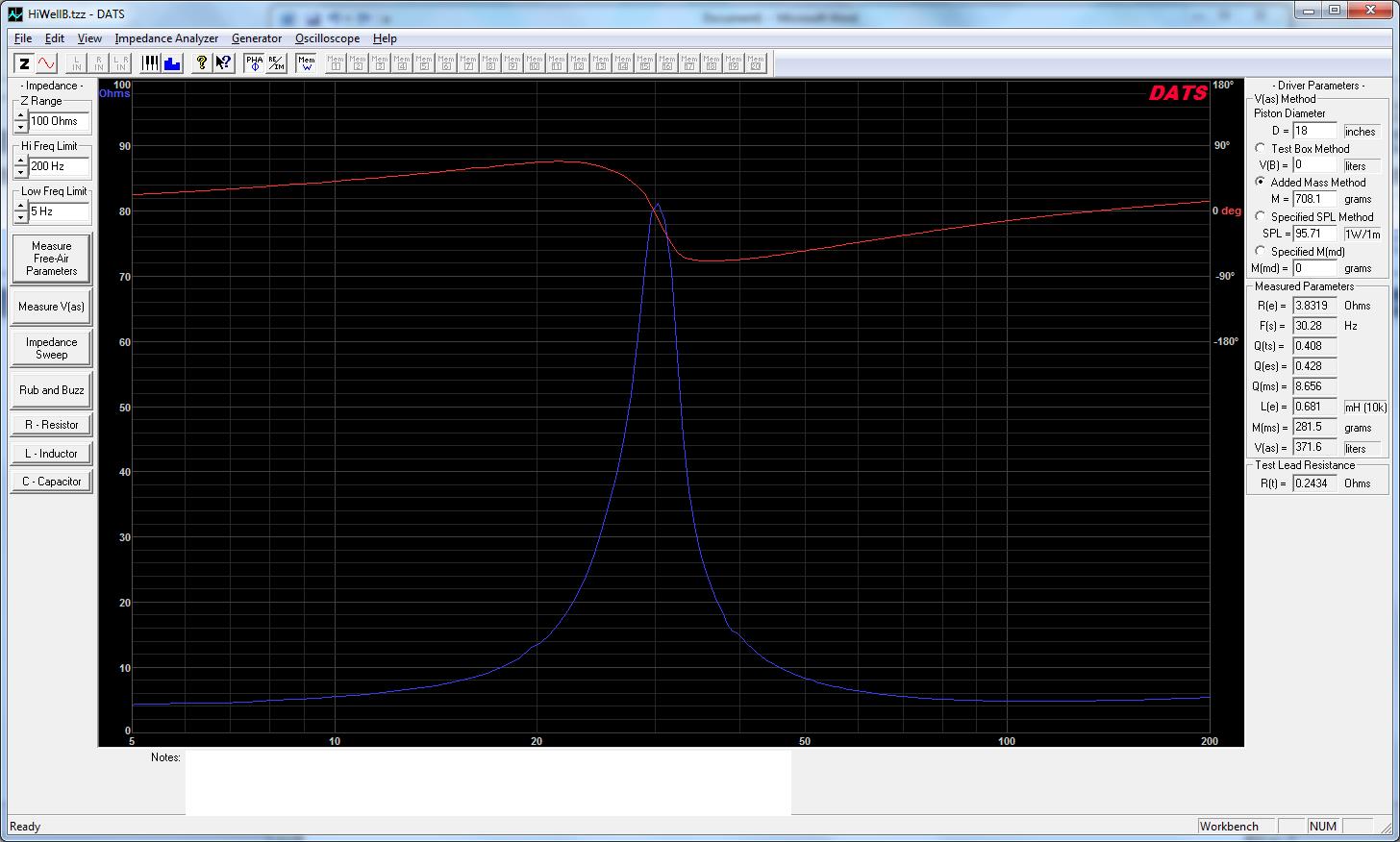

TS After Short Break In
All,
Here are the measured parameters after maybe 10 hours of sweep tones from 20 to 40 hz:
Driver A:
Fs 29.61 Hz
Qts 0.394
Vas 364.9 L
Driver B:
Fs 30.28 Hz
Qts 0.408
Vas 371.6 L
Is 10 hours enough? I had them sweeping through resonance and moving 10 mm. Wait, Xmax was 5 mm...

Clarification: I might not have even gotten 10 hours on these. How many hours does it take to fully break-in a large woofer? I can move these twice as much, I only had them going 5 mm each way and Xmax is 11mm.
If I am not close and these measurements are still "before," please let me know.

Not to overshare, but my wife has accepted 1 hour a day of vigorous...woofer break in. I have the sweep going a couple times a second about the Fs so from outside it sort of sounds like a dying washing machine from the 60s.

Really? You have to bargain for break in? I would go nuts too if you were running sweeps all day, but you don't have to, you are doing it wrong if you want to stay married.
Sweeps are a waste of time. You want the max cone motion with the minimum amount of power, so set your frequency generator to driver fs and blast it with a sine wave (or even a high crest factor signal at fs so it doesn't heat the driver up much). Set the drivers up cone to cone.
If you run them out of phase it should be whisper quiet (they will mostly acoustically cancel each other) but they will vibrate violently. If you wire them in phase it will be louder but they will force cancel each other so there will be no vibration ruckus. If noise is an issue wire them out of phase and put them on a bed or something to dampen the vibration.
Bolt them together. Just make sure that they are not touching each other, the air needs to escape (if they are in phase), so keep them about an inch apart at least, cone to cone, bolted with a bunch of nuts to keep the drivers attached to each other.
Like so - the red lines are the bolts, the green things are nuts to keep the drivers in place on the bolts and firmly attached to each other. Then choose in phase (for vibration cancellation) or out of phase (for noise cancellation) wiring, sit them on a couch or bed (making sure not to block the pole vents if the drivers have pole vents) and fire it up.
