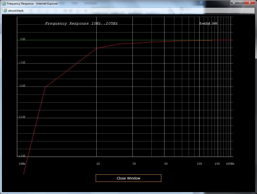

Same site, vented box calculator (do these assume Ql of 7?)
Volume Vb = 403.26 liters
Fb = 17.68 Hz
Peak = 0.100 db
F-3 = 16.69 Hz

I absolutely would not use the simulator on that site. If you are planning to use tunnels you absolutely need Hornresp or similar to get an accurate sim, and if the drivers are not equidistant from the tunnel exit you need Akabak.
And as I mentioned, there's absolutely no reason to add weight. This raises qts and your box is already on the small size (assuming you don't do iso, which you shouldn't, IMO).
