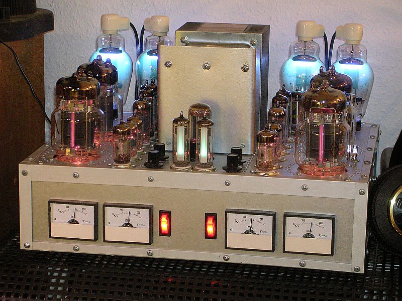

even your big tube spacings are too close for comfort, at least one and a half tube diameter apart for the power tubes...
That is where i intended to place them. 4 12v fans with a series parallel switch for silent or power use. I guess i was unclear. The sockets thmselves will be 20mm elevated from the chassis with brass spacers. Thanks for the observations!

Compared to premature failure of various components due to a cramped layout I would think reworking the chassis would actually be a pretty cheap fix in comparison to replacing one of those valves.
I agree. Regardless of fans I believe that if those big valves are operated at a proper operating point then they will overheat simply due to radiated heat.
It was only the other day that I was shocked by how hot a finned aluminium heatsink (about four inches square) became just absorbing the heat from four TO220 devices dissipating a few watts each! Here we are talking of four valves whose filaments require about 480W in total and with anodes dissipating what? At just 1kV and 300mA each we're looking ata substantial electric fire aren't we?

Do you own the book 'Building Valve Amplifiers'? It talks about the exact things you are asking about. As others are stating, you have a massive amount of radiated heat to deal with. Fans are not going to stop the large amount of radiated energy from one anode being absorbed by the anode next to it. As well as spacing, you need to consider orientation. The 'flat' face of the anode is going to radiate (and absorb) more heat than the narrow face. You should therefore have the anodes facing away from each other, such that one anode's radiated heat is not absorbed by its neighbour.

24 euros is cheap indeed for such splendid valves, but a melt-down could well cost more than a valve or two...

Also, 'Building Valve Amplifiers' says MV rectifiers generate RF interference and should be screened...
Everything is so... crammed in your chassis.

Many things are actually theoretical. Rf interference refers to external rf equipment. I have listened to bare circuits while burning in a huge mercry rectifier and no interference was audible in the audio band. I suppose a radio would have been blanked. Did not try

Many commercial products have MV rectifiers and are not screened

Thank you to all for the contributions. I appreciate every single input.
what I have done:
1. the gu81m in he "middle" between the rectifiers and the fron output tubes have been turned so that the anode plate is sideways. I can't do the same thing for all four tubes as the gu81m need to be slided in their sockets. It requires some clearance and if I turn the tubes with the plates facing sideways I can't get the tubes in their sockets.
2. I have marked the holes for installing a thin 200mm fan (actually 2 of these) between the output tubes and the driver tubes. Just connecting spots so I can experiment with different fan sizes.
What I will do:
1. keep a thermal sensor in my head at all times. I fear an IR thermometer will not cut it so I will rely on contact measurements. The operating point for all four tubes will place me in the 1400w range (total filament + anode dissipation).
2. Try to look into shielding. Lem8r suggested this as IR can be effectively blocked thus keeping radiated heat down.
3. verify once and for all the issue of RF interference. I have six slots. MV and XENON rectifiers. Plenty of ways to test for scatter.
This amplifier has the potential to surpass the Philips 1000w unit in every way. Please bear with me. The first lights are a matter of days away. 😉
