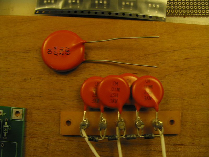

To increase HV efficiency, the transformer will require bridges. with gas rectifiers that can be accomplished either with tube based design or using a hybrid solution. I prepared a board to accomodate the "half bridge" required for hybrid operation. The common bus goes to main PWR ground.

I actually equalised the resistors with 2w 100k resistors just after posting the first photos...
what I don't know exactly is how to balance the diodes. 400k resistors in parallel?
I think capacitors are much better for reverse voltage balancing and snubbing at the same time. 10nF@3KV and the big one is 10nF@6KV
I really hope the tube/diode bridge works well...I don't have space of power for an all tube based bridge.
