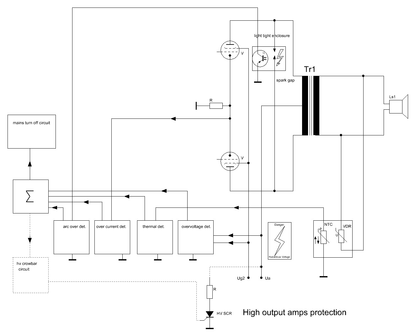

I tried to think of a resettable mecahnism.
Current limiting resistor is missing however r1 and r2 are part of the voltage divider. When voltage exceeds 4kv the divider will output above 300/350v. The cap to gnd will be charged and trigger the spark gap. It should also generate oscillation which the second cap will transfer to g1 of the thyratron permanently biased to -150v.
Coupling cap should be small and charging cap larger. I hope it makes sense 🙂 this is my best shot. Thealternative is to use the thyratron in reverse.

Hi! it is a grid controlled switch or rectifier. In my case i would like to use it as an emergency switch should opt voltage exceed permissible voltage.

Hi Alex,
the solution for your problem lies eventually here:
CA-Varistoren – CA-Baureihe – Industrieller Hochenergie-Scheibenvaristor – Littelfuse
Connect two of these parallel to the primaries and it will protect your opt from arc over in the future.
here are another protection circuit:
