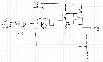

OK, this one works,
This design is modified from Horowitz and Hill and it works, it really works -- but you are going to have to add compensation. I found that the values in H&H and those which kept the device stable were different and no doubt you will the same. -- depends on the OPAMPs and the MOSFET's. <p>I use a 10 bit serial DAC from Maxim, since I have several laying around and have already written the code, but you can just tie the Inverting input of the opamp to +5 volt reference via a 10K resistor and adjust the voltage via the potentiometer (which is how it is described in H&H.)
Jack
Jack
