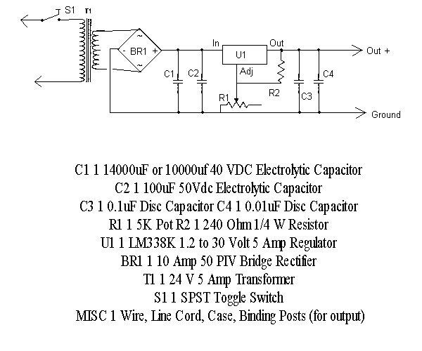

ive build my 1st PS. along time ago its +12/-12/+5/-5 3A one
the outlet volt in here is 220 , i just need to build a very good
PS. that can handle as i told b4 about 10A or maybe more current
with regulation upto say 40V. so i can test my upcomings Amp.
projects. (eg. the smallest and the only one i made is a TDA1554
one IC 12v. car amplifier so sure it cannt be properly tested with
my current one (3A Max.) and so on....
the only schematic ive found online is for the LM338K IC regulator
but its 5A, upto 30V and no neg. output (only + and ground)..
here its..

#1:
The potentiometer needs to be connected as reostat with wiper and one leg connected or otherwise your output voltage will go to rail-1.25 V when the wiper looses contacts with the track.

There are some 10A regulators like LT1038.
The problem is to handle the dissipation if you need a very low voltage at that currents.
The easiest solution is always a variable AC-voltage source (variac) followed by a rectifier and some caps.
But that might be cost intensive if you don´t get it second-hand.
I´ve seen a lot good offers on Ebay but haven´t bought one myself so far.

you also want to put a diode across the regulator to allow a path for the caps to discharge (rather than discharging through the regulator.)

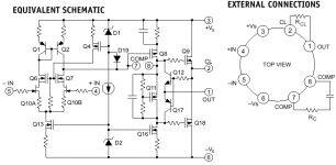

This is not an answer for you.
But if any TUBE guy comes in here (because of your Thread-name)
and wants real high voltage regulator,
here is one alternative.
It can put out 100mA and over 400 volts,
APEX PA88 op-amp in TO3 8-pin
PA88 High Voltage Power Operational Amplifier FEATURES, HIGH VOLTAGE
- 450V (±225V). LOW QUIESCENT CURRENT - 2mA. HIGH OUTPUT CURRENT - 100mA.
Before you go any further, calculate how much power your supply will need to dissipate. Take the voltage range (say, 10 to 40V); add about 5 volts overhead; multiply by the current you want (10A). The worst case is when the supply is set to the lowest voltage at the highest amperage.deepanger said:wanna to build a good reliable home PS. which can provide up
to say 10A with regulated + & - volts up to say 40V.
i know itsnt that easy project to build ...
but anyone has schematics for a similar PS.?
or even a good design guide?
thanks..
For these numbers, that's 350 watts. Per rail. The most heat you can pull from a transistor or regulator is probably about 50 watts, so you will need at least 7. Per rail.
You'll also need several large heatsinks. If you can find pictures of a 70 watt Class A amplifier, that will give you a rough idea of the size. Huge. Per rail.

The APEX PA88 is about $100 ea.
and it's SOA just isn't up to discretes -- at least if you want to pull 100ma at 400VDC -- I think the questioner, however, would be OK with an LM317HV, a little more expensive than an LM317, and a Pass transistor to do the heavy lifiting/current limiting etc. and if you don't want to invest in an LM317HV just lift the ground leg by inserting a zener.

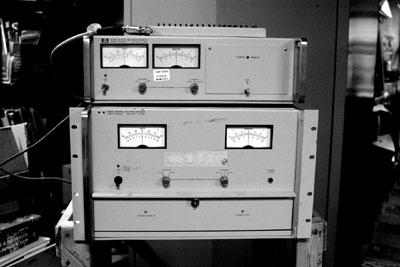

Dropping the voltage anything more than about 10volts is going to result in a MAJOR heat problem if you use linear regulators... With high current loads... ever medium loads.. for that matter, don't use linear, ITS CRAZY!!!
My Power Supplies
These usually go from $19 to $40 on EBay -- HP6129C, HP6130C. The big boy will put out a steady +/- 50V at 5 amps -- Industrial Style!!
The reason for the low price being -- shipping which will give you a heart attack, access to voltages at the rear, and, lastly you need some modest skill at building a programmer as the voltage steps are decimal powers of 2, 2's complement for negative voltages. They are a really good buy -- I've gutted one for an amplifier, but use the others. They don't program over GPIB, but you could use a HP3488a controller and relay board to accomplish this.
