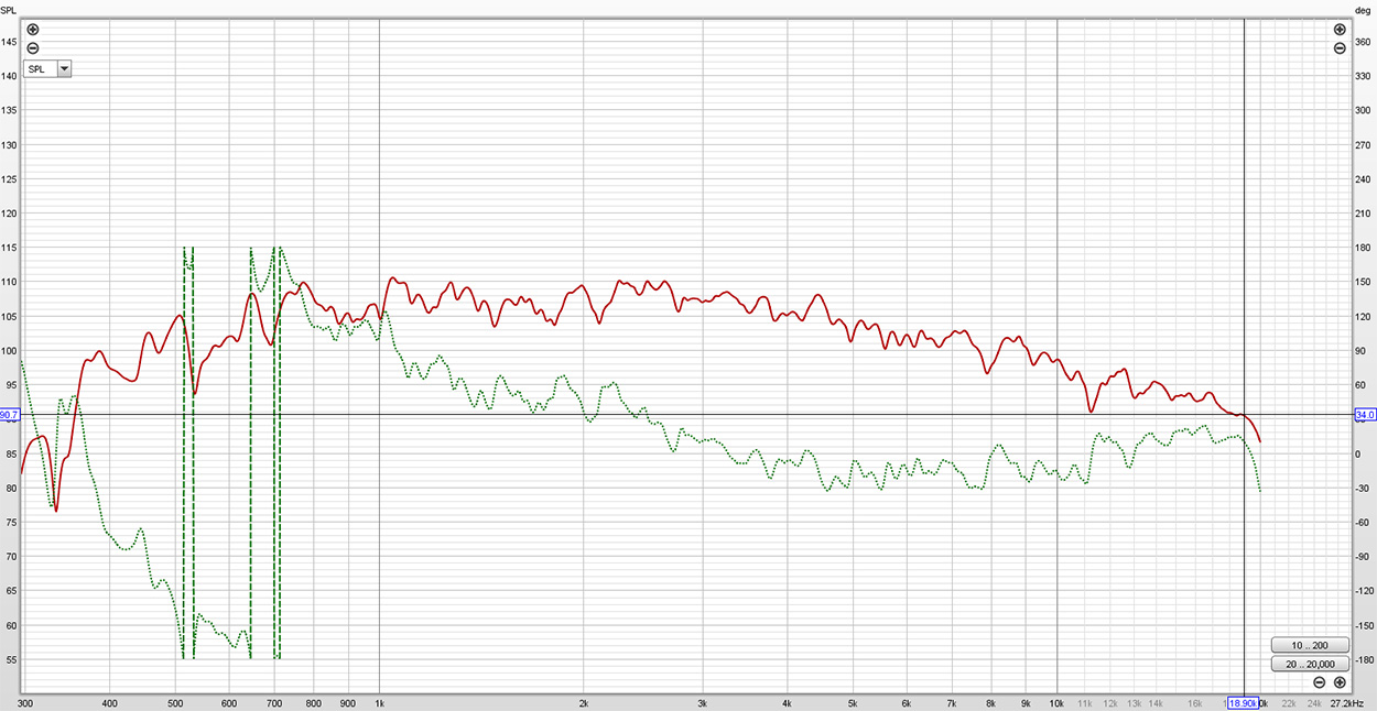

looking at the 1 meter fr, one subtractive filter should get the response ironed out to begin with. Sensitivity will lower, I can either turn the amp up or the input signal or use additive eq instead...
If aiming for 115db max system spl what power should I aim for with the AXi2050...I plan on covering 400hz on up with it.
