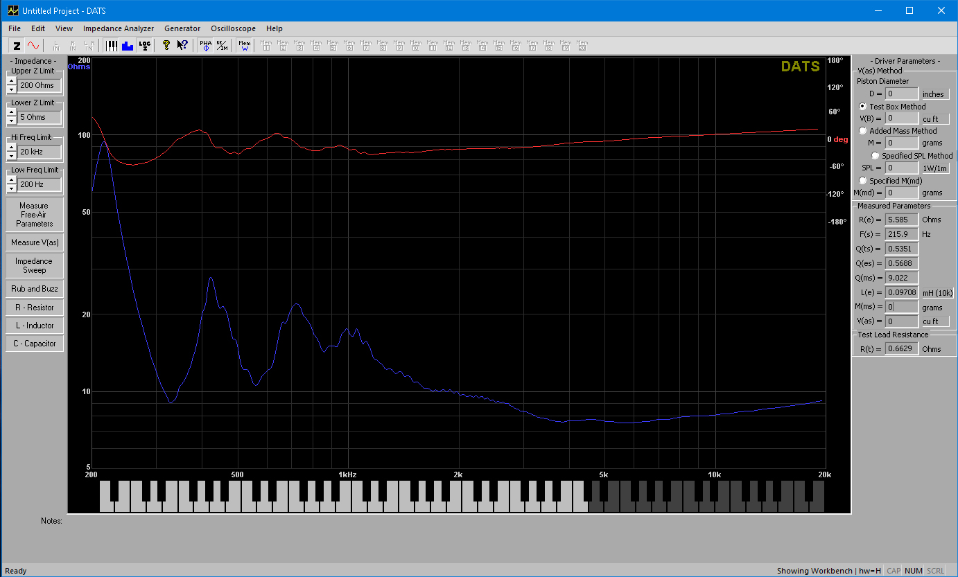

The 2440 struggles to make it flat to 8kHz so I have never tried to run it as part of a 2 way. The 2441 will however, and I think sounds a bit better than 2445 which I tried. I no longer have the drivers, but I do have the 'phragms which work fine in my 2440's but I prefer the 2440, it's a bit better at the bottom and mid portion of the range. The 2441 will run to about 15kHz but relies on diaphragm break up in order to do so, in order personal preference I would rate the 2440 better in the midrange when coverage above 7 - 8kHz is not required.
Above about 6kHz the T825 sounds better and I cross at 6kHz currently. The radiation patterns match fairly well both being bi-radial types.
The amplifiers drive the compression drivers directly - source impedance is something of a concern as these drivers were really designed to be driven by a perfect voltage source which doesn't describe my amplifiers.. The effect of varying load impedance can be greatly mitigated by using a lower impedance tap on the amplifier. (Sometimes some parallel impedance for load matching is helpful, but not always necessary.)

The axi is 8ohms
The mid and bass channels are 16ohms, the bass can be ran into 4 ohms in parallel. I figured 16ohms was cleaner.
Ive got Crown CTS amps...the times Ive run measurements and toyed with it I was able to eq it and have headroom and no hiss, not dead quiet...quiter than the class d amps in my krk's...
Right, interacting with the impedance of a CD/horn is worthy of attention as the impedance variations are usually large and ugly. Damping factor alone isn't going to cover the topic.
