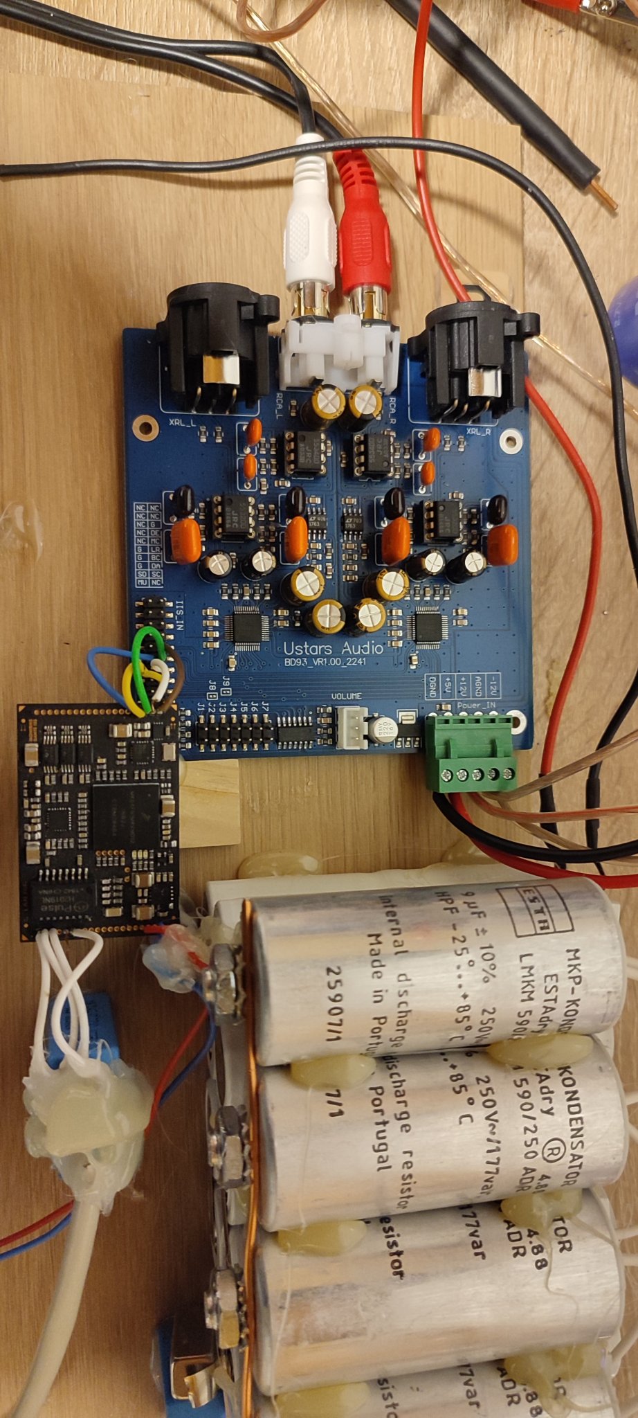

This was one of my first dante device for 99,-€.
Thats what i like to build. a simple dante device only for one speaker.
in your last reply you showed a picture with two PCM. the left little black board is the dante enabled device? the right blue one is for the audio convert from i2c in phase or analogue. But on some point there must be the ethernet input link and a "dante converter".
When you or someone build this for around 100,.€ this would be great. i dont need power over ethernet, all speakers are active powered.

Only theoretically because you need Dacs that support TDM signals.
Audionate does not reveal their format to private parties.
You can try AKM dacs which support TDM signals and try different TDM formats until it works.
You can also go via Lan to different endpoints that are configurable via Dante Controler Software but at the endpoints you still need dacs that can decode TDM streams.
My goal was just an 2 x 4 Channel setup with the Brocklyn II board alone being fed by my computer acting as the source and funktioning ans crossover and DRC.
But as of now I did not find anybody willing to programm I2C code to the Dacs and so the project is on hold.
Greets Klaus
