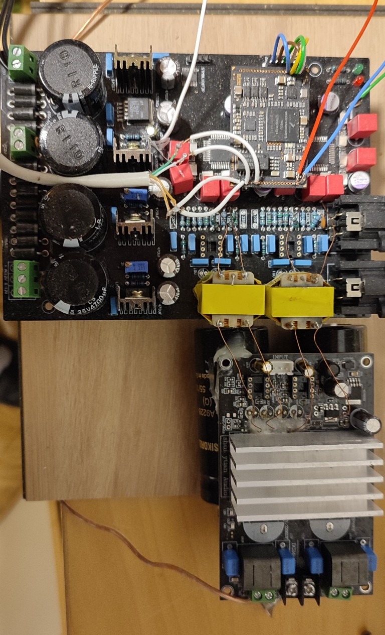

Thats very interesting. Thanks for sharing.Monism modules ,,,,, are way ahead of all my modified USB

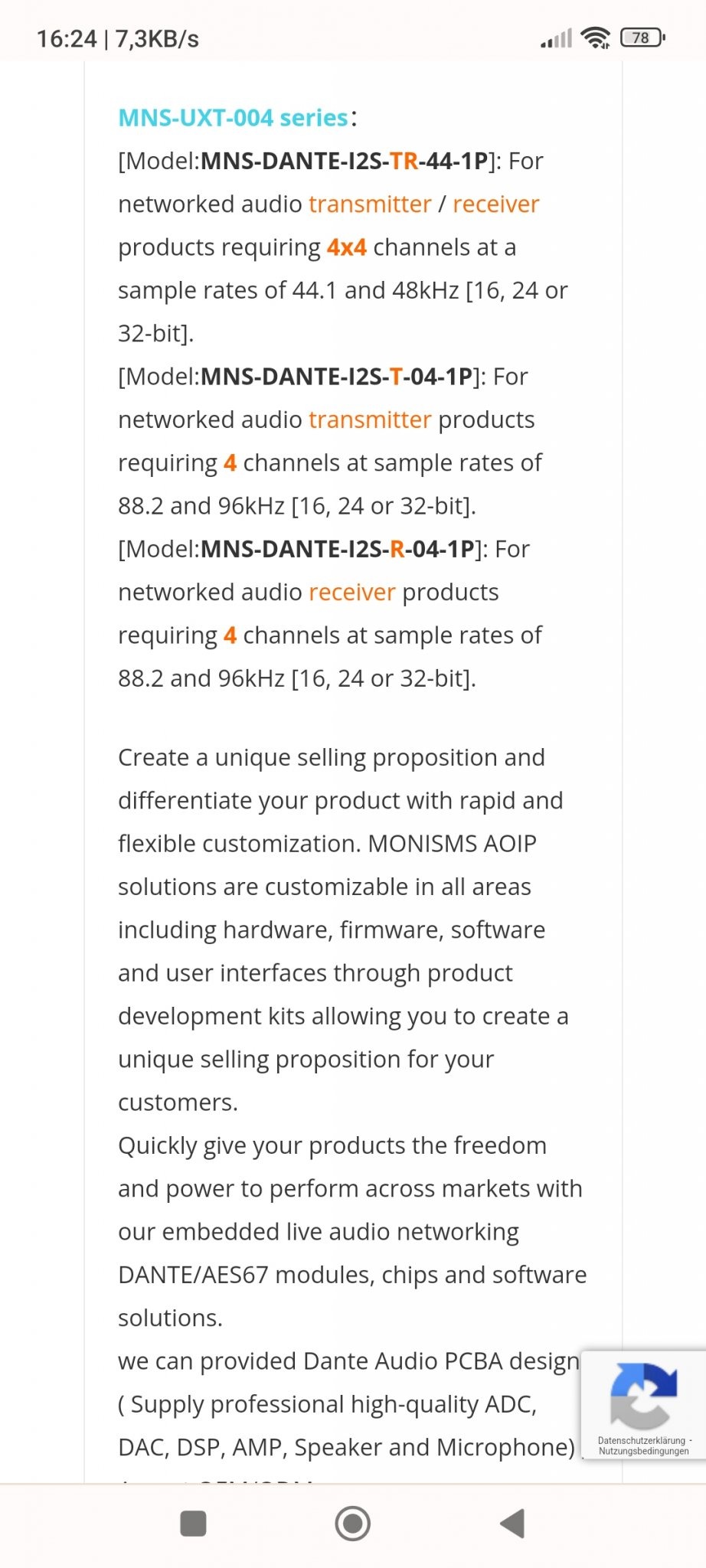

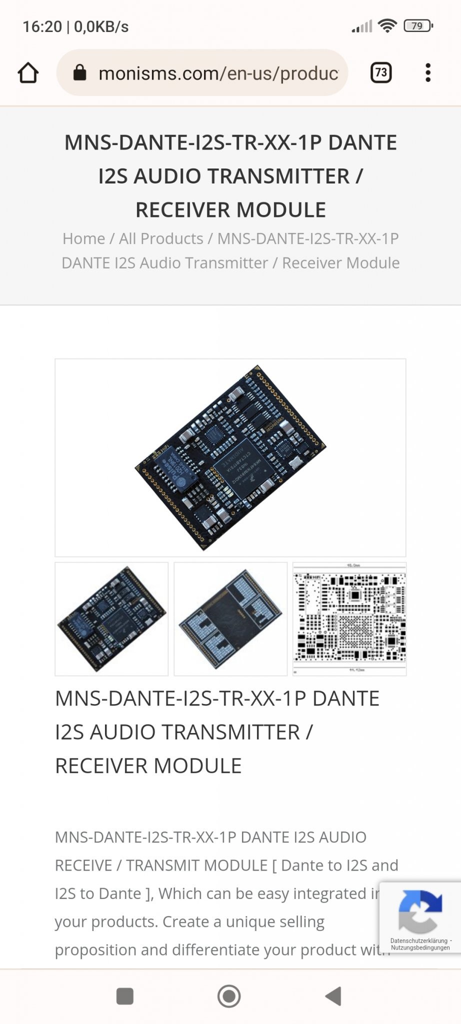

$129 including express shipping is what I payed for. That's not bad for 4 channel mono or 2 Channel stereo.

Nice find with the Monism card. The 4x mono out could be great for a stereo four-way active speaker system, with one card in each speaker and hopefully good timing integrity with Dante between stereo speakers.for 4 channel mono
Please can I ask some really basic questions?
1. Does the Monism do different digital data out formats like "right justified" for PCM1704, or is it I2S only?
2. Does Windows recognise the Monism card as an audio device over ethernet or do you need special drivers and software?
3. Did you ever get the Brooklyn dante card to work with a DAC? If so what's the sound like compared to the Minism?
Thanks.
The Monisms need the regular Dante Software. Channel routing is for free but for the Virtual soundcard you need to pay $30 For clocking, one device can be chosen as the master which makes all additional devices slaves that are in perfect sync.
The 16 channel Dante Card sends out all channels in bus format. The ak4493 can be programmed to receive this format but I have no time to learn I2C programming.
The ak4493 dac boards that I use for modding are in software mode and are being controlled via I2C by a seperate chip already. I want to tap into these programming lines but as I said I can't programm.
I am happy with the Monisms boards so I am in no hurry to get the 16 channel board working.
