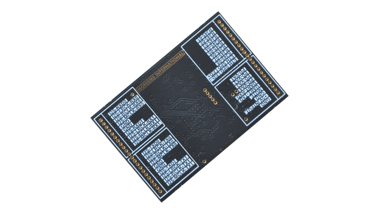

The Dante routing software recognizes the channels of the Monisms board. I2S is send to the dacs by 4 different data Pins sharing LRCK, BCK, Mck.

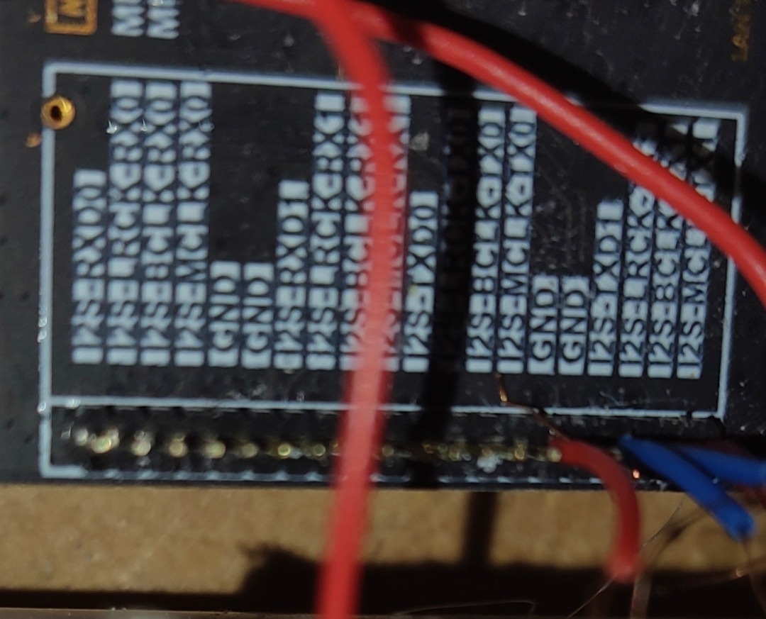

Pardon the poor quality this is the mid high section way in the back of my Hifi sideboard.

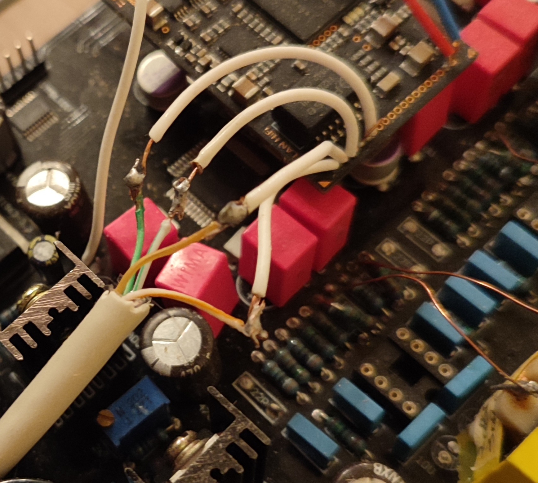

As you can see two I2S pairs for transmiting and two for receiving. On the other side I attached the cut Lan cable to the pins. The markings on the board are pretty much self exlanatory.
I could not find any plug that would fit the form factor of the boards so I used thin solid core copper wire that are clamped to the binding posts by the sleeves of other single strand wires.
Yes Ethernet. In the above pic you can see that I just cut the Lan cable and soldered it to the pins. The underside of the boards are marked fool proof. When ordering tell Lili you need the connector not only holes. I forgot to tell her and had a real problem to solder the wire to the narrow spaced holes.How do you send data to the Monism - is it ethernet from a PC? What software players work ?

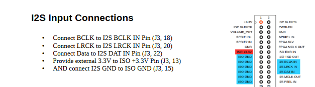

Soekris apparently takes standard I2S (two channel multiplexed on data in) without wanting a Master Clock:
While Monism delivers the same standard I2S:
MONISM MNS-DANTE-I2S-R-04-1P For networked audio receiver products requiring 4 channels at sample rates of 88.2 and 96kHz [16, 24 or 32-bit].
This looks like a simple direct fit.

The Monisms work in normal I2S mode. There was nothing I had to do to get it to work with my AK4490.
The Brooklyn II has totally different customers in mind. It is mainly used for professionel Audio applications. Afaik it can put out 32 channels in 96khz mode and 16 channels in 192khz mode.
Data output is in TDM format going sequencially to the different output pins.
