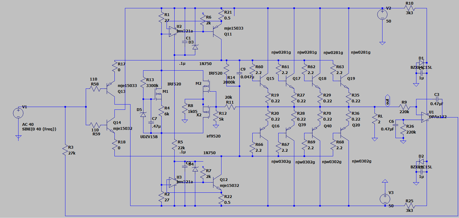

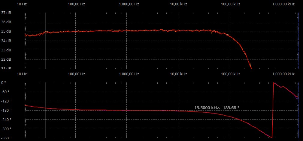

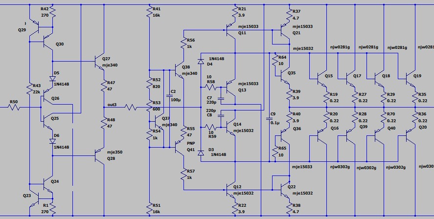

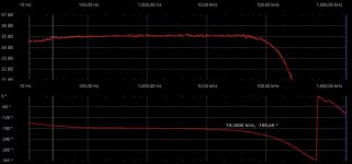

Solved the problem of oscillation on Pioneer A-09 output stage with a filter before the 500KHz.
I have prepared the environment for a listen test.
Both the output stages are connected by the same driver stage.
The frequency response now have a limit 238kHz at -3dB.

Is the LP filter to avoid oscillations composed by R58/R59/C7/C8?
What is the purpouse of the diamond buffer on the left of the bias selection? Does this input typology have higher input impedance?
From the pictures I assume that the voltage stage is the same as the high power hybrid amplifier.

I have use an input resistor, on the right of out3, 1k1ohm and C7/C8 to have 238KHz at -3dB.
This evening I had a listening session with a friend of mine who has considerable experience recording and hi-end playback and we agreed that the Pioneer A-09 output stage sounds much worse than the original AR D100 configuration.
I am using low bias from 5 to 100mA without any differences.
The condition of original Pioneer A-09 was 170mV on 0.44ohm so 0.386A for each final transistor but it means 0.386 * 4 = 1.54A at 90VDC => 140W (original was powered with only 28+28 so 56VDC)

In short, the sound of the Pioneer A-09 output stage has a much more evident and less pleasant midrange even with loudspeakers with paper cones.
The only positive factor is a greater sense of power without limits.

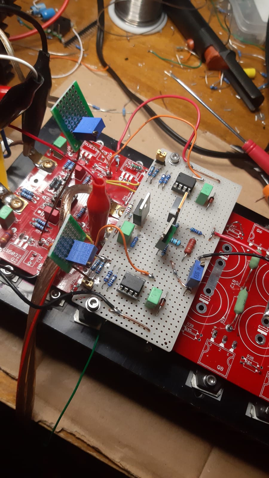

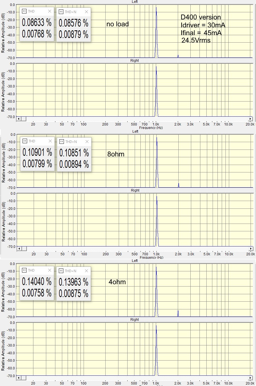

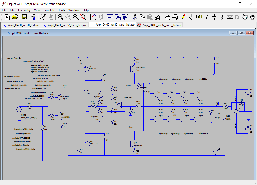

I have tested the performance of the D400 version
The result is good but still to test the sound result.

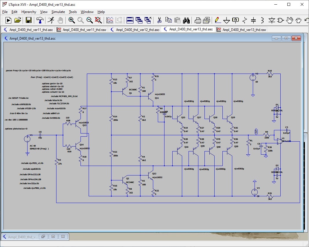

In this case 3 trimmer has been used
1) level of the correction
2) bias of final transistors
3) balance the current generator to compensate the mosfet P/N differences
Only few opamp are good for this use, I have used SA5230 like original and 2SK216/2SJ79.
I think that the definitive solution if we have to use such a complex circuit is to measure the current absorbed by the load and not the voltage to correct the generators.

The D400 circuit have a very clean behaviour! How does it compare to the distorsion figure of the original topology (end stange only)?
