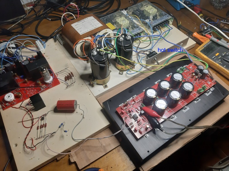

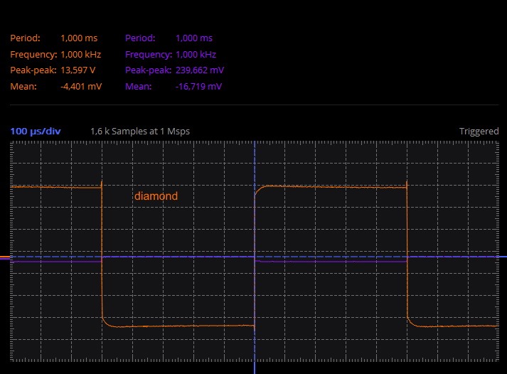

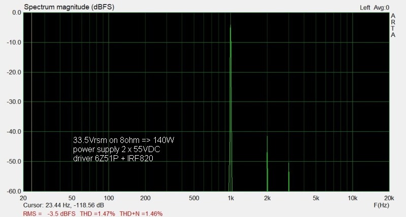

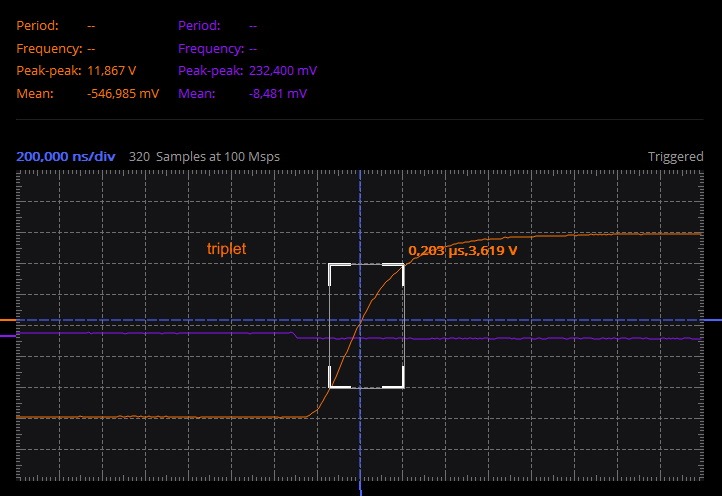

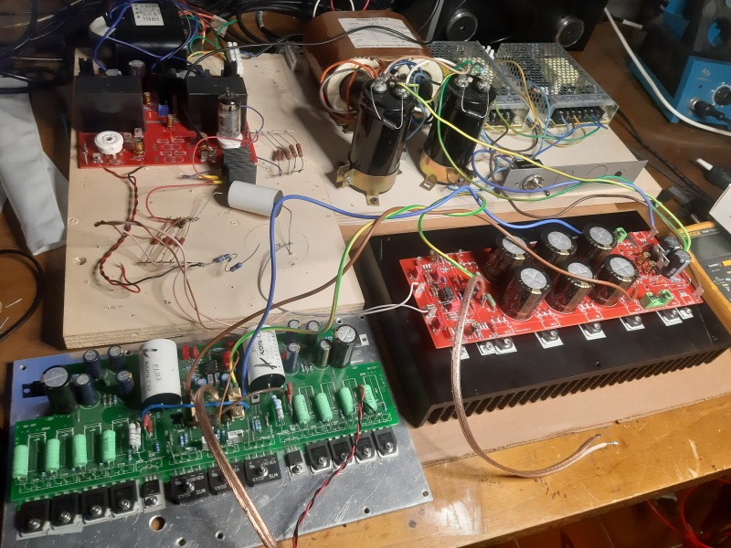

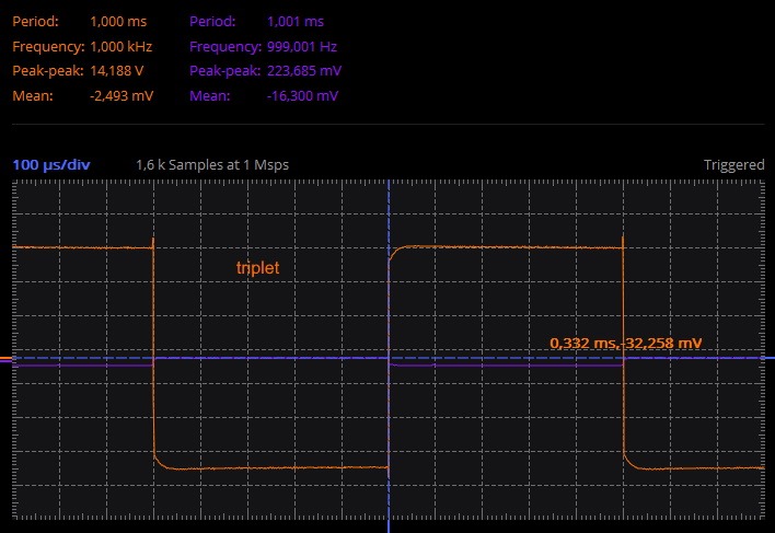

Just finished in a 150mmx350mm chassis, gain stage is outside.
