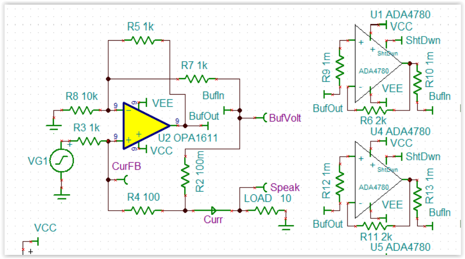

Mix current and voltage drive
By adding a variable feedback resistor(R5) we can mix different levels of voltage/current drive.

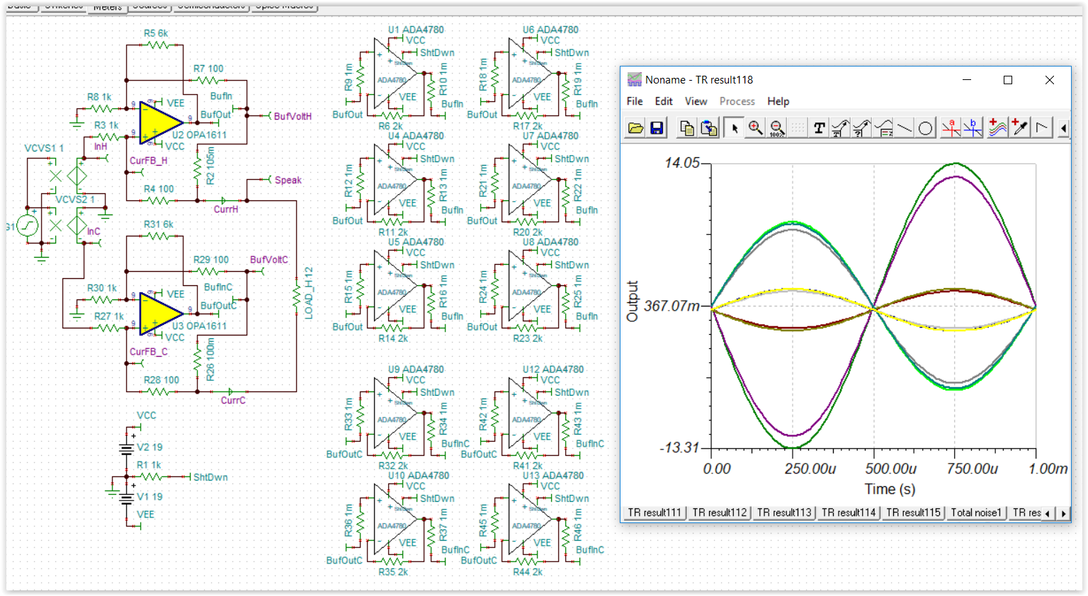

Bridging with two current sources in series is not feasible, for even a slight difference in the currents will bang the load to the supply rails. To use bridging in current drive, the other half has to be a voltage amp that preferably only mirrors the potential of the other side. The result is still current drive. Keeping the whole stable is more demanding than with a single amp, but it can be done.
That is a really good point ETM, and something I overlooked. Why use two current drivers.. :headbash:
When simulating these things one tend to use equal values and these things does not show up. I have tried a simulation with a 5% error in the current resistor and that gives a huge imbalance in the voltage from each side as can be seen on the attachment. I will start working with an inverted voltage follower as you suggested. Thanks for the tip.

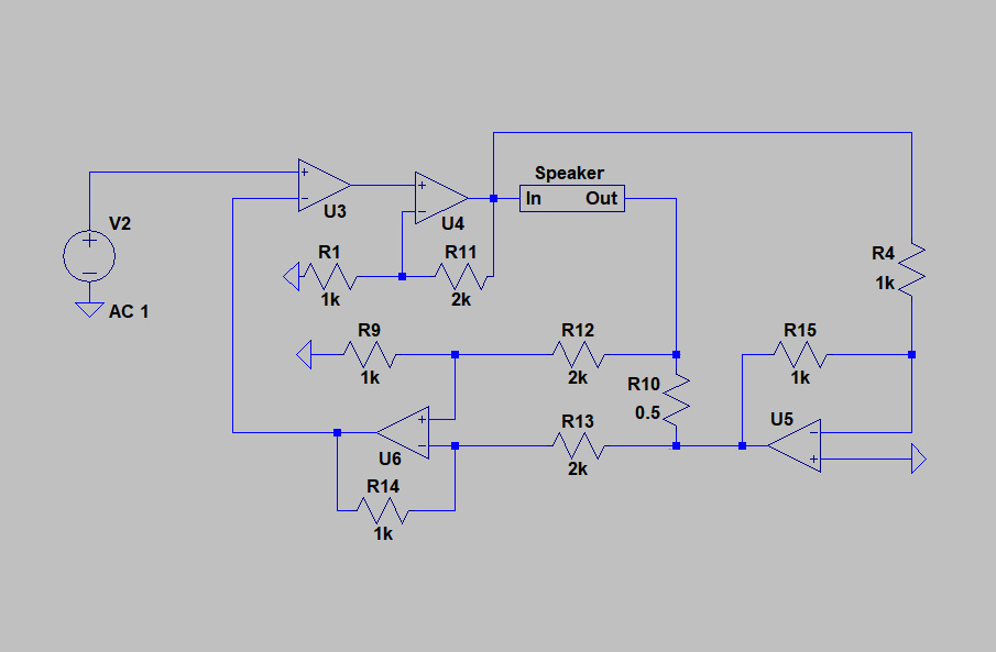

That's absolutely true.
The right side of image in #29 did exactly what ETM suggest, mirroring the other side.
This setup is not prone to any such sensitivities.
And the ADA4870 (not ADA4780) that you suggest is a very nice component.
With 8 of them you can drive 4 Amp through an 8 Ohm load.
Hans
There is something odd. It seems to mirror the sensing resistor voltage rather than the load's.

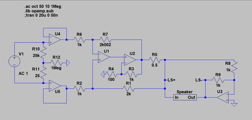

Nice to see a thread going on this. If you have not seen it, there is a great book dedicated to the current drive of loudspeakers. Current-Drive - The Natural Way of Loudspeaker Operation I have experimented with the LM3886 chip amp. Using a 0.5 ohm resistor in series with the speaker ground for current sensing and directly attaching this node to the negative input of the amplifier rather than the voltage divider worked fine. I also found that a line level Linkwitz transform solves the low damping issue for the driver low frequency resonance very nicely. I look forward to trying out some of the circuits you have shown here.
And based upon the topology that Armand used, here is a balanced and bridged version.
Keeping R1,R2 and R6,R7 within 0.1% (see image below), CMRR is 70dB over the whole FR range.
CM input impedance 1Meg, DM input impedance 50K.
U2 and U3 could be composed of a number of ADA4870 OPA's.
Just a generic design, not yet with protection measures.
Hans

I do find the circuit interesting. However, 70dB CMRR is not an impressive figure. Off course it could be improved by increasing the precision of R1,2,6 and 7. But those resistors are also a source to noise. That is the reason for my desire to make this a balanced amp.
Why not just control U3 via the input signal?
So, let's just say that 100% current drive is not realistic, and that when we convert the current sense feedback into voltage, we could, if we have a signal that can drift to compensate, feed the same correction to both halves. So the two halves are fed by a signal that simply lets the entire circuit drift off to make it perfectly symmetrical at all times, and that both halves then effectively could control at least 90% current and 10% voltage.
The idea is that any conflict will not cause pumping, but instead a CM drift that the speaker will not react to anyway.
