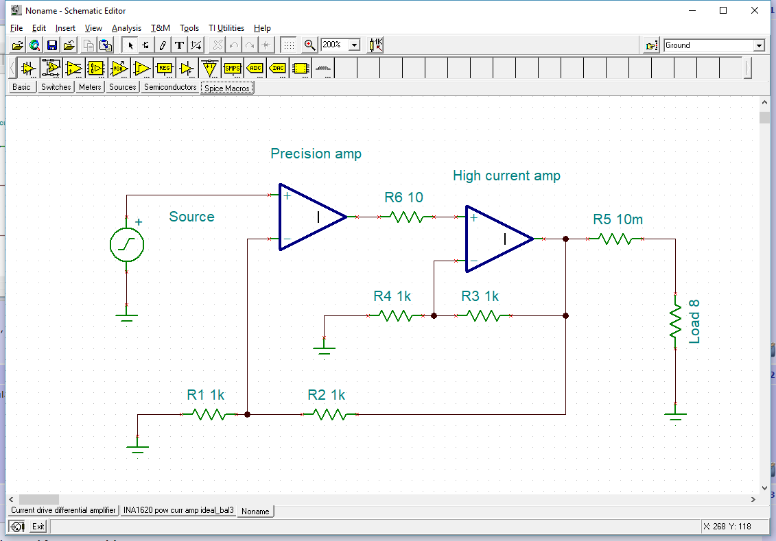

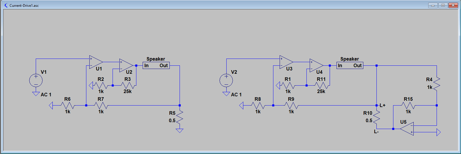

I can fully understand why you want to build a Current Drive Amp.
But I do not understand why you want to use op-amps with their restricted supply voltage of some +/- 20V max, giving a 12.5Vrms or 19.5 Watt/8 Ohm, quite a distance from the 80W/8 Ohm you are aiming at.
At Fres, depending on the amount and type of damping material used, impedance of a speaker may be quite a bit above the nominal impedance, so maximum voltage output should not restrict this.
Hans
(Your circuit in posting #9 to operate needs the + and - inputs of both amps to be reversed, apart from the fact that this is not configured as a current amp.)
Hi Hans
Bridging then will give the output will give us about 50W/8ohm @ +/- 15V, 72W/8ohm @ +/- 18V, 80W/8ohm @ +/-19V and 89W/8ohm @ +/-20V.

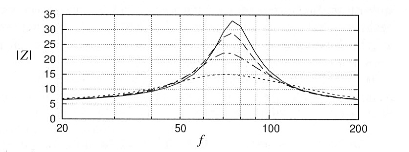

Speakers do not increase their impedance if you use more damping material, but there are other, far more significant reasons for using current drive. Please read the prior posts.

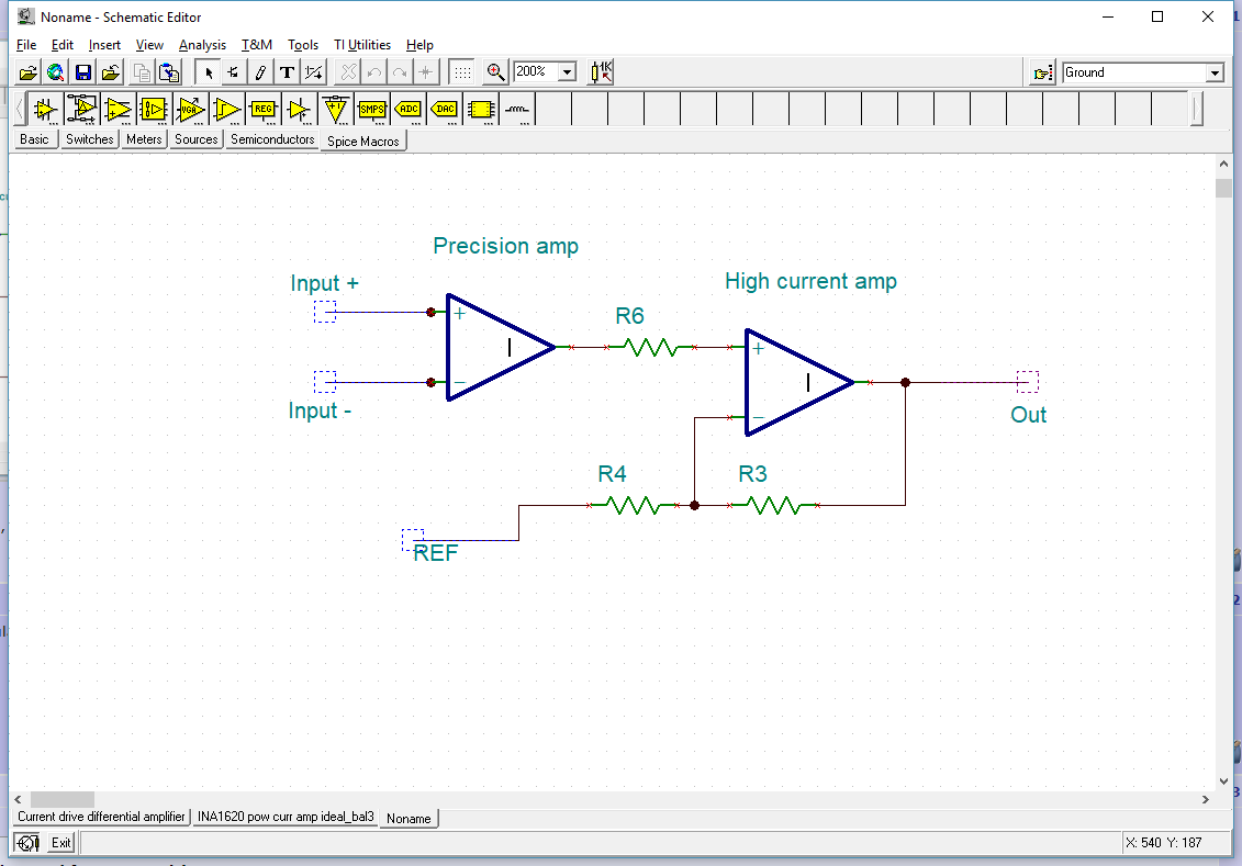

You are right, the op-amps are turned upside down (they are by default) and I forgot to flip them. This is just a principle for using a high power op-amp together with a high precision op-amp, benefiting from the capacity of the high power op-amp and the precision of the other op-amp. A complete current drive amp sure looks different.
This is what it could look like:
Hi Hans
Speakers do not increase but decrease their impedance depending on the amount of damping material. See image below. From top to bottom, no damping, resp. 50% filled with cotton cloth, 80% and fully packed.
You used a layout where one side of the speaker is connected to ground. A simpler floating version is below with a floating speaker. When going to a bridged solution, the speaker has to flow anyhow.
In the image below a single and a bridged solution. U2 and U4 have to be very fast amps with high supply voltages. U1 and U3 can be low voltage op-amps. U5 can also be a low voltage high current amp, possibly a large number of opamps in parallel.
Hans

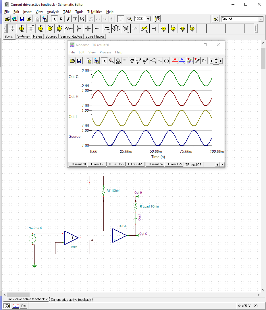

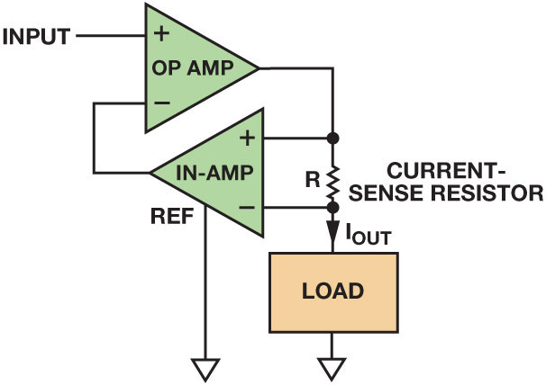

I mentioned in a few posts earlier in the thread that the plan is to go for bridging. The schematic was just to show the principle of composite amp. The other schematic shows the principle of current feedback using an op amp and an instrumentation amp.
For a bridged amp, I would prefer a symmetric design. Your designs are a bit hard to make balanced.
I tested some other options also. Here is one:
And I flipped it around a bit to achieve a closer connection between ground and load:
But as everyone can see, the actual "Hot" output is not the one close to ground. This circuit can't be balanced either.

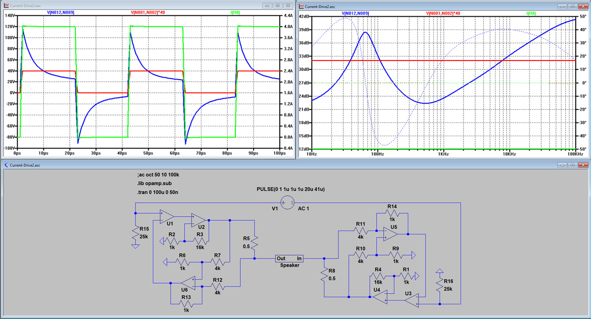

Here an example of a Balanced current amp. Gain is 1/0.25, meaning 4 Amp out / 1 Volt input. Again, U2 and U4 are high speed, high supply and high current amps. The other 4 amps are single fast op-amps. Load is a simulated speaker.
In the image below, Red is the input signal magnified 40 times, Blue is the voltage across the Speaker and green is the current through the Speaker. FR shows a flat spectrum for current whereas the voltage across the speaker shows a curve directly related to its impedance.
In the time response you see a perfect current square wave following the input signal, while the voltage across the speaker follows a complete different path.
Hans

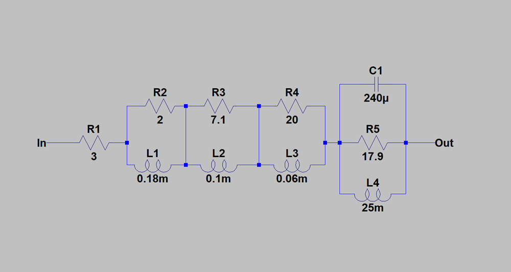

I can adjust to any bandwidth, it is just a model, I could lower BW a factor 10 but that doesn't change anything to the model itself.
The speaker load that I use is a simulation model of a specific speaker.
See image below.

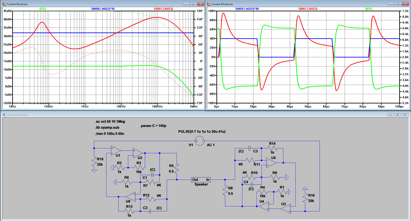

If your point is that EMI filtering is important, I totally agree, but as a scenario from real life with high power 1MHz signals, I doubt it serves a useful purpose.
One way of looking at this is by focusing on the waveform. Another way is to view this a 1MHz signal over a large inductor that obviously has very large impedance at such frequencies. We would get the same result using a resistor with the same impedance at 1MHz, and we would also get the same result using the same size resistor at 100Hz.
An amplifier of this kind needs some control circuits. One obvious is a zobel-filter across the load. Another one is input EMI-filtering. But we can not know if the link to the load momentarily breaks, resulting in a sudden voltage peak. For that reason, and several others, we also need a circuit that monitors the output voltage. It could affect the local feedback of the output op-amp turning the amplifier in the direction of a voltage amplifier. Other ways are to limit the voltage, reduce the parallell load, reduce gain and so on.
No, I did not have EMI filtering in mind, I just came with a generic model and did not care about the colour of the interior or the safety belts.
Once agreed upon a design, those things can be added easily.
But since you attach great value in having a model with a more normal bandwidth, I have adapted the model to this.
To my opinion, one should concentrate on how to realize U2 and U4, with OPA's or discrete, before going into further details.
Hans

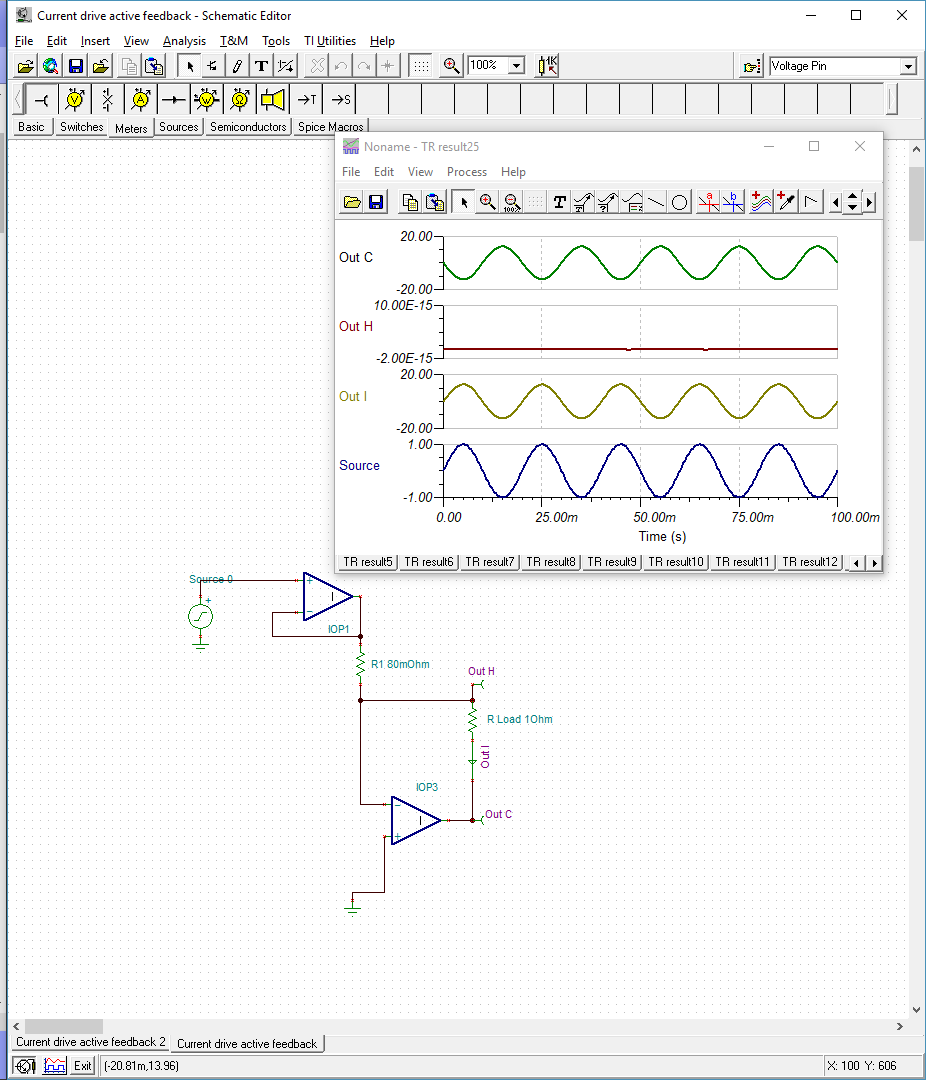

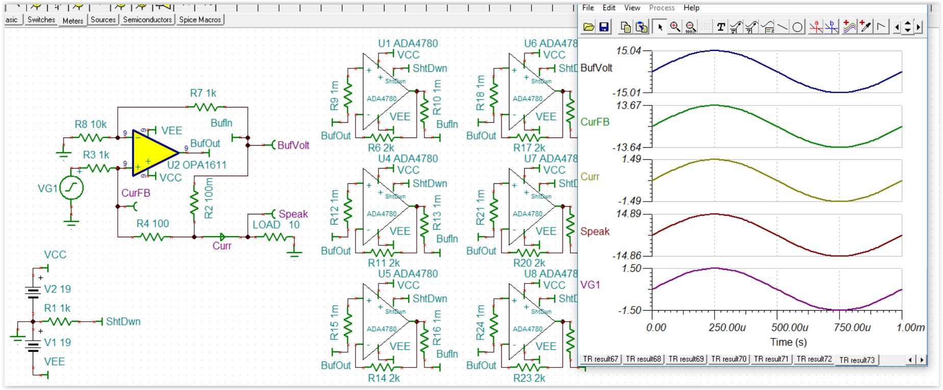

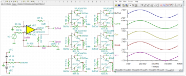

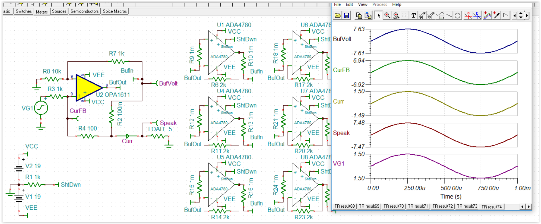

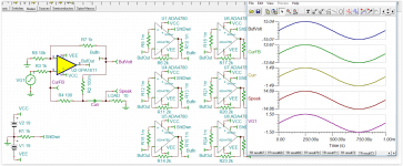

Alternative current drive
This is a circuit I have been playing with today using level 3 SPICE models. Much simpler and 100% current drive. Can easily be bridged. In the two attachements everything is equal except the load that is 5 and 10 ohm.
I have collected all the 6 buffers on the right side.
