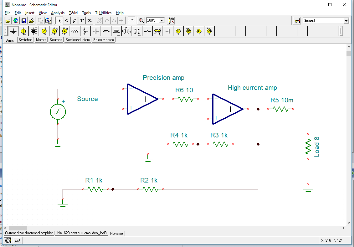

Not sure why you would use a ton of small Op Amps, typically able of supplying 5 to 20mA each, and swing between +/- 15V (or less) while you can control a couple regular Power transistors from one Op Amp and achieve same quality and way higher current/voltage/power handling.
There are op-amps with 5-20mA current capability, but there are also several higher current options out there.
In terms of voltage, one could always use bridging. A 36V op-amp in BTL config would be capable of providing enough voltage swing for any high efficiency application.

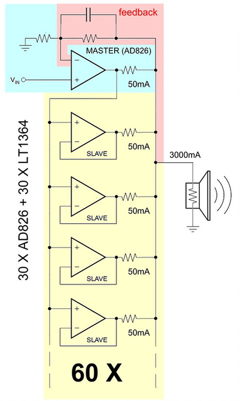

An Italian member has posted on chip amplifier forum dating may of this year. You can add a current feedback to adjust the output impedance.
That is a very cool way of stacking, but why use this instead of feeding all the op-amps from the same signal directly?
The Italian fellow has studied the question seriously before adventuring in such expensive project. I invite you to read his post Parallel opamp: an extreme audiophile amplifier made of parallel multibrand op-amps

I am curious as to how layout will effect the actual performance.
Me too. The current drop sensors could be integrated into the circuit, but after that, we might just have to add a bit of extra copper as we are moving outside the feedback loop. However, the voltage feedback sensor would be prior to all of this, so it could turn out to benefit from an even stronger path between the op-amps and the current sensor serial resistor.
However, you might have based this on the idea of using very low power op-amps, thinking there will need to be hundereds? Did you see the op-amp Armand points out? The ADA4870 is a beast with 1,2A current limiter.
Another option could be the 145mA OPA1622/INA1620, but they are about 30% of the pricing of the ADA4870 so there are no savings here. The suggeste composite setup is indeed interesting with a low noise/high current product as the ADA4870, leaving the precision task to an op-amp like the OPA1622 or similar like this:

Thanks for the link. I see he used a rather different approach, limiting himself to through hole components and experiment boards. His selection of op-amps are seriously outperformed by more modern alternatives. Using higher current op-amps as output stage, SMT, of course, and a more compact PCB layout should offer some serious combined advantages.
