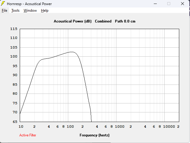

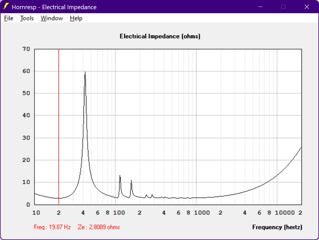

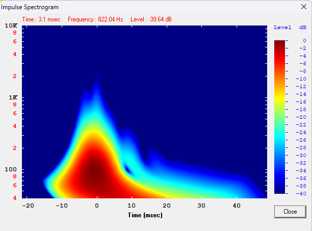

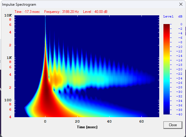

Shes a ringer... But After crossing, she rings no more... Sorta impressed? Is this too good to be true? Why aren't these things all the craze?

if you don't offset the drivers properly and tune the massload properly you won't get that wide nice smooth FR, so its not just another BRIt's just a BR enclosure. Nothing special other than 2 x 18" drivers in the same enclosure.

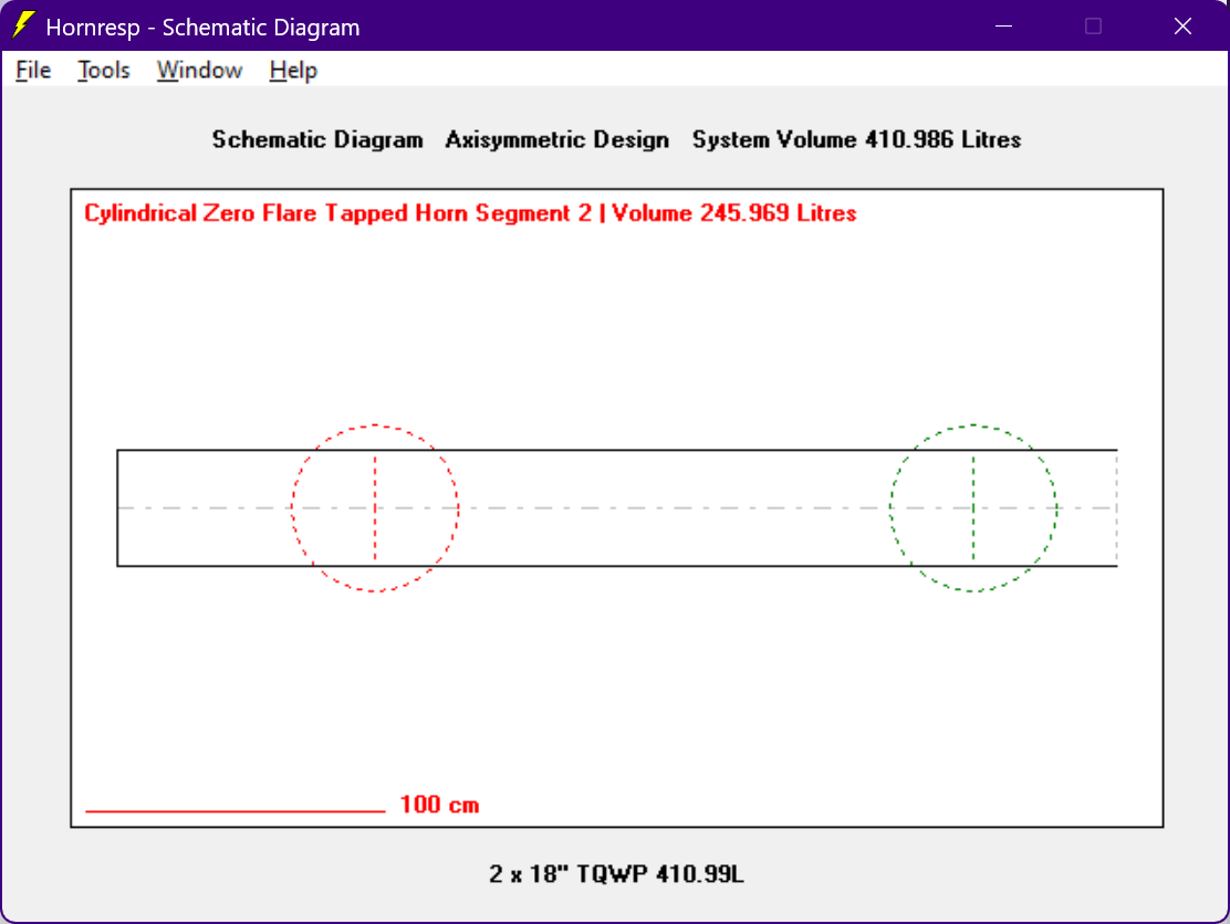

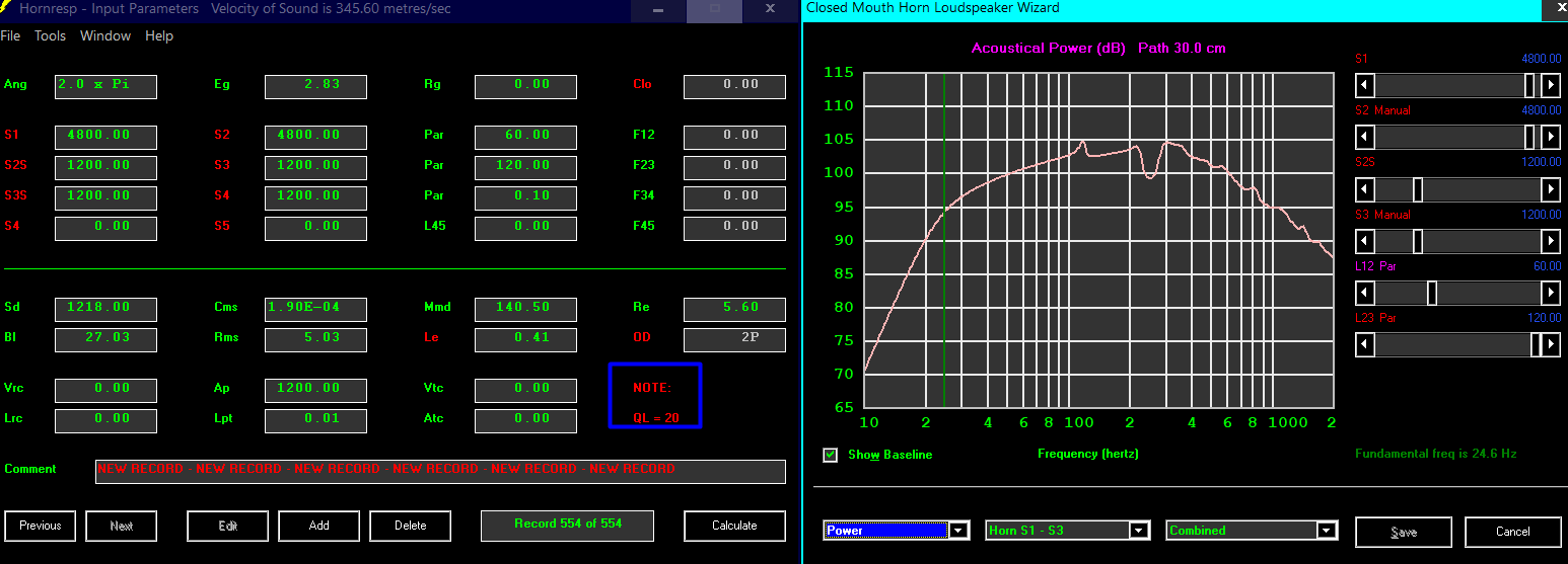

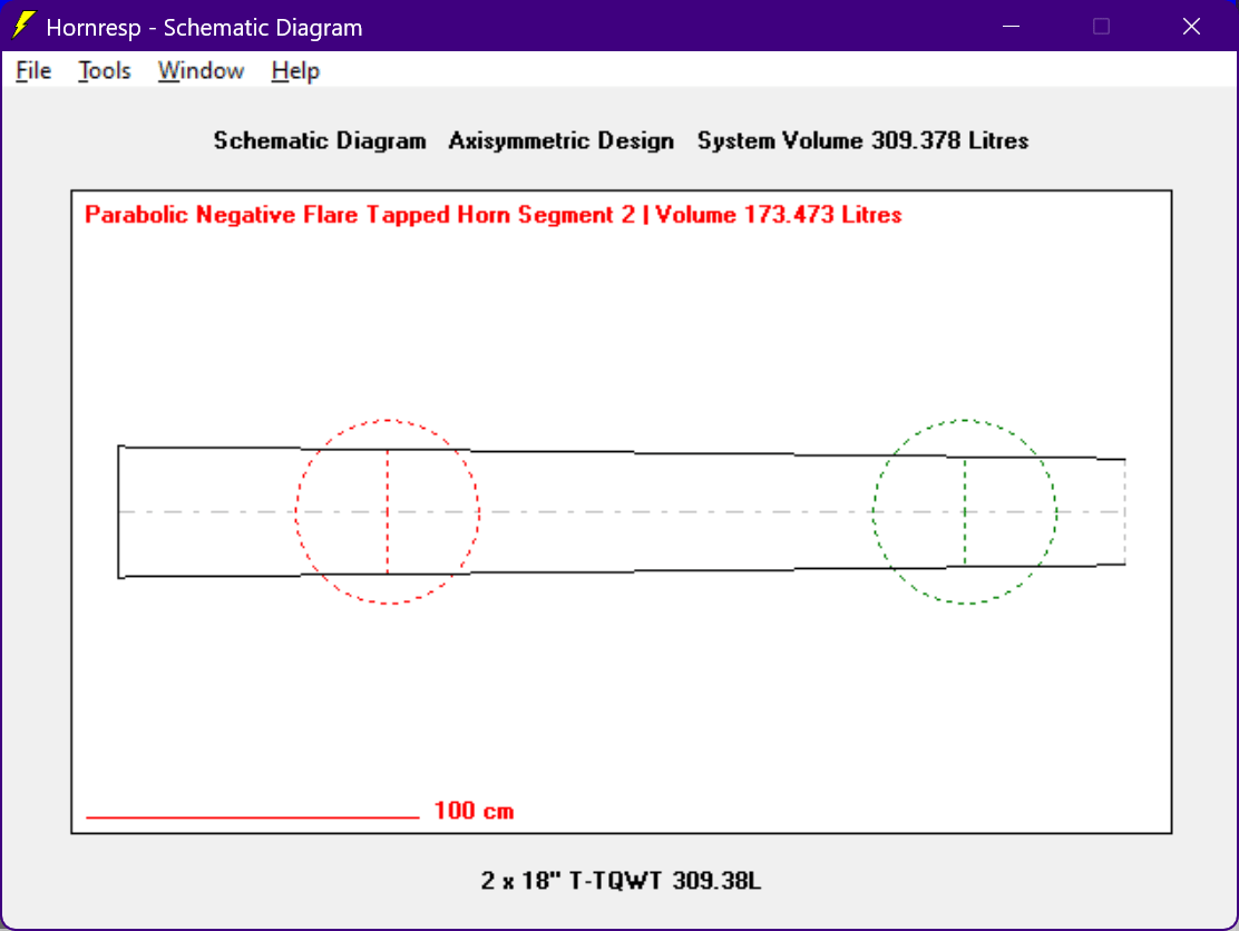

Well, one can argue it's a crude inverse TQWT, but to be a TL its acoustic pathlength must be a 1/4 WL of the tuning, which at a glance I'm guessing not.

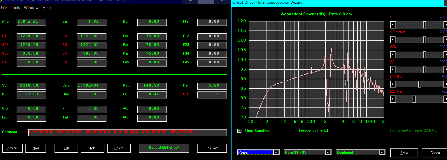

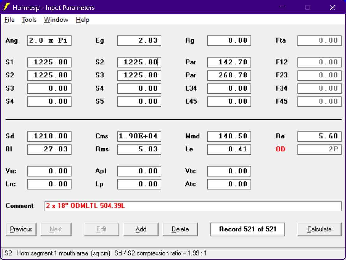

good ole offset driver 'qw' resonator with three 60 cm folds? your driver has a super compliant suspension and a low QES, kinda interseting. Might need to enlarge all of this to fatten up the bottom end ?
(there’s a bit of stuffing in the 4800cm2 x 60 cm offset stub section)
You left off the ‘mass loaded’ port/shaped section? That might have shortened the resonator down to 120 cm (~216 hz as the (3x 1/4 wavelength) pipe resonance @ top off requested bandwidth )
3 fold again? port @ like 1/3 Sd though? didnt you used to design them like this back in the qw group court?

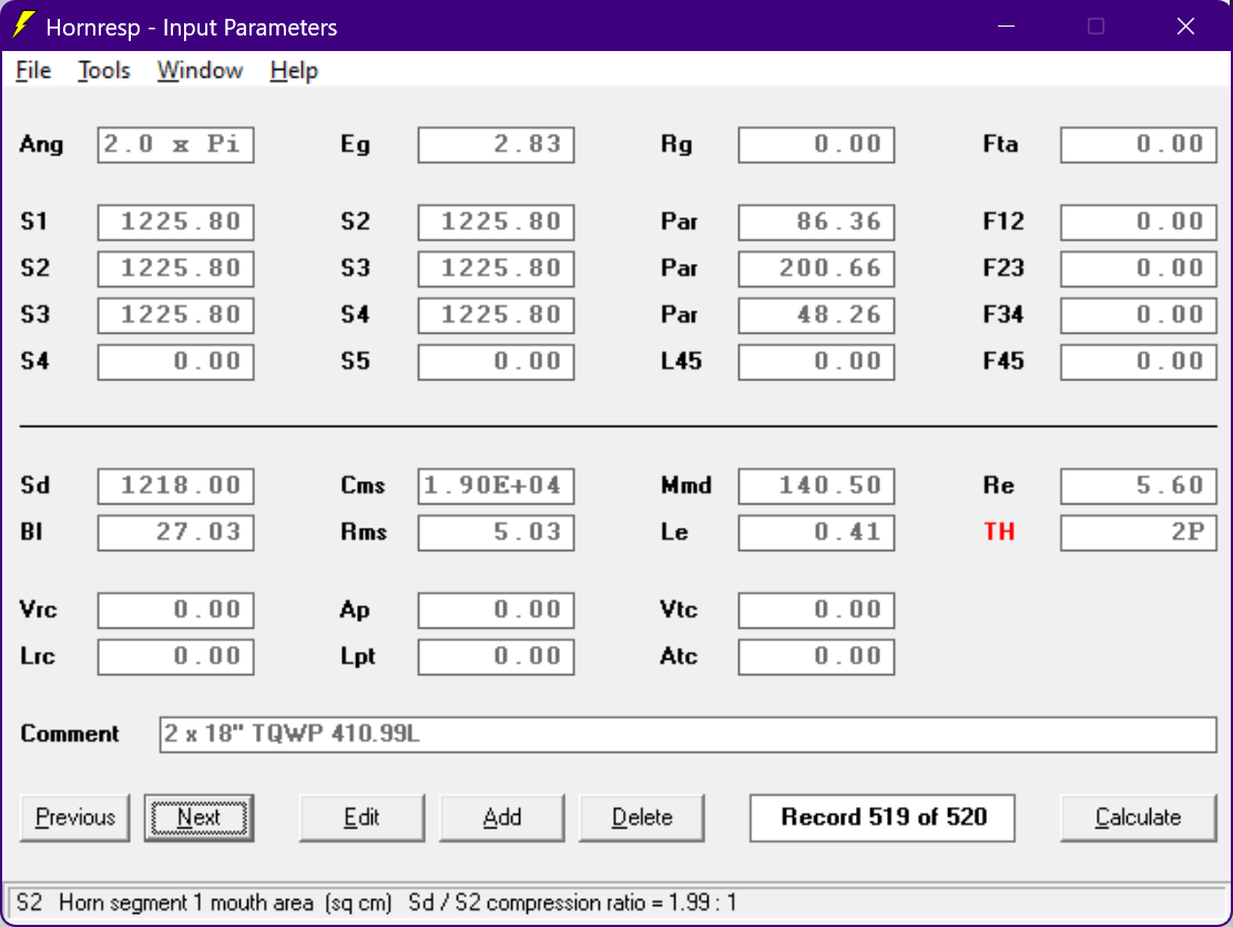

Also, a 305cm2 mouth is kinda small for two 18's.

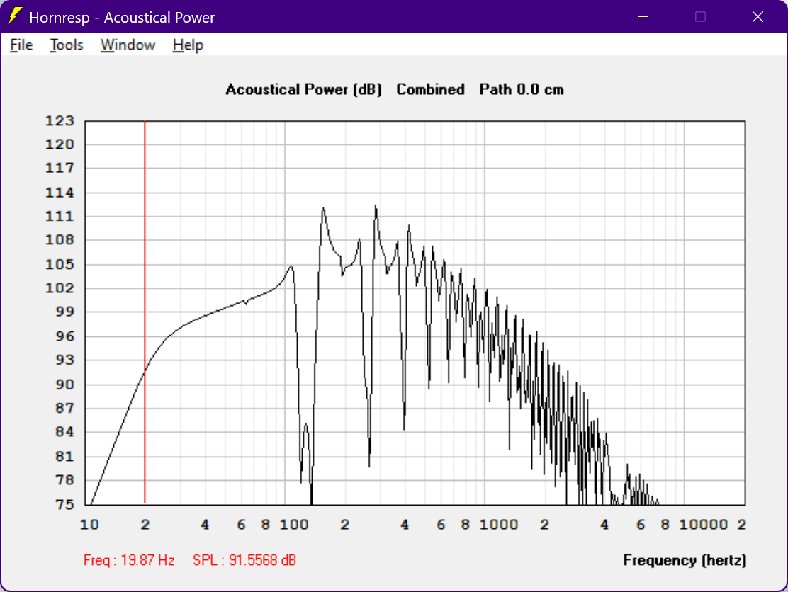

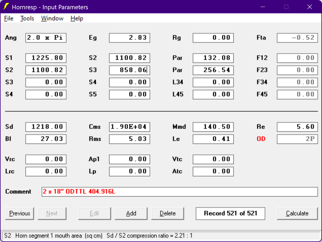

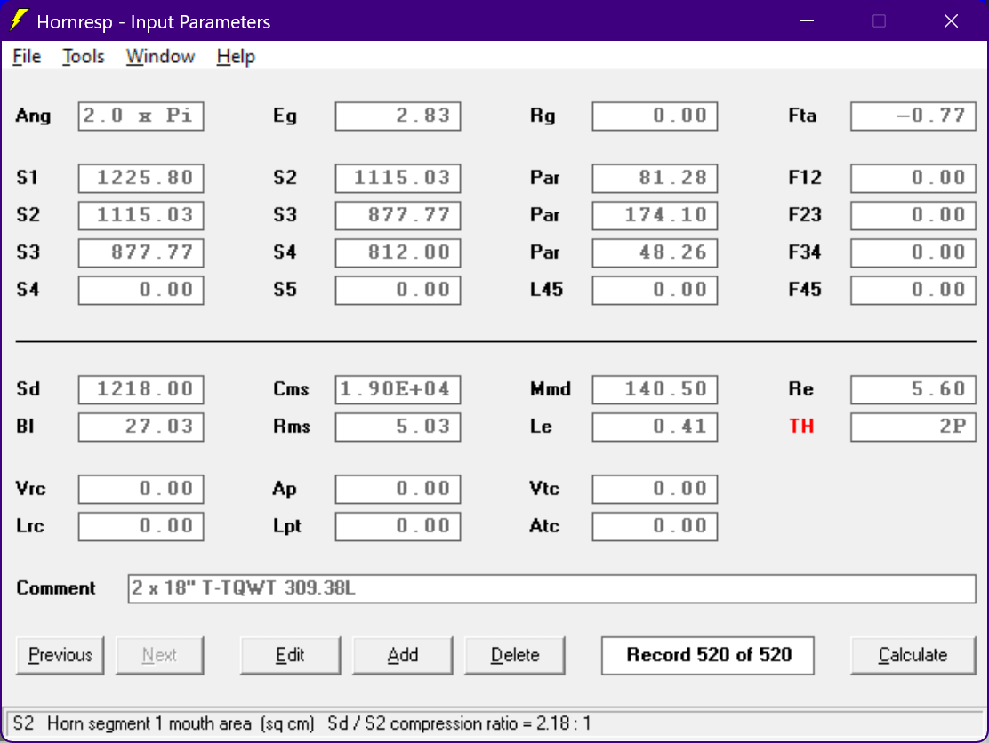

(1218cm2 x 2 drivers)/3 = 812cm2.
858.06cm2 = 19" x 7" mouth.
Oh, you modeled one 18.
305cm2 mouth still seems too small.
I'm thinking at least 406cm2 mouth for that 18.

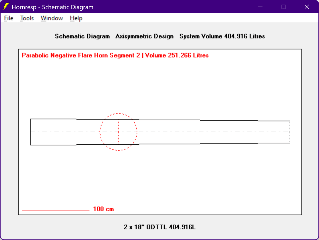

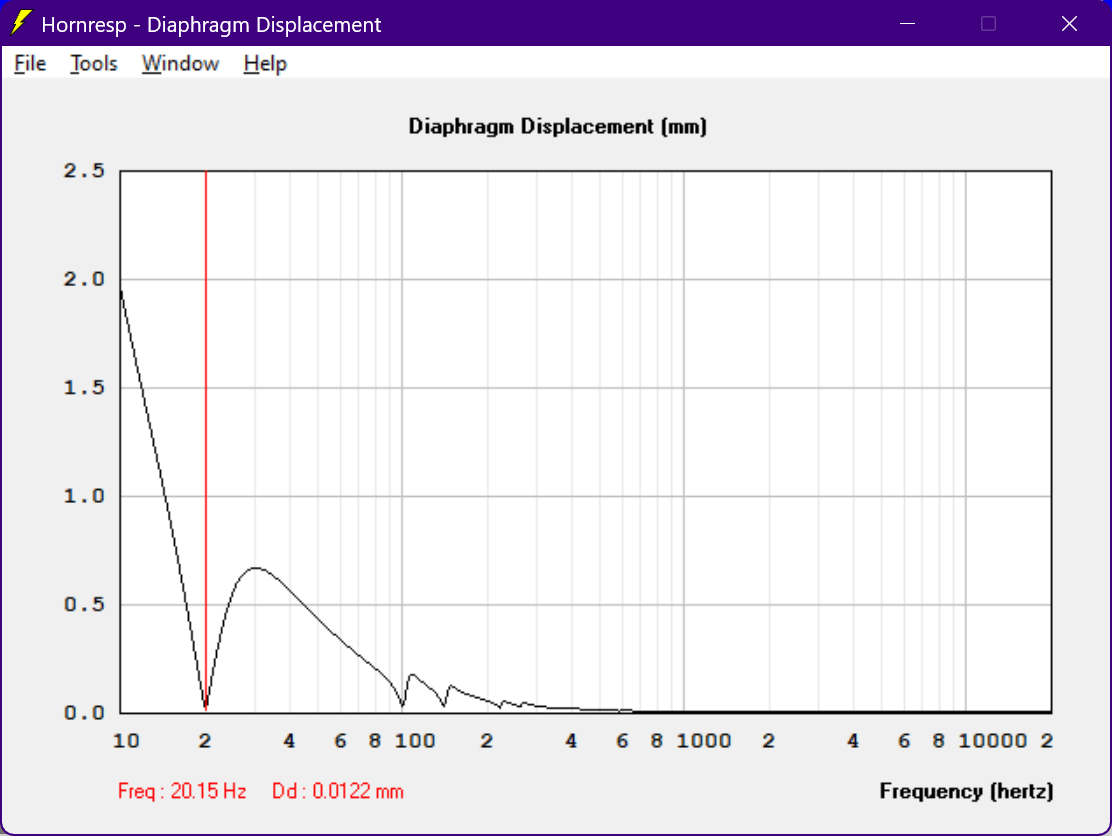

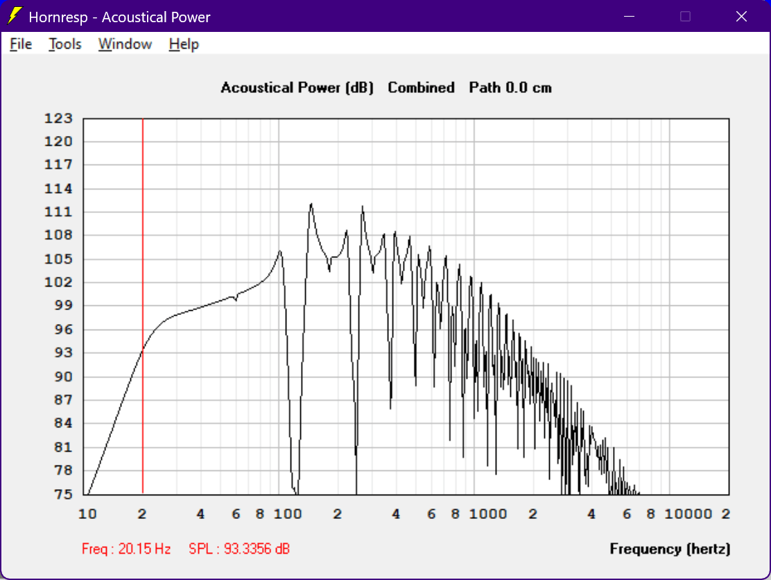

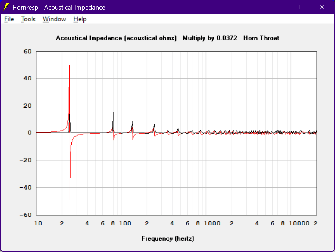

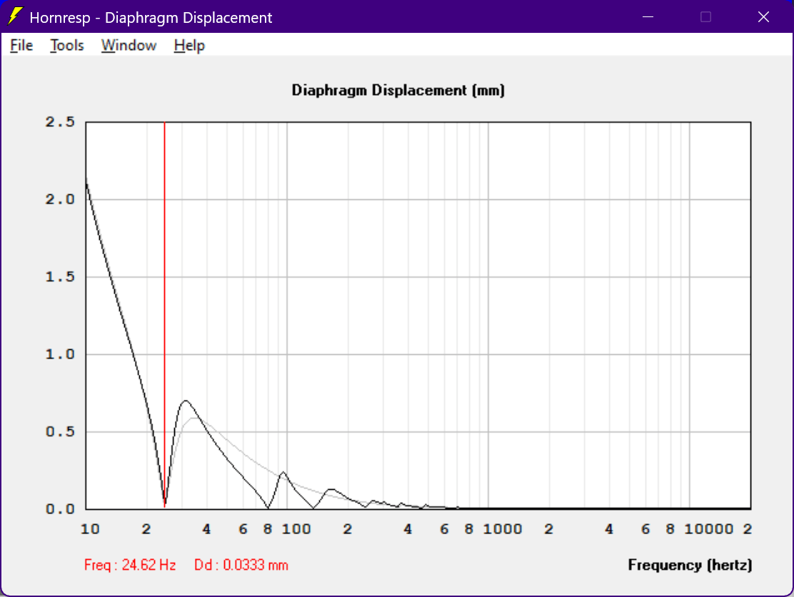

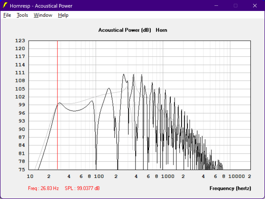

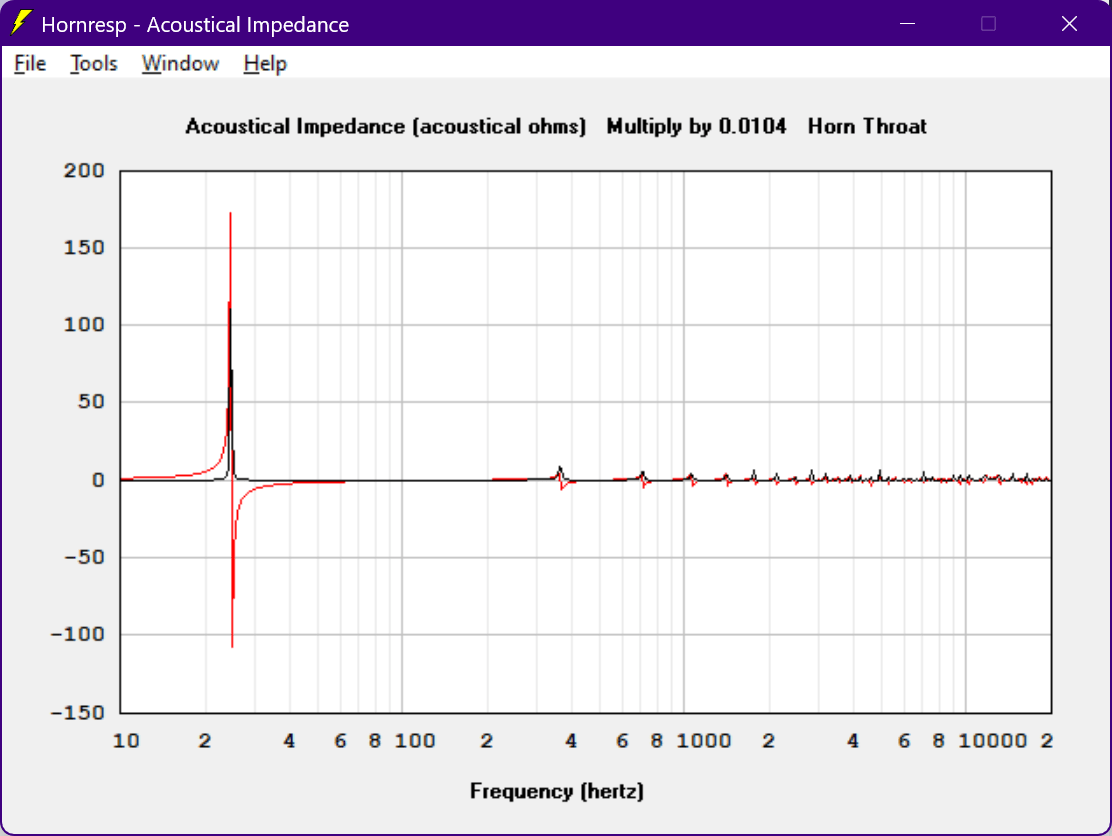

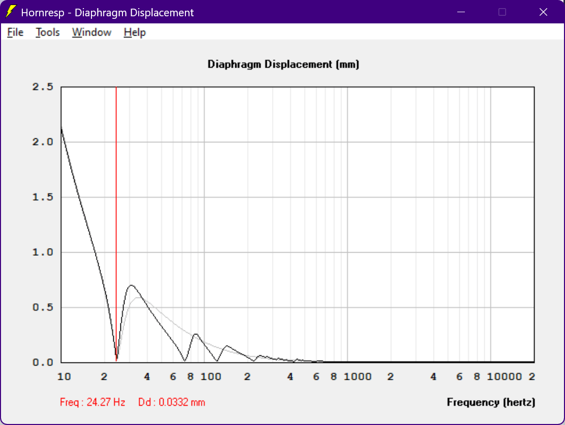

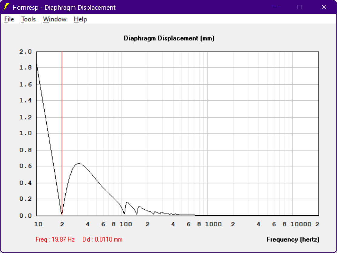

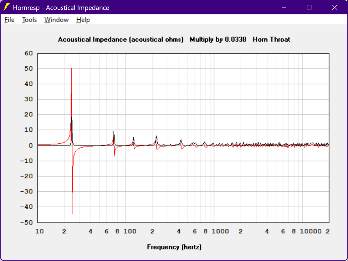

As the Dude states in the thread title and OP, he also wants accuracy in the ≥200Hz range, hence your simulations in posts #28,29,34 & 36 fail to provide for his want, as they all have huge cancellations in the ≥100 range.ODTaperedTL @ 404.916 liters.
Dude wants 20hz, hence longer than 10 foot path.
