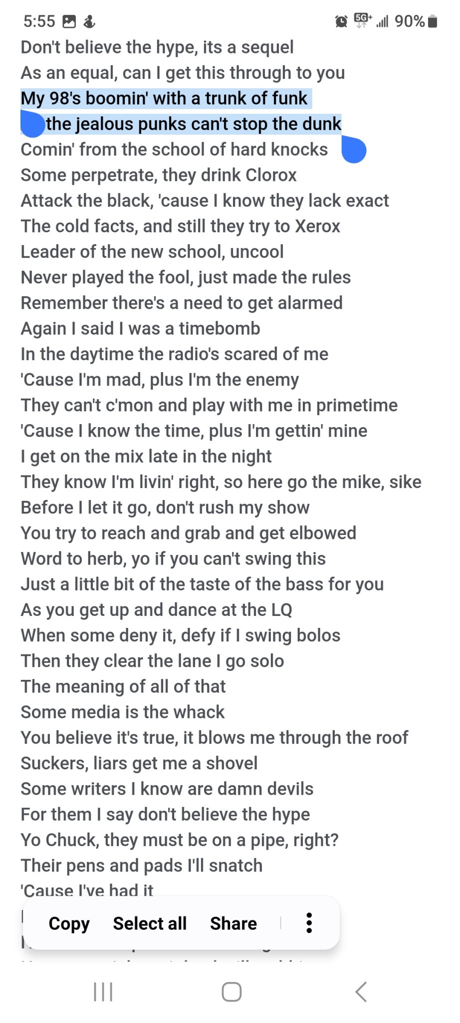

Public Enemy's "Don't Believe The Hype"...
And I see where he got that range from.
https://en.wikipedia.org/wiki/Subwoofer
"The typical frequency range that is covered by a subwoofer is about 20–200 Hz for consumer products,[1] below 100 Hz for professional live sound,[2] and below 80 Hz in THX-certified systems."
He came to a DIY site for a CONSUMER PRODUCT frequency response.
Back in 1982, when Public Enemy started to become popular, 200 Hz was a common crossover point between lower and upper drivers in professional high-output live sound use, before the term "subwoofer" became popular in consumer products.
The term "subwoofer" is derived from the prefix "sub" meaning “underneath or lower”, and has been used in that context since the 1970s, long before wiki existed.
That said, Camplo's use of a high frequency compression driver for frequencies down to ~200Hz does not fit any typical product range..

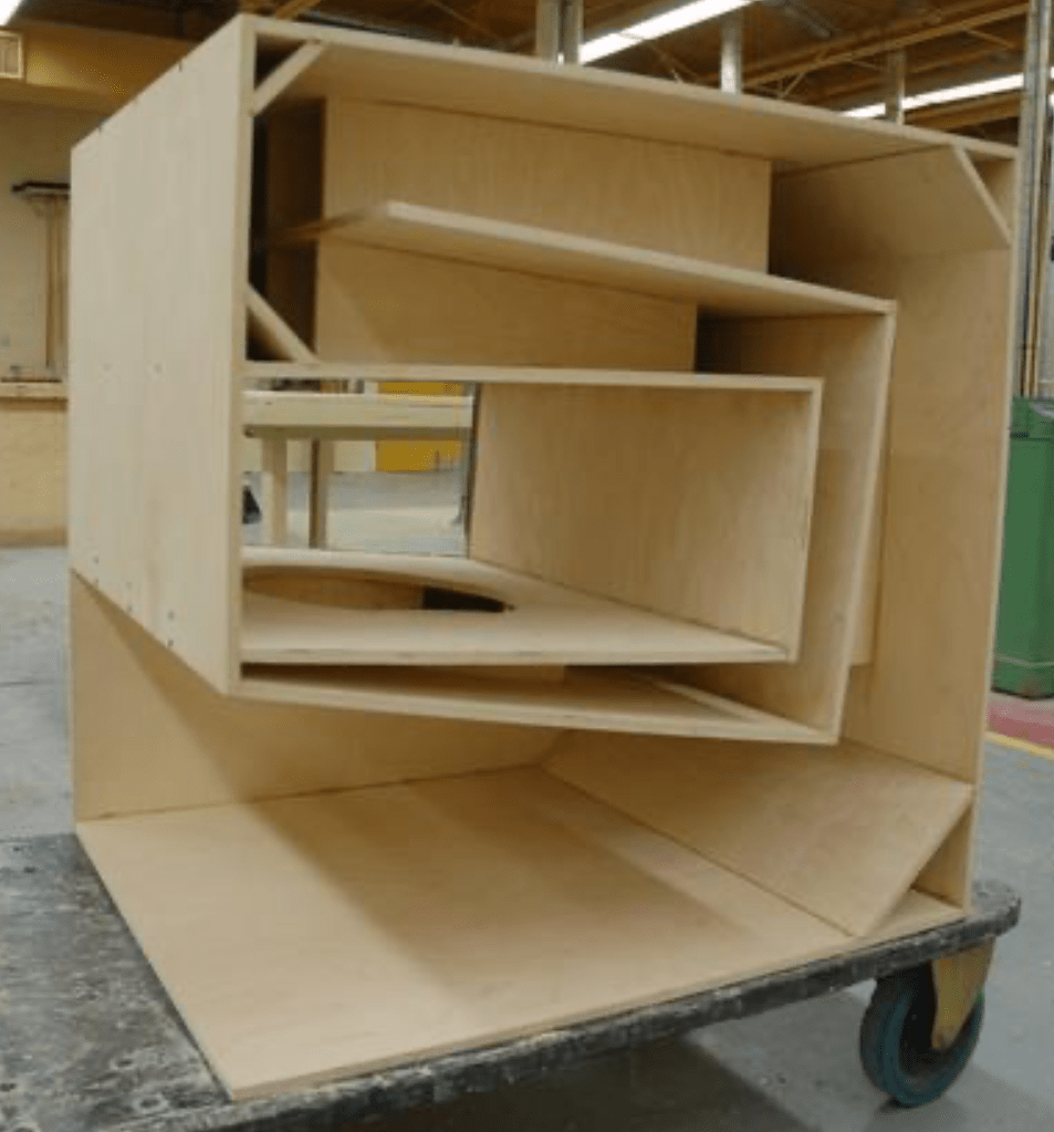

My subwoofer currently Plays 20hz-200hz. Its been a while but I think I tested it with tones once upon a time but I don't remember the results. Dual 18's 14mm xmax, very low Le, in a ~320 liter box. I do remember testing it with music that had a deep bass note at ~30hz with a vocal lower note at ~200hz. I turned it up very loud and listened for the vocal to distort.... It did not. I'm not sure of SQ at the 200hz crossband vs some type of Cinematic explosion with content down to 20hz or lower... but with the subs in Stereo totalling to 4 18"s I am not worried.
I don't know why I keep researching vented enclosures, It seems only an offset BR has a good enough FR to make it up to a 200hz xo. @Booger weldz if you stuff a tapped horn it seems to work out but what I find intriguing about the BR I posted is the undampened smooth response, basically all that efficiency... I don't need it, per say, I just want for some reason lol

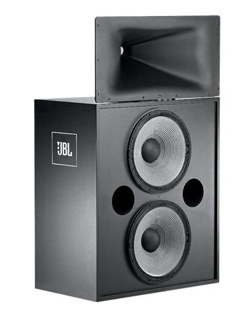

I figured I'd start this thread to see if anything interesting comes a long and to help designers resource solutions for this unique design issue. This type of driver/enslcosure set up is usefull in my opinion, in a design that is a two or 3 way where one is able to cross to such a sub, and then eliminate an additional design to cover sub. Vertically stacked 18's can make it up higher than a 200hz xo, I mean the 4277n is corosed at 600hz. Its just a matter of getting the right drivers and the right amount of drivers etc. The jbl is tuned to 34hz?? but in pairs in a domestic situation it might make it to 20hz? @mitchba might know.
But yeah, its a unique design ask to completely reach 20hz while crossing high but when it works, you eliminate a crossover

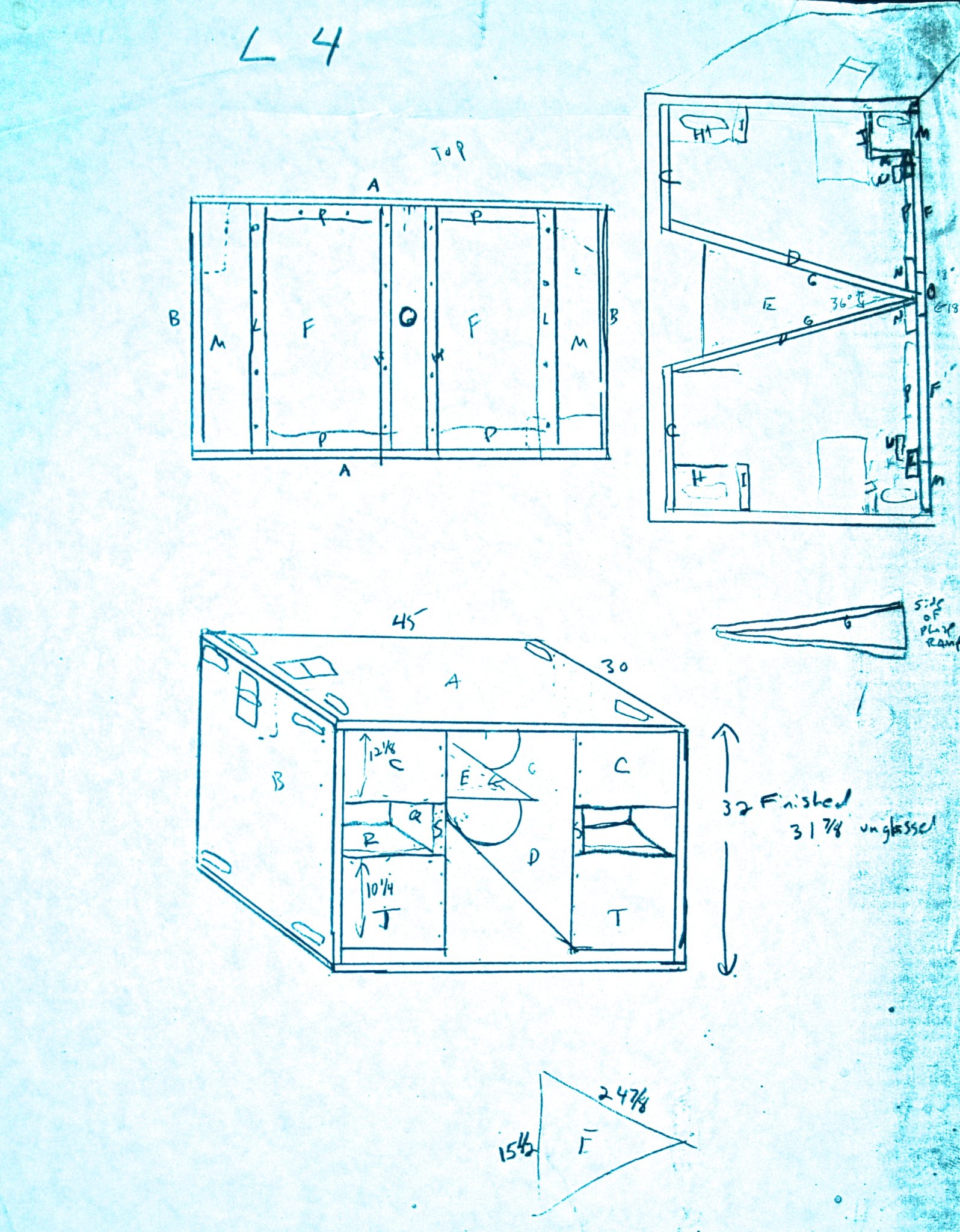

That said, my old quad 15" L4 design worked very well with a 200Hz crossover:

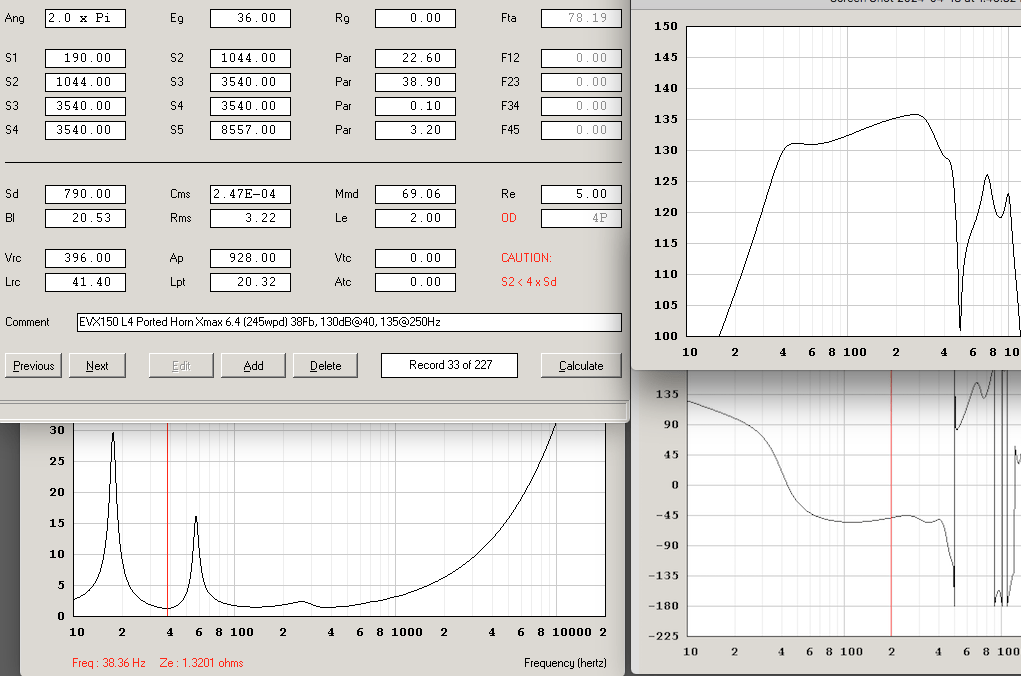

I don't have any surviving measurements, but the Hornresp sim is not far off, using the EVX150 at 6.4mm Xmax.
Current woofers could exceed this level by 6-10dB, though may not sound as good in the upper range:
With a bit of EQ, ~35 Hz response still sounded decent.

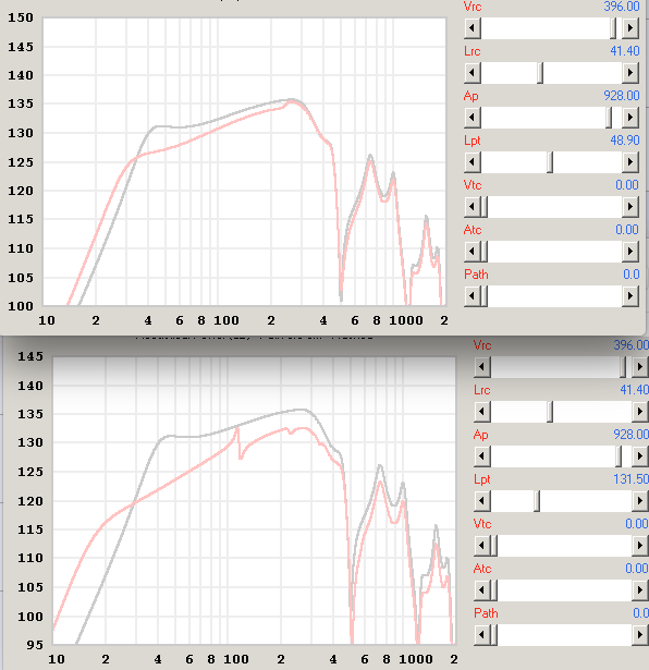

Lowering the Fb to 30 Hz or 20Hz, the L4 with the EVX150 could still make things happen, but not much thump by comparison, and the 20Hz tuning uses less voltage to reach full excursion.
The long 20 Hz ports have a resonance in the 120Hz range, not good, but still above 115 dB with no room gain with a modest 36 volts. The old Crest amps we used had no problem with the impedance minima of only 1.3 ohms with the Beastie Boys, Nine Inch Nails or Prince.

Hi yall, I'm hoping to create a space to talk about subwoofers that reach higher than typically expected, all the while covering down 20hz/30hz without sacrificing the accuracy of its upper passband. Sealed enclosures with multiple large woofers, and high xmax are a good choice. Having pairs of these types of subs only makes things better and being that we are traveling into the realm of localization by playing so high, these types of subs are to be apart of the mains, either by proximity or appendage.
Sealed enclosures as described above make short work of the task... I'd consider something like a large sealed cab, dual 18" with >14mm xmax the status quo. Where it gets interesting is transmission line and bass reflex. Vented Designs need to be a lot more particular. Damping is needed but maybe not in every design. A front loaded horn like the known HT tuba which is an bandpass design where the front horn is entered in offset, may do well thanks to the near 0 CSA at the beginning of the line. Of course it comes with its own sets of pros and cons, the line length creates delay, for example.
I will post some designs that fit the category, and I hope that you guys have some designs that you like as well. There are details that help optimize these types of subs, lets chop it up at our leisure

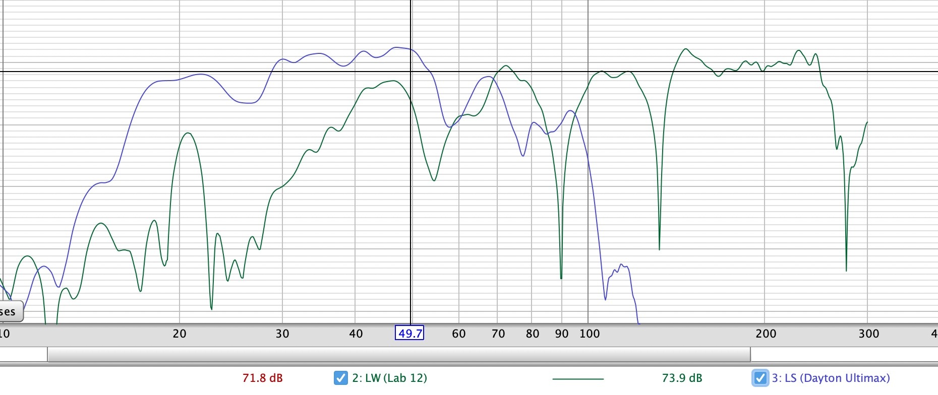

Here are raw measurements of the 2 separate drivers from one of my speakers. The ported sub is ~100 liters and low passed at 100hz, and the sealed sub is ~30 liters (1 cubic foot) and low passed at 250hz. (No smoothing):
Here is the combined result of 2 pairs of these 2 in 1 subs with some DSP. (No smoothing.):
