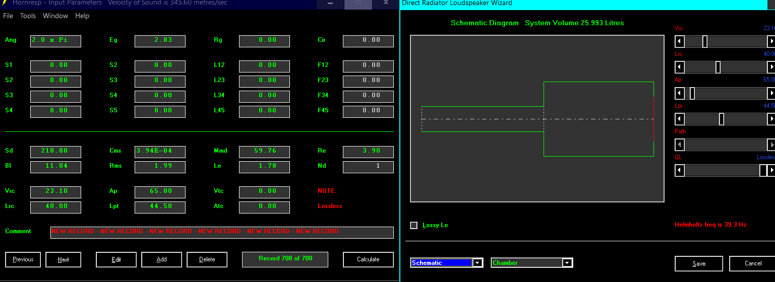

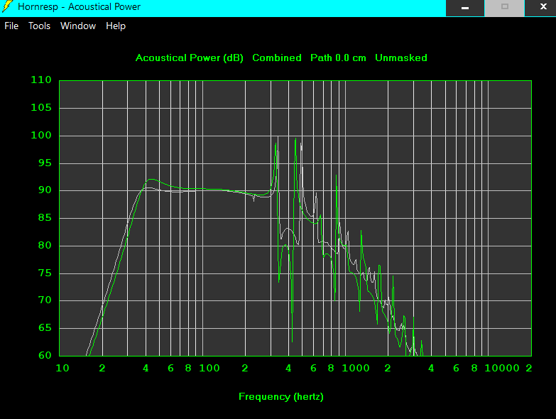

5.5" x 26" - with the rear reflections the directivity must be complex at some point. The PPMSL seeks to mute the rear reflected signal, and hopefully improves the result. I remembered that HR has a simulator, and did my best to sim my Slot from a side view. I seems that anything below the mouth frequency is fair game? I am not sure if I did it right, though, I think each square equals a centimeter.
13550/26= 521.15hz

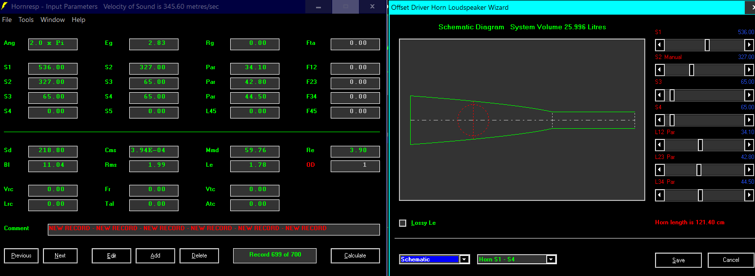

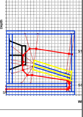

FWIW, modeling a BR enclosure as an offset TL and using that sim to play around with box size and vent dimensions does work, and I've done just that with three builds. The trick is to ensure that you're measuring effective path lengths and segment cross-sectional areas correctly. This does introduce some limitations to the box layout to remove the guesswork.
An example of one such build is my "Boom Unit", at https://www.diysubwoofers.org/projects/home/boomunit/ and
another example is my POC #6, at https://www.diysubwoofers.org/projects/other/POC6/
I do also have a spreadsheet that models a "standard" shelf-vented BR as an offset TL with stepped segments, but I haven't built an enclosure yet to determine how accurate it is.
