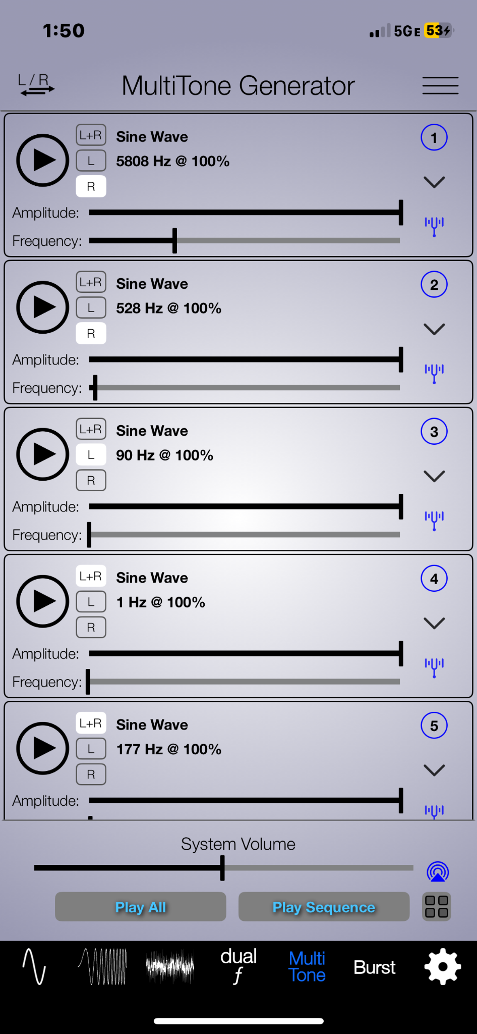

I don’t know what I’m doing, but I sure can create some strange junk with this
Thanks🙏🏻 almost sounds like a strange variety of ‘beat’ frequencies so far apart they just sound ‘rough’?
A beat frequency occurs at the difference in frequency of two tones, the repeating beat (louder sound) between 20 and 210Hz would be 190 cycles per second (too fast to hear), nothing like IMD.
You can hear what IMD (or beat frequencies..) sound like in a single loudspeaker using your sine wave mixer.
@mark100 @BP1Fanatic
Well I respect your thoughts, I have to point out that you are neglecting the details. Taking a driver from 20-200hz is a major task. I use my lowers from 20-200hz but what does that even mean? At what spl level, what was the actual signal content? Playing heavy, low bass, music with a 808 note in the low 30's at high volume, was successful. Not theoretically but judging by my ears. Still doesn't equate to being successful from 20hz-200hz, so this is something that I have yet to achieve. 30hz-200hz check, 20hz-200hz, not yet. If I thought that my one sub passes from 30hz-200hz then when used as intended, in stereo, equating to 4 18"s, passing will turn into.... still passing. I invite you all to experiment. Its as simple as playing a dual tone signal, one at 200hz and one at 20hz, and playing with the volume and/or top frequency. Thats one of the things I did. Once your woofer starts reaching the limits of Xmax don't expect there to not be distortion, thats just silly.

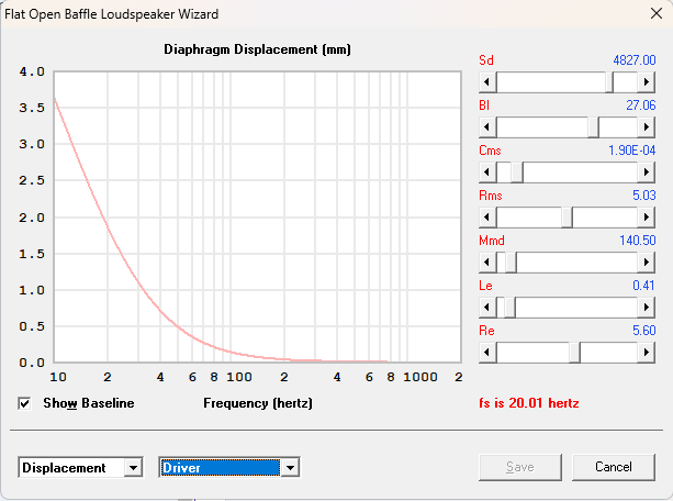

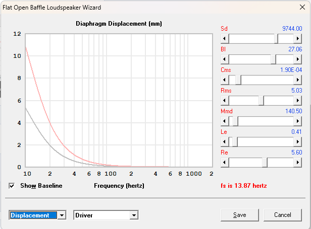

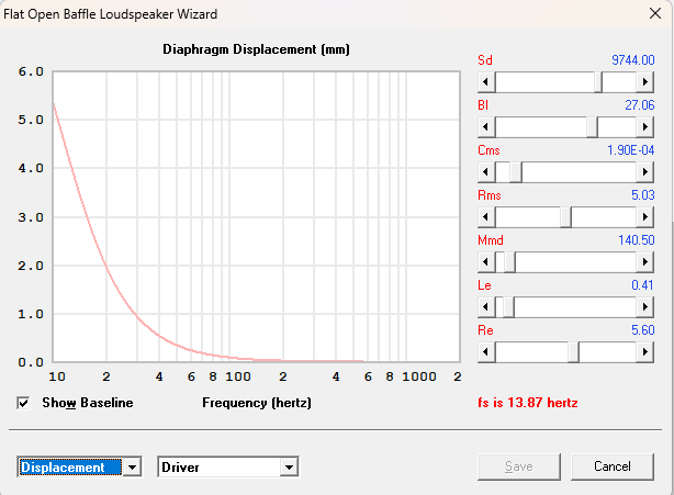

What does this tell us? Remove, excursion, remove the non linear behavior. Reaching down to 20hz while maintaining high accuracy is just a matter of removing excursion, nothing less. If once can produce desired true peak levels at 2mm or less... this idea of IMD/THD is already a nulled issue. Thats all I am saying, unless someone as some other metric to talk about.... within a couple of millimeters of movement, the cone is Dominated by BL and Le and the conditions that lead to THD/IMD are not there. Now its just a matter of headroom, as in, yeah we can cover the whole spectrum if the drivers frequency response, as long as its done so within 2mm of excursion.

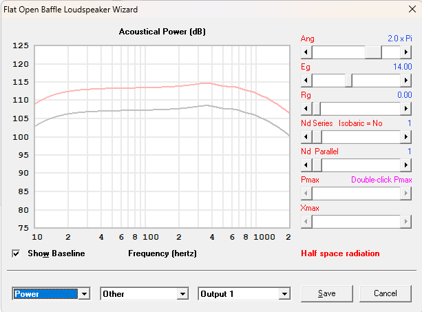

With my 4 18"s, if I limit play back to about 85db rms at one meter. My 18's can cover 20hz to its upper roll off, no problem.
or 8 - 18's for ~91db rms.
This might be shy some, but for another, this might be plenty. More Music and a 30hz roll off, things get more serious
Still, I am being very conservative on excursion because honestly, how bad will distortion be at 4mm on a driver with 14mm xmax? My point is, its a numbers game, theres no need for guessing. Within 2mm excursion, As long as you have high BL and low Le, 20hz to whatever the drivers FHM is, should be fine.

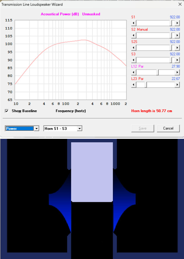

I can only comment on regular slot loaded designs as I know them....like the PPSL I posted years back and used up until my new V twin.
I do not know exactly what you are doing, and can't muster the curiosity to look into it. Because I'm convinced there are only 3 types of subs I want to devote time/interest in....sealed, reflex, and FLH (which I view as sealed with a horn attached). Can't see the need for others.
Slot loaded is simply an opposed driver arrangement for use with any of those 3 types....and again, a pain in the butt, but a blessing for vibration reduction when cranking (part of the max linear SPL equation).

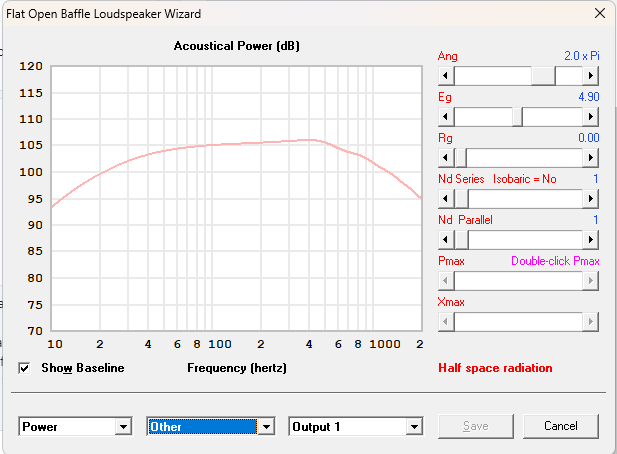

What I don't like about your Acoustic Power sim above, is the degree of low end roll-off.
Appox 89dB at 25 Hz doesn't look that good to me, as I know it will limit linear SPL as I turn it up.
Upper end response looks fine.

He definitely meant that literally as it was written, with regards to, passive anything. He did not encourage bass reflex/TL nor resonant waveguides known has horns. In regards to the slot he said it would just complicate things, and even though we did not talk much about the slots directivity, he wasn't wrong. Hornresp doesn't even attempt to figure directivity of the offset horn of the shortest variety that is PPSL and what I see in the ripple tank has me wondering whats really going on.... anyone know how to make sense of the frequency spec on the ripple tank simulator?
Regarding the slot, the proposed PPMSL version removes the low pass or at least most of it. With some development I see the potential to fix potential vertical off axis issues.
You are interested in increasing headroom, and so am I. @weltersys How come you are schooling me on PPSL directivity, I know you know and do you know how to decipher the ripple tank simulator?
