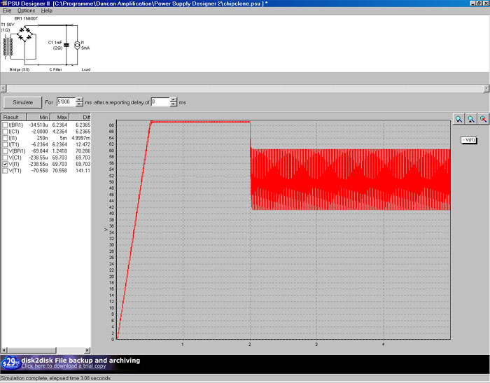

after all I was reading about your regulated amps, I was thinking alot about this topic and I am sure, I have to try it.
I believe in this concept, after playing a little bit with duncans amp tools, the psu-simulator.
Just use 50 V trafo 1R, a 2000uF cap after the rectifier and put at the end a stepped current load. Define the step from some mA up to 2-3A after 2 seconds. I know, the trafo is not correct, as it has no center tap.
Then simulate and look what happens with V(I1), specially the transient.
It is not a big difference, weather you use 10000uF Caps or 2000uF.
It is even not a big difference, when you use a "stronger" trafo (lower R).
Regulation must be the way! Maybe not for the famous first watt, but I will try it soon.
What regulators to use, with no separate secondaries, with a single center tap?
Franz

The attachment shows a hardcopy of a simulation with 1000uF
