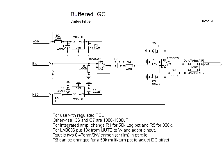

Using 78/7915 is more healthy for the OPA627s as +/- 18 V is their *absolute* maximum supply voltage. Using a diode per side ( in series ) after the 78/7918 to drop voltage with 0.6 V works just as good. Always check/measure 78/79Lxx as they deviate from the specified voltage more than they should with some brands. I would not operate the opamps for a longer time at ( or just above ) their absolute maximum ratings to avoid my woofers having severe headaches 😉
When taking the bandwidth of OPA627 into consideration it is very wise to use a RC filter at its input. A 1k5 series resistor followed by 1 nF styro/MKP to ground ( all this between the 100 k resistor and the chip ) normally will do. I always use input filters in amps, the need for them is only becoming bigger with todays RF pollution ( GSM etc. ).
carlosfm said:Version 2.0 of the BIGC schematic, with some "minor" 😱 bugs corrected.😀
That crap ExpressSCH has wrong pinouts on these regulators.😱
Bob, the schematic you made is fine now😎 , and has better image resolution than mine.![]()
I have to resize this to post here, and it looses resolution.
Here it is.

Re: Re: Weekend update
Never had problems with that.
Anyway, most of the times the voltage you get out of these regs is a little below 18v, sometimes 17.5.
But, of course, the 7815/7915 will be fine too.
jean-paul said:Using 78/7915 is more healthy for the OPA627s as +/- 18 V is their absolute maximum supply voltage. Using a diode per side ( in series ) after the 78/7918 to drop voltage with 0.6 V works just as good.

Just text modification
😎Bob, please can you do me a favour?
On your schematic, add this comment:
"R6 can be changed for a 50k multi-turn pot to adjust DC offset".

Originally posted by carlosfm
Thanks Bob!
You are more than welcome carlosfm. 😎
I'm very pleased with your contribution on this forum.🙂
What you think about this:
You are ok to include this for Rev_4 or to stay with Rev_3 at the moment?😎
