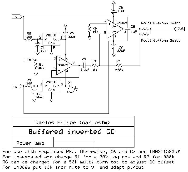

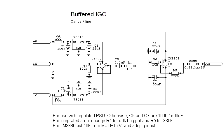

High-End Regulated Buffered Inverted GC
Carlosfm BIGC
Just to make it more clear 😎
Wire directly across the 338 input to gnd a poly-something bypass cap, .47uF. Place before this your 4700uF to 10,000uF supply reseviour caps, keep them as close as possible to the regulator,
Neal, if I have my 10,000 uF's within two inches of the LM338's, can I put this 0.47 uF bypass cap across the lugs of the 10,000 uF's (instead of on the regulator PCB)?
if you are going to regulate the OPA627
why not use a decent low-noise regulator pair like the LT1763/LT1964 from Linear if you are going to regulate the OPA627 input buffer? These are much quieter than the 78LXX 79LXX series, you can use smaller output capacitors, like 1nF instead of 20uF which is shown in your schematic. I have used them (the Linear tech regulators) as post-regulators in my small switching supplies and they work very well indeed.
tbla said:
if you use adj regs for the opa627 you will become closer to heaven.......😉
Actually my OPA627s are on the LM3886 PCB, near the chip.
As the PSU that connects to the PCB is regulatd with adjustable regs (LM338), what I have here now is double regulation for the OPA627s.😎
Anyway, you can use fixed or adj. regulators here, the voltage has to go down from around +/- 30v to +/-15~18v.
I don't feel there's much advantage in using separate trafo/psu for the buffer.

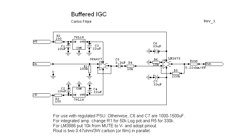

Re: Carlosfm BIGC_rev1
Bob03 said:
Let's make it clear: 0.22/5~6watt should be ok, as long as you don't use bobinated resistors.
I had better results going a little higher.
So, at the time, my 2*5m runs of Kimber 4TC started to really sing with the GC with 2//0.47 ohms, carbon 3w resistors (this gives 6 watts total, I wouldn't use lower than 4~5 watts).
You can't get a single resistor with that 0.235 ohm value, unfortunately...:bawling:

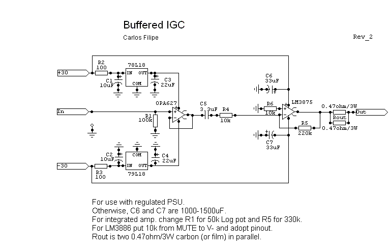

Carlosfm BIGC Rev_2
Just a correction: Rout is two 0.47ohm/3w carbon (or film) in parallel. That makes 0.235ohms, 6 watts. This is the ideal value after many tests, the amp this way is much less picky with cables, use what you want.
Works better than zobels.

Weekend update
Version 2.0 of the BIGC schematic, with some "minor" 😱 bugs corrected.😀
That crap ExpressSCH has wrong pinouts on these regulators.😱
Bob, the schematic you made is fine now😎 , and has better image resolution than mine.:bawling:
I have to resize this to post here, and it looses resolution.
Here it is.
