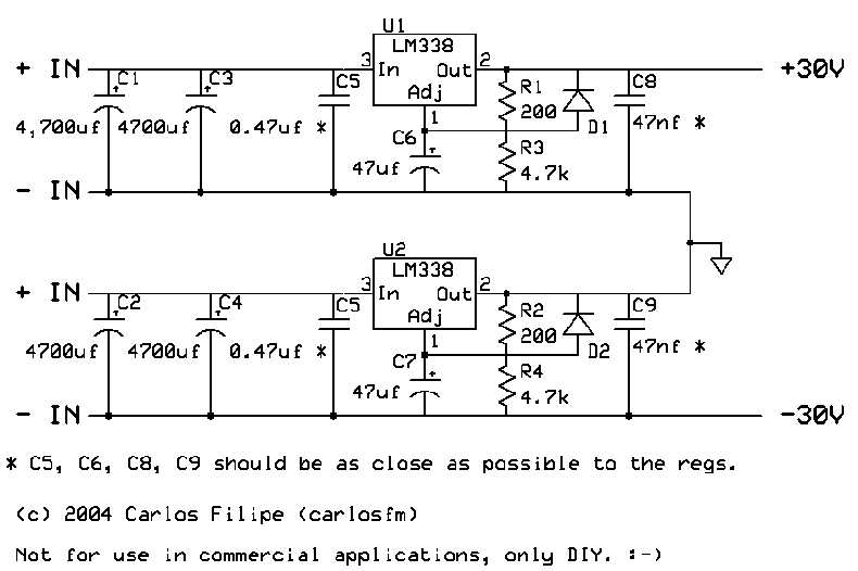

LM338 Regulated PSU schematic
I made this quick, no time to put the trafo and PSU diodes.:clown:
This PSU, with these component values, is what gave me the best results with the GC.
On the LM3886, LM3875, whatever, replace the 1000 or 1500uf PSU caps for something between 33 and 100uf.
Good luck!

Re: LM338 Regulated PSU schematic
Good luck!
Carlos,
Thanks for creating and posting the schematic. It is very helpful in trying to follow your work.
I know you stated elsewhere that you consciously did not use a diode from pin 2 to 3 on the regulator as Predja does on his implementation. Did you think it was just not necessary or did you try it and think it affected the sound.
I will probably implement it for reliability reasons unless there is a truly noticeable sound difference. The GC I will implement it with will be going to a family member (building it with my son) and it will be physically out of my control at some point.
Thanks for communicating your implementation.

The circuit is more-or-less the same as that posted by Carlos (The Potuguese Man-of-War 😀 ) ) except for the resistor values which are 120R and 2K4 in my case to give the 26.3 volts output. I have 10000 uF ahead of the regulator circuits and 0.33 uF on the outputs. I also use both protection diodes.

If you have little voltage difference between input and output, say around 5 volts, that should cause no problems.
Anyway, if you ask me, I would use a bigger one.
I buy old CPU coolers at Cash Convertes for 0.5 Euros, and that's what I used here.:clown:
Good luck Nuuk, I dunno what may be your problem, strange...
Relax, check the circuit again after football, maby you'll find the problem.😀
Someone has asked me about the other protection diode, I don't use it because I think it is not need, but you may use it, extra protection makes no harm.
With a big cap on the Adj pin, like I use (47uf) the diode from Adf to Out is needed.
