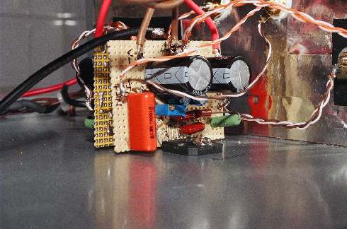

Meanwhile, look at this pic of a module of my GC, done MY way.
Hey Carlos!!
Your caps are further from the chip than mines!!!:clown:

Raka said:
Hey Carlos!!
Look again.
I have 1000uf, then 6.8uf, then 0.1uf from + to ground, - to ground and from + to -.
I'm not doing anything new, this is common op-amp practice, always with good results.😉

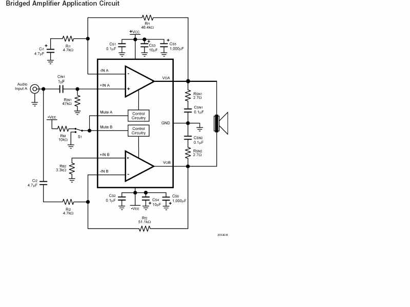

Yesterday I downloaded the LM4780 datasheet and look at what they recommend for bypassing.:clown:
