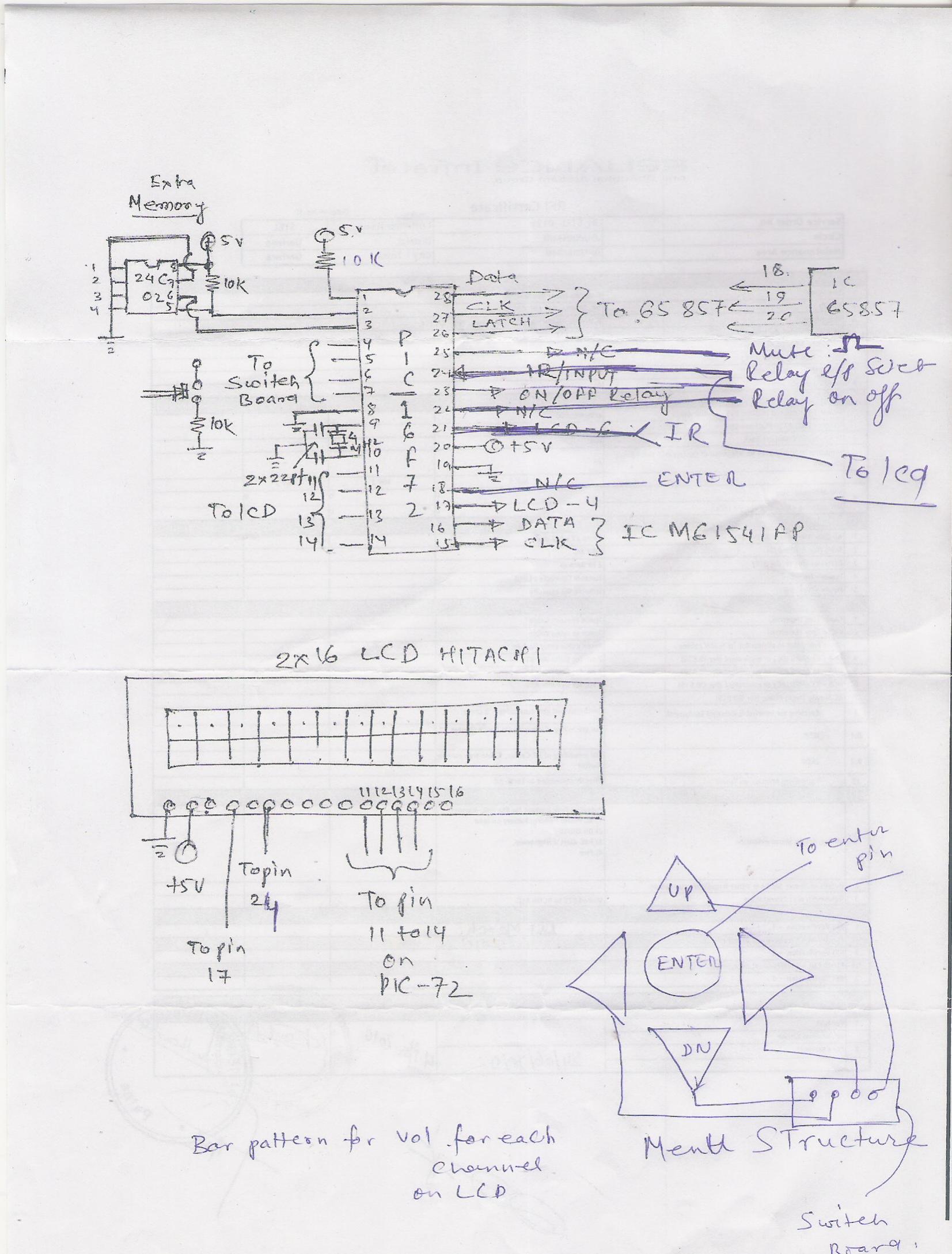

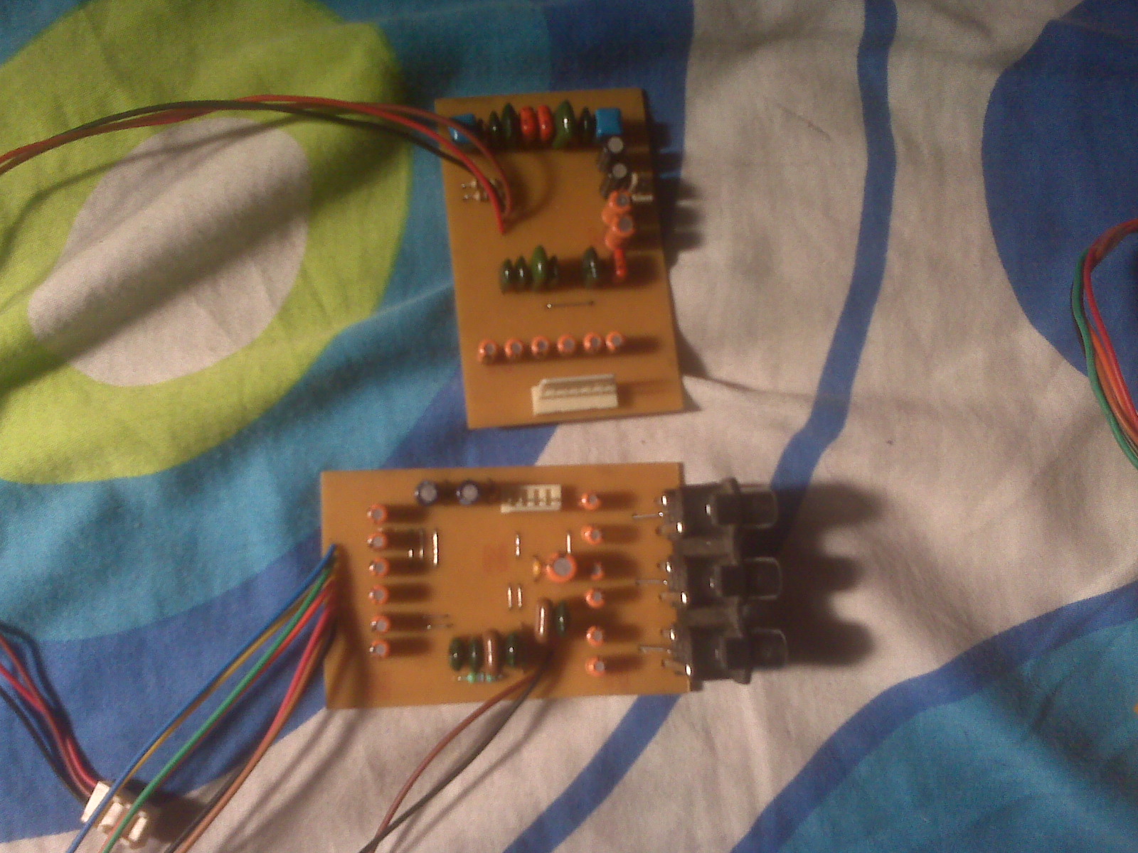

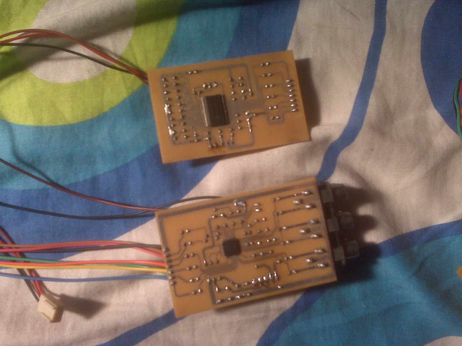

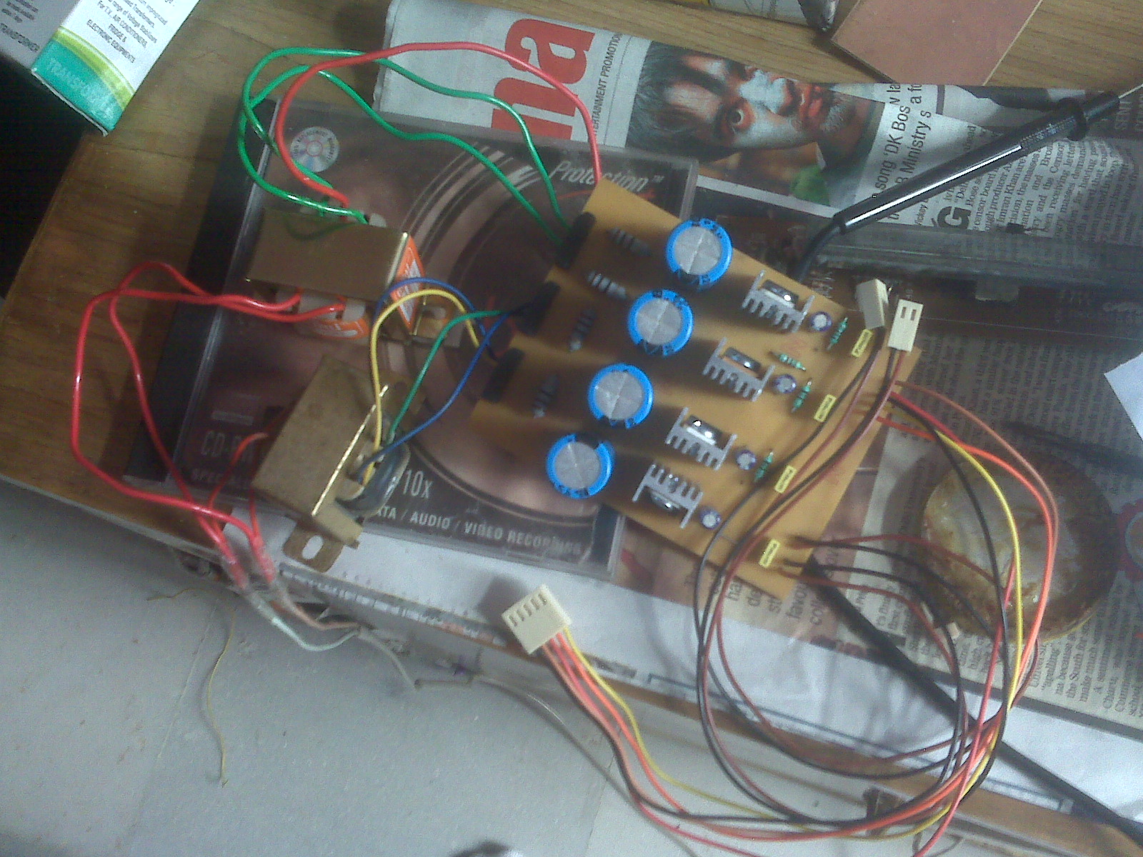

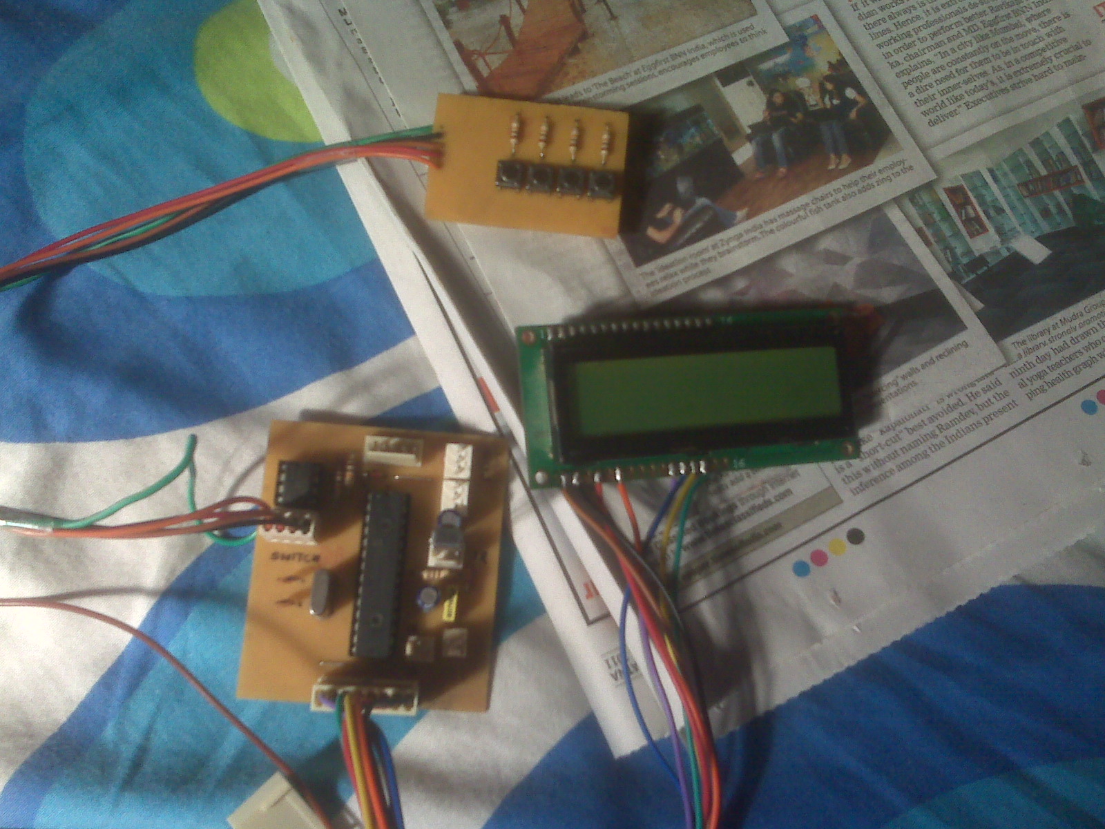

Hi please find find the phtographs of my completed boards.
It consists of Q surround board, PIC board with extra memory,IR & switch,6 channel volume control board,Power supply board.
I will be back with working source code & hex shortly.
