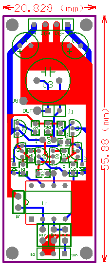

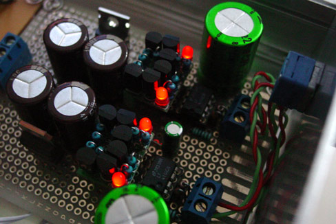

I am planing a HDAM structure.
for mcu,It will be a couple of board design for 8051 or MAXIM.
for the output buffer,I will try AD815.and I have a solid based buffer design,I have finished the archetype test lately.
photo attached
digi01, do you think you need an additional buffer when using the ad815? It supplies a max of 500mA right from the chip.
