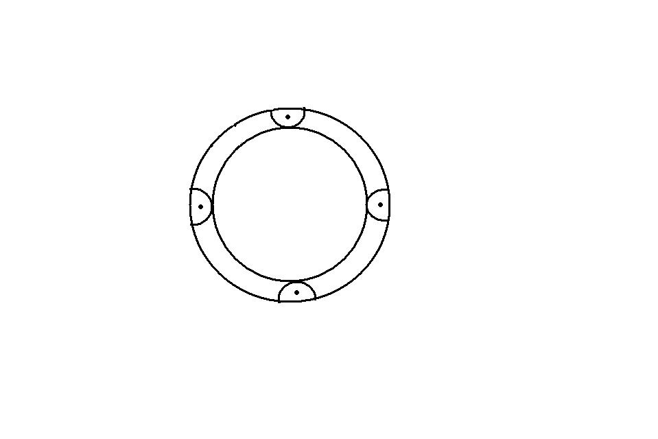

planet10 said:
Don't forget to relieve the back of the driver cut-outs for better air flow.
dave
Good idea but I am afraid the hammer nuts I use won't fit then.
Just mark the screwholes carefully, and leave the exstra needed wood around them
Anyway, routing the back does more good than the hammer nuts...even a relatively small rounding will help 😉
dave
Now I hope your pleased with the made cut out.
:clown:
I also removed the little plate by bending them back.
Thanks for the tip Planet10.
