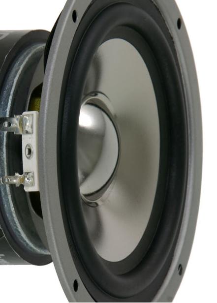

Due time and searching for the perfect price performance drivers made me choose for mivoc. High-end quality for bottom prices.
The mivoc wtp138. With a very spacial cone. A sandwich polypropylene Titanium cone with high internal damping. See the enormous magnet and pole ventilation. 😎
Nice flat response
I really like this driver.
Nice flat response

Don't they look great the titanium polypropylene cone drivers. They also have a immense power reserve. They are 70W rms each so 140W in the application. This means low power compression en 1 octave filtering without a problem.
