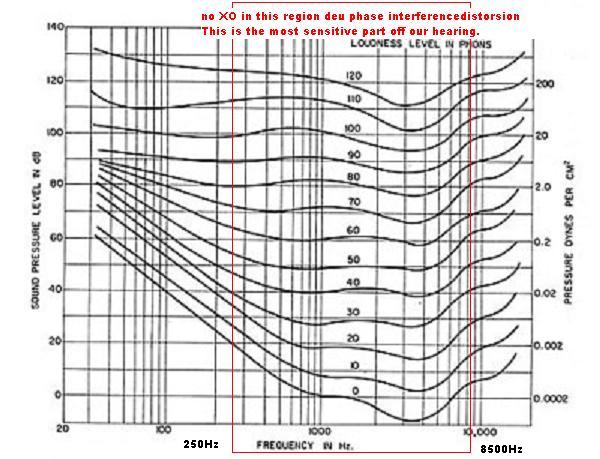

I don't want to filter at 2500Hz. Phase fault, sound pressure level variation interference distortion. And that all in the part where the ears are the most sensitive.:hot:
I will filter in a aria were the sensitivity of our ear has reduced largely.
Here the figure of our hearing. And I have marked the aria where I don't want to filter.:whazzat:
That is why it is very important to find a High quality midrange driver because this aria is our ear the most sensitive.
So the midrange driver makes or brakes the response of your system IMO.
Regards Helmuth

Thankyou for the propouse, i will make balance, active crossover and amplifier (lm3886) myself
