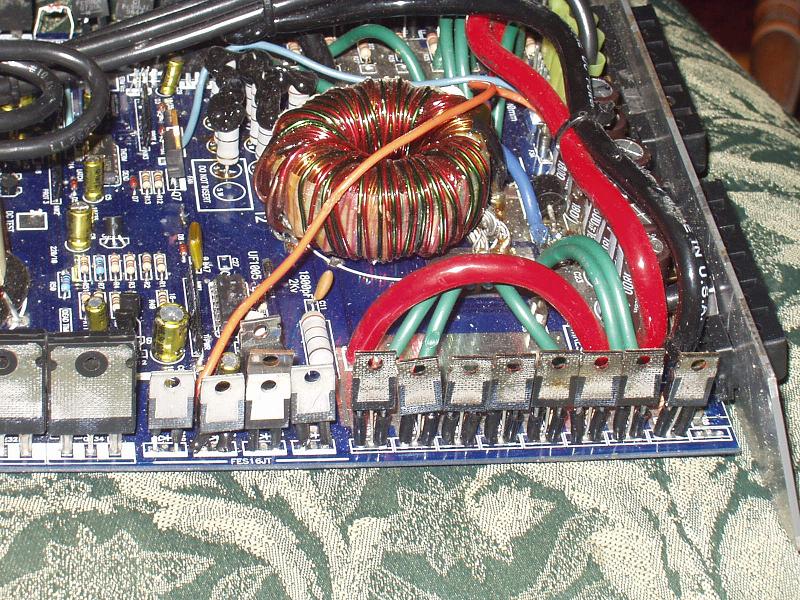

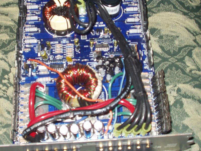

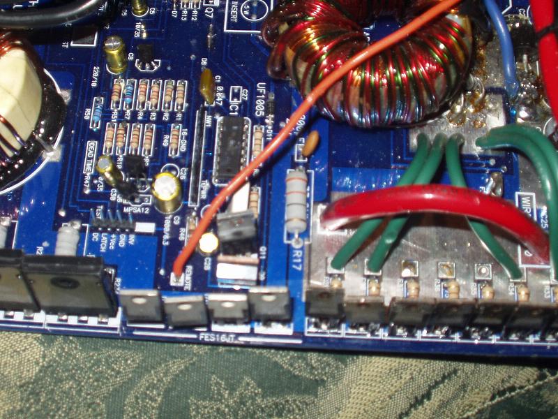

ok heres some pics
Ok replaced the power supply fets with IRFZ44n's Orginals were BUZ102's.
I also replaced all the rectifiers in the amp FES16JT's. Checked the gate resistors and the drivers all seem to test fine.
Amp draws excessive current . So i pulled the rectifiers but with them being out of circuit the amp wont power on or even attempt to.
So I checked the outputs and all seem fine. So im going to put the rectifiers back in the amp.
Wondering what i need to check since it draws excessive current?
The reason im asking is because with the old power supply fets in the amp it still powerd on just went into protection mode since a few of them were shorted and didnt draw excessive current
