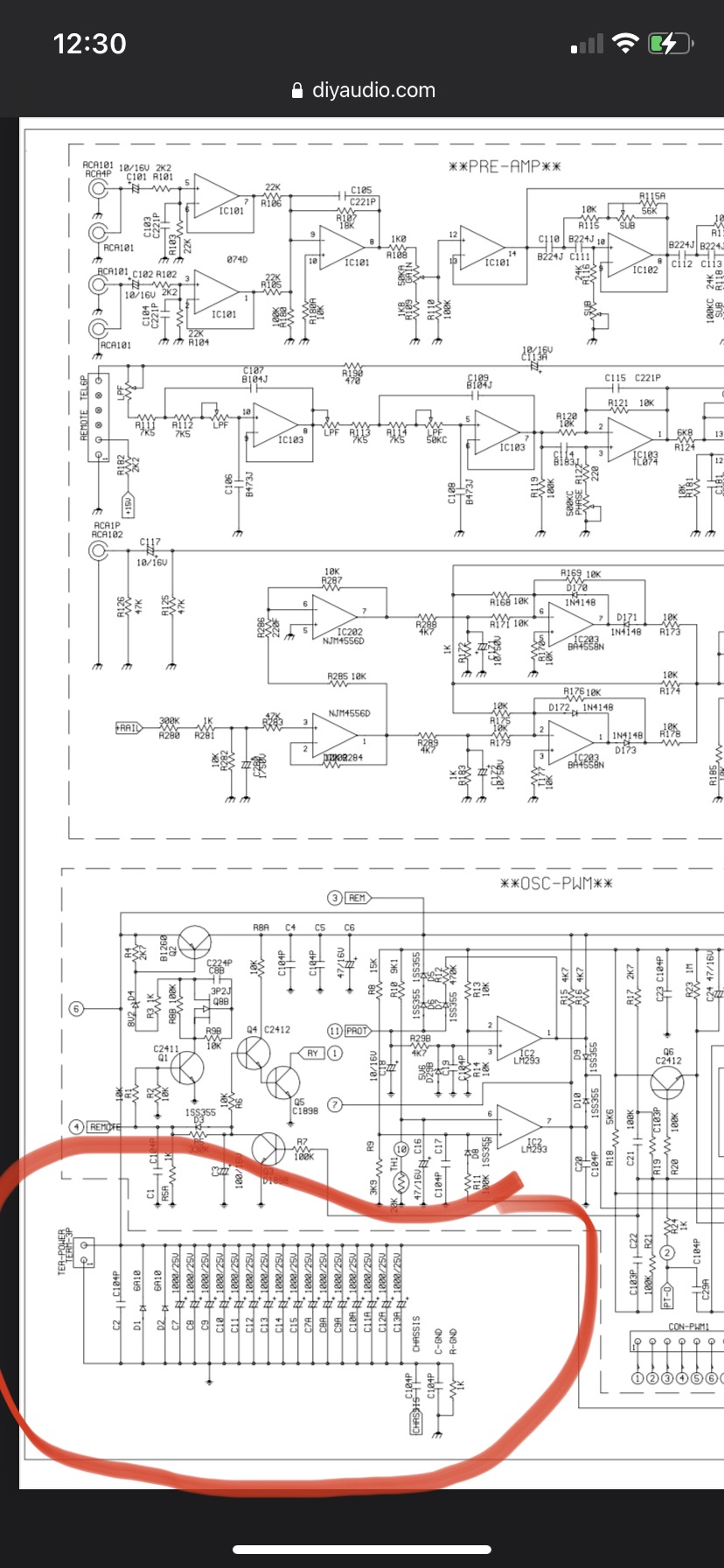

I spoke with Sam from Barevids about it this issue. He had me check if there was any dc on the speaker terminals. It was present on both pos and neg speaker terminals. He suggested I run a jumper between the neg battery terminal and ground. That seems to have solved the issue. Obviously there is some component or trace that has gone open somewhere but i havent been able to locate it so this seemed like a good solution since its my personal amp. If anyone happens to find the fault since it appears to be a common issue, please let me know but for now connecting the audio and main ground seem to be working g fine.I am currently stress testing it in my vehicle. Been about a week now of at least an hour each day. So far so good. I will update if anything changes.
Hope this helps with the diagram that was posted here’s where they are
