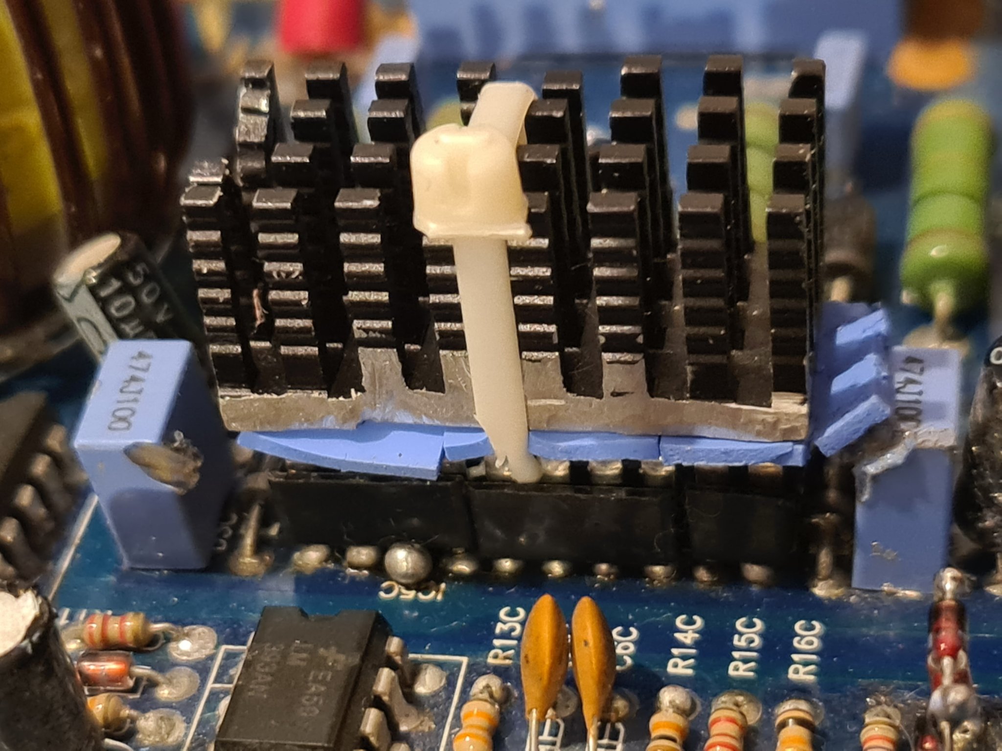

Hifonics BXI1606D
The output fets did not got damaged, only the hip4080 fail , so i installed a heatsink
What do you think, can this help to help the cool the chip? Between the IC and the heatsink i installed thermal pad.
Regards!

The ICs don't have a high failure rate when the outputs don't fail. I worked on a LOT of these amps and saw very few failures unless the outputs failed. I've never seen any manufacturer use a heatsink on this IC.
The mass/weight of the heatsink could cause the IC to pull out of the heatsink when subjected to vibration (and gravity). If this doesn't happen, the heatsink won't do any harm.
