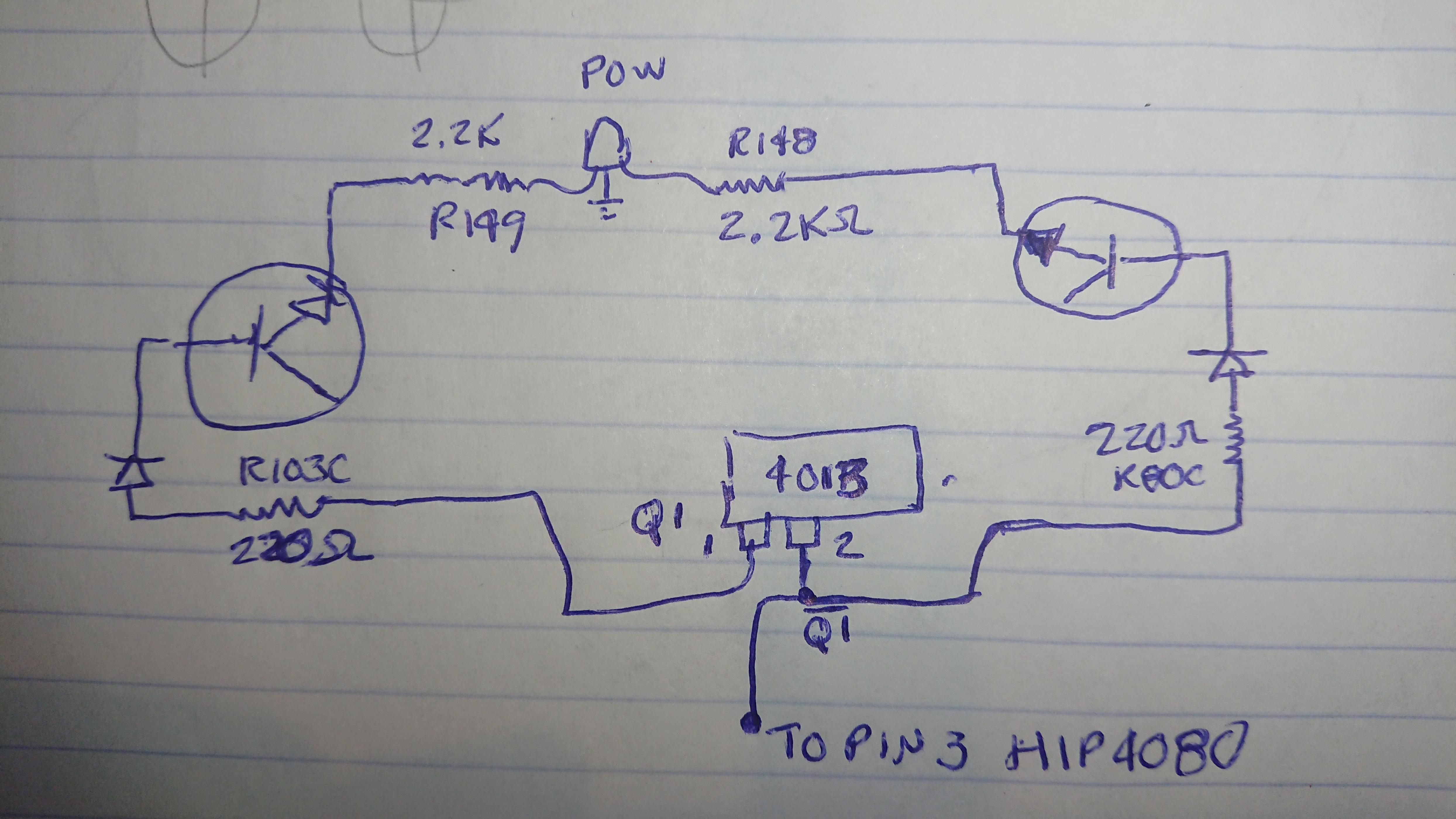

i know pin 3 shoul be near to 0 volts tfor the hip4080 to operati and my pin 3 is high
cuold ths high condition caused by the pin 2 of the 4013?

Green. (Just after the startup protection process end the red led turns off (protection 2 pin led) , and the three pin led turn on green, a few mili seconds after the green led turns on , the speaker relay turns on.)
No. after the red leds turns off, the green led start blinking and it is blinking two or three times while this happen the voltage increase from cero to about four volts then to about 9 Volts and finally when the led stop blinking and stays green the voltage is 12volts.
Not always the green led blinks sometimes goes being off (two pin red led on) to solid green, most of the times this ocurs when I connect again the remote a few seconds between conecting and disconecting remote to 12 volts
Ok if if start at 12 volts I was not able to detect it, the multimeter value varies to much, I think then that the chip tríes to go to zero volts and return to 12 volts.
If the pin 3 start a12 volts, then something mut send it to ground to operate?, or in the startup process is the chip do not detect problems it goes to cero automática lily?
I mean the hip8040 dependes of an external circuit to have 0volts in pin 3?

My question was, the pin 3 outputs12 volts when the chip detects a problem??? I understan 12 volts presnt in pi. 3 indicates a problem but.
I wonder if a signal inputs that 12 volts, and the amp must send to ground the pin to operate normally? So the
One of the two condition is correct, I do not know what it is, maybe the 12volts in pin 3 indicate protection, and the only way to achieve 0 volts in pin 3 is correcting another audio stage problem, can you confirm this?
Because the other option I was tinkhing is that some protection signal send to ground to pin 3.(chip internally or not?)

What is the DC voltage on pins 1 and 2 of the 4013 when the 3-pin LED is green?
4013:
Pin 1 0 volts dc
Pin2. 12.9 volts dc

Yes, I think so, that I was tryng to ask in my previous posts, but my bad english did not let me explain my self correctly.
There is a path line from pin 2 of the 4013 to pin 3 of the hip4080. 0 ohms between pin 2 (4013). And pin 3(hip4080).

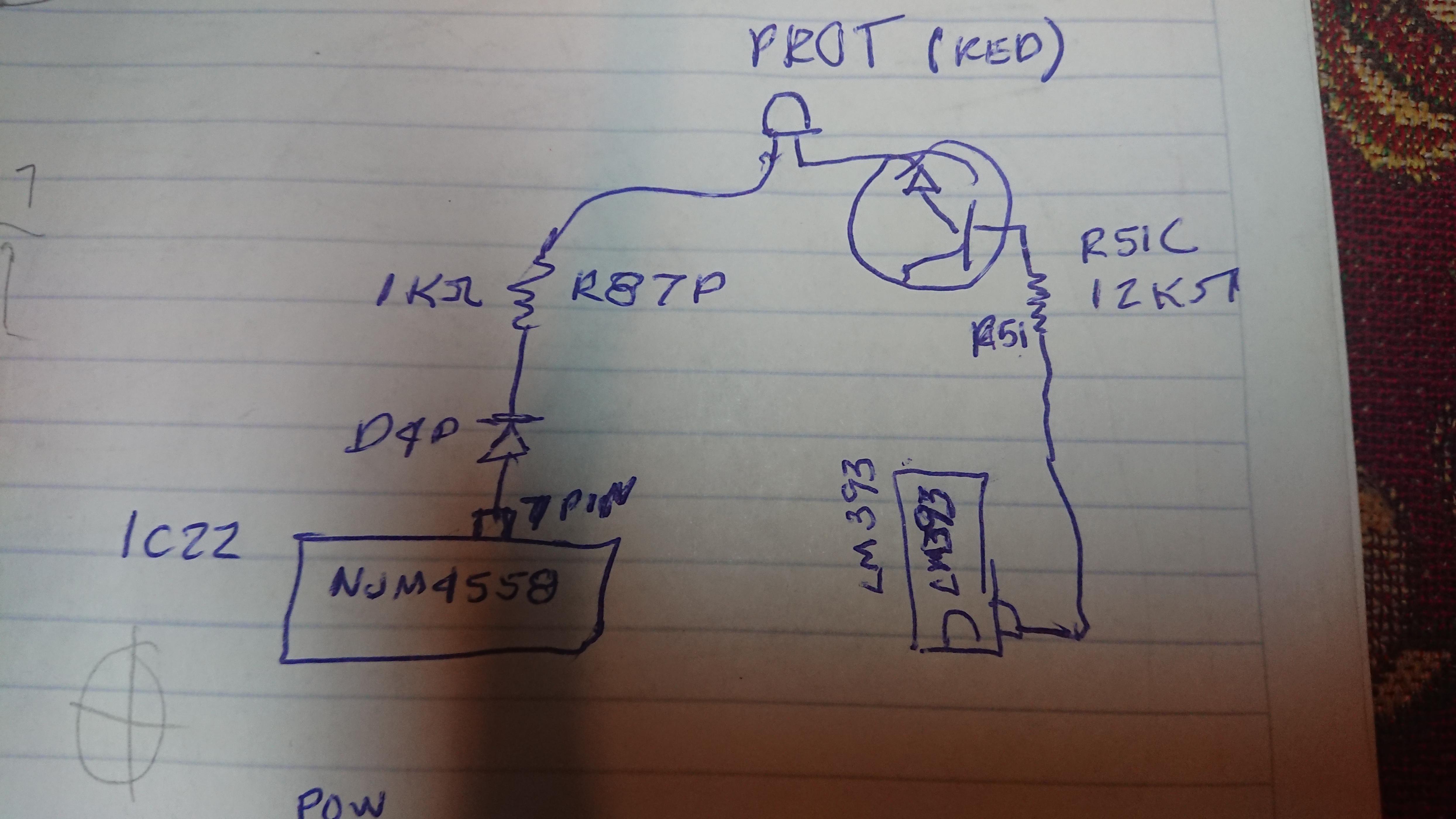

It is a bit different in this amp the prot LED is not control led by the 4013. The 3pin led is controlled totally by 4013
I attached a picture so you can see,
Thank you
