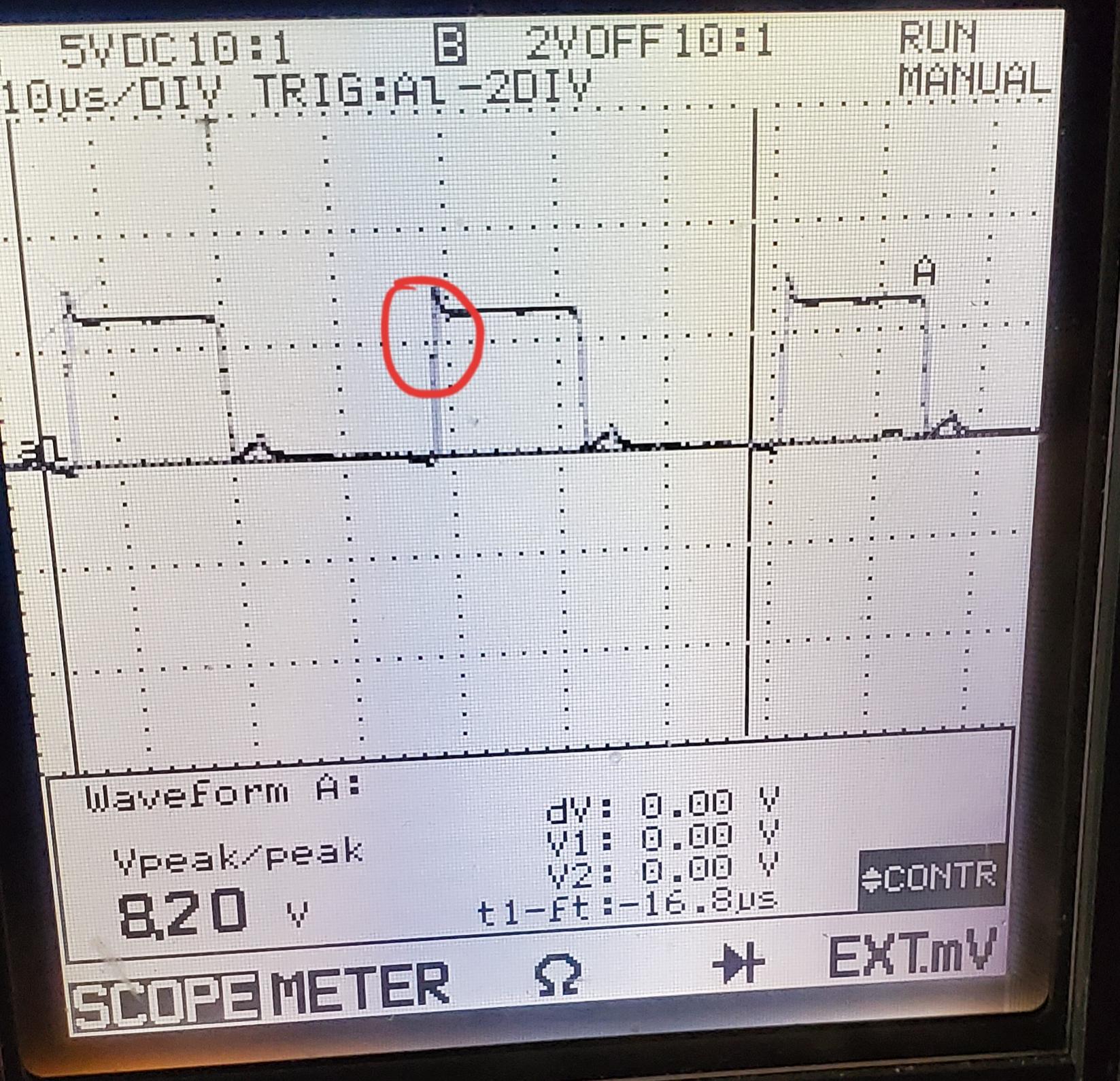

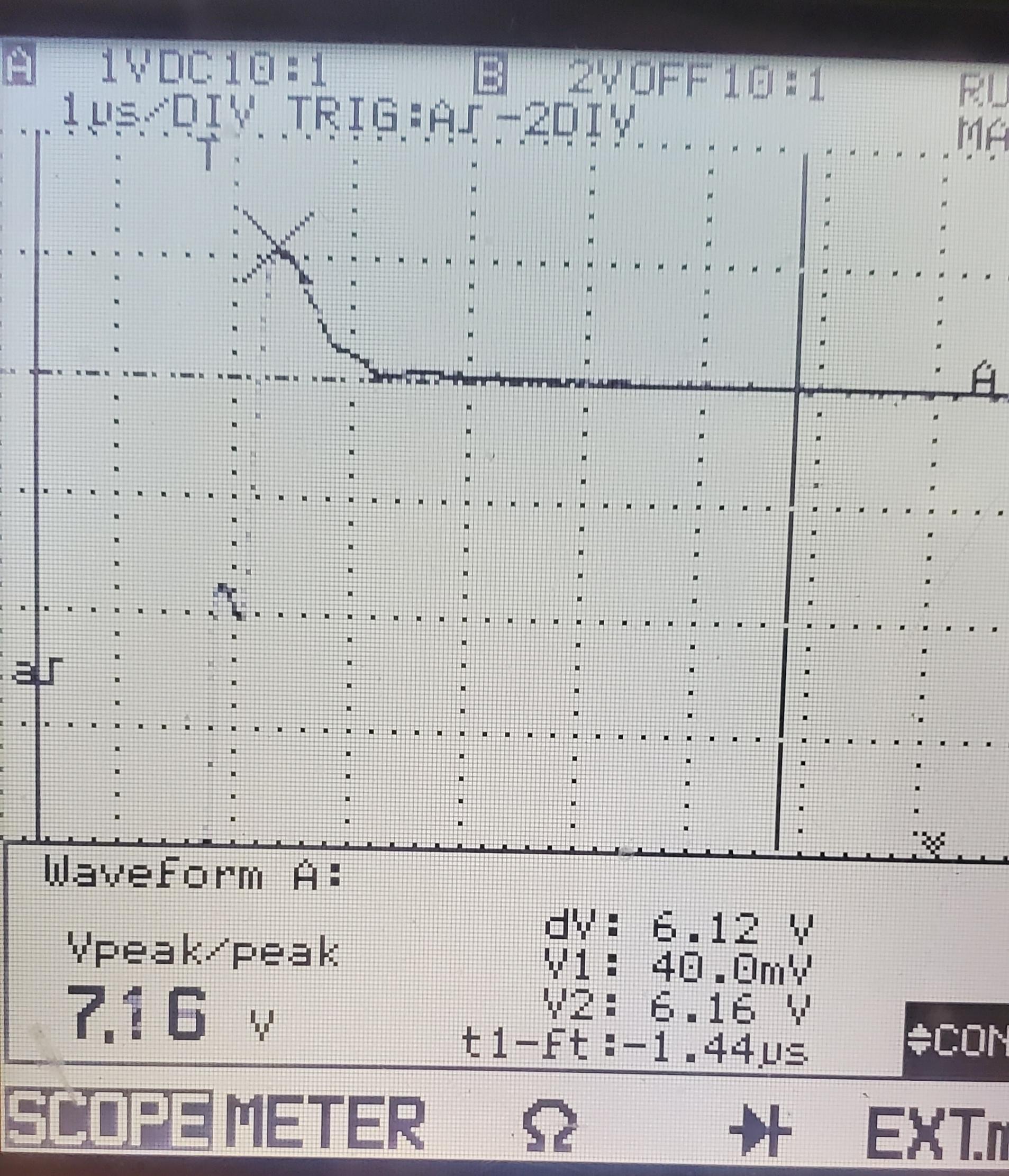

I adjusted r60 / r61 to 100ohms. Is the notch circled in red of any concern? I think this is the part of the waveform from the NPN pulling the signal up?
Taken from the irfp3206.

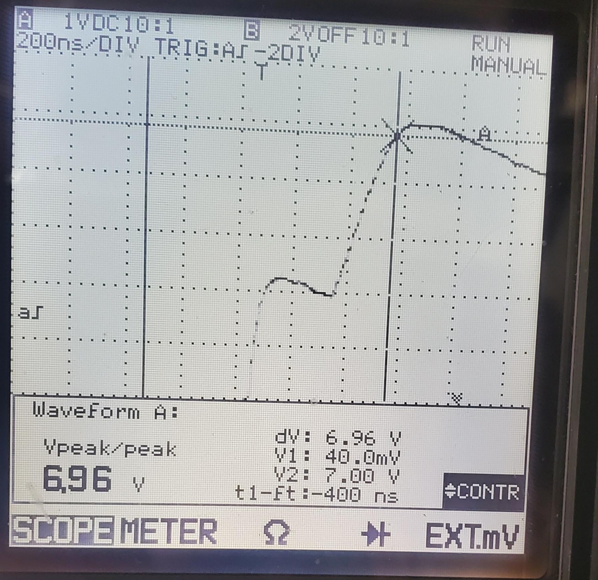

The LCD display makes it hard to see what that area really is. Adjust the timebase and vertical amplifier settings to make the red area fill the entire display.
That drive is still weak.
I think the glitch is where the FET switches on.
I think that the amp will not be reliable with such low drive amplitude.

Bypass the R60 on both driver circuits. Do you have a better drive?

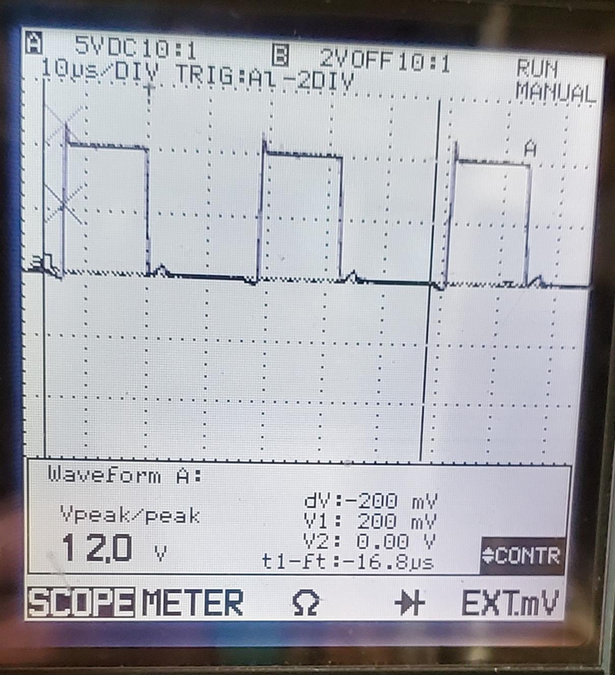

Is the note on the left image what it's supposed to be? Were the drivers bypassed?
What was the B+ voltage when these were taken?
Drivers were not bypassed.
B+ voltage was 9.95V. I have 2ohm current limiter in series with B+.

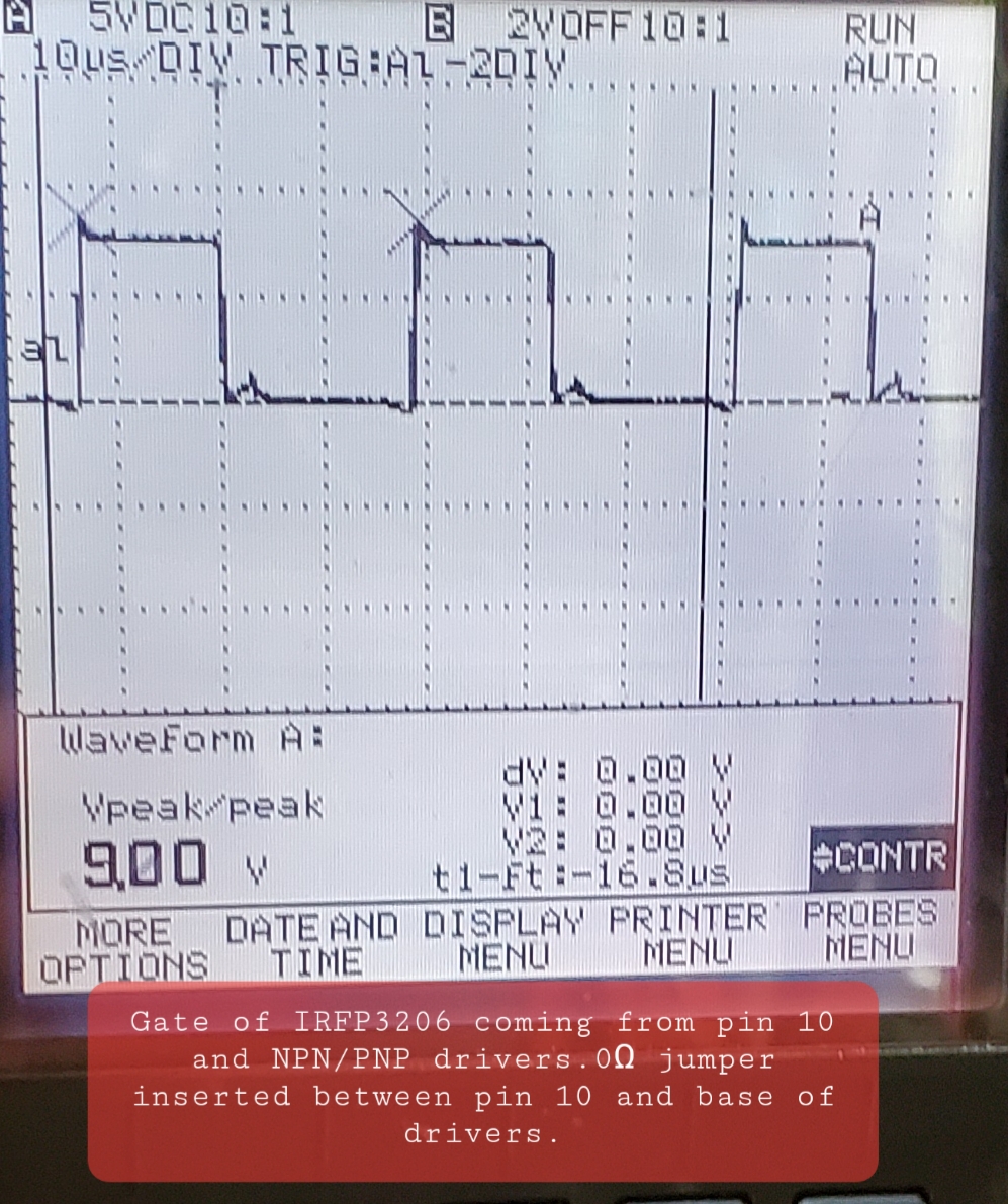

All i did was insert a jumper in place of R60. Probe on gate. Ground lead from probe on source of the IRFP3206.

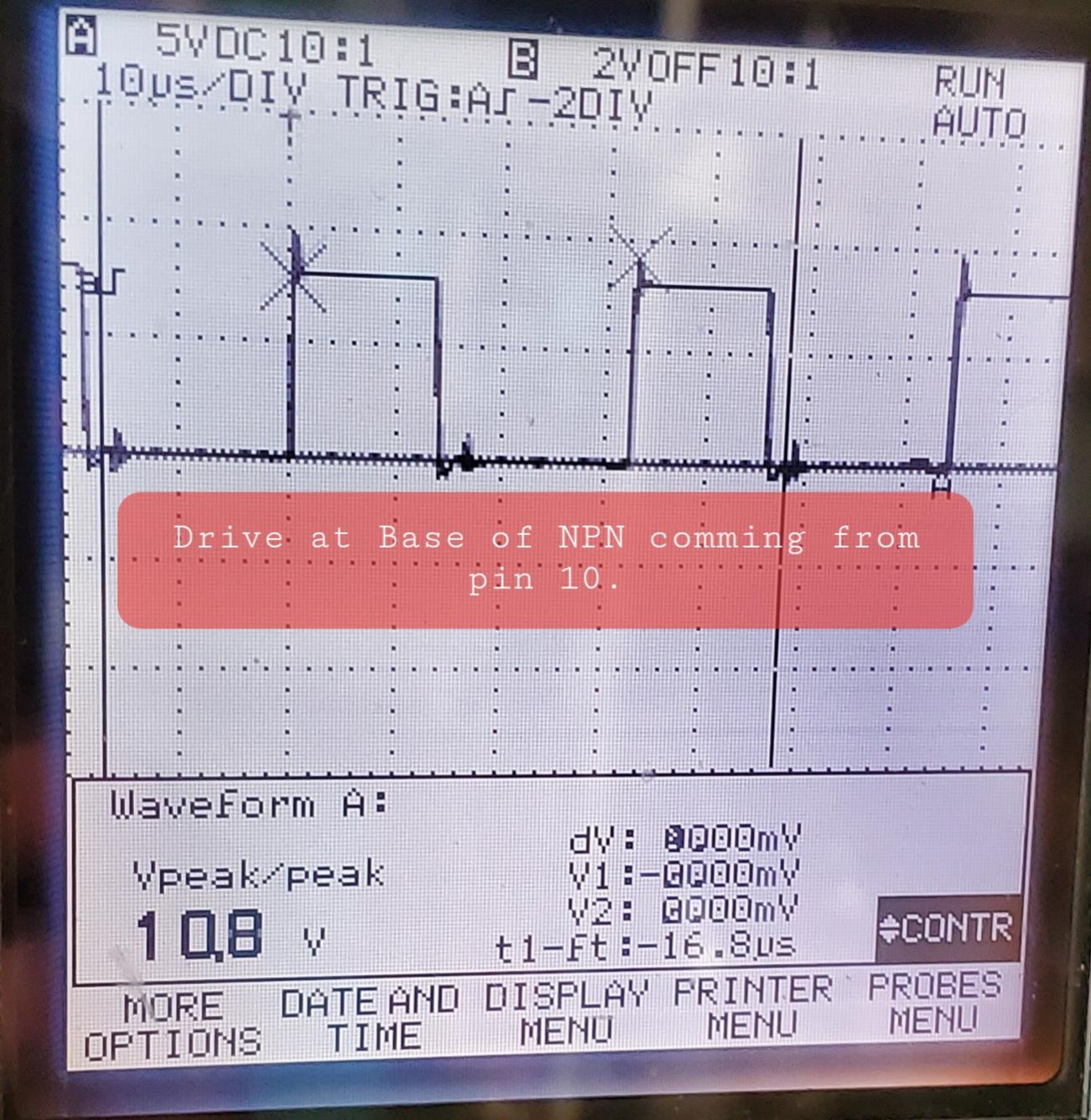

With 12.06V B+ there was an amplitude of 6.5v on the base of BD139.
Now i have an amplitude of 11v on the base of BD139 with a 0Ω size 0805 surface mount in series with pin10 of TL494 and 2 sets of NPN/PNP drivers.
