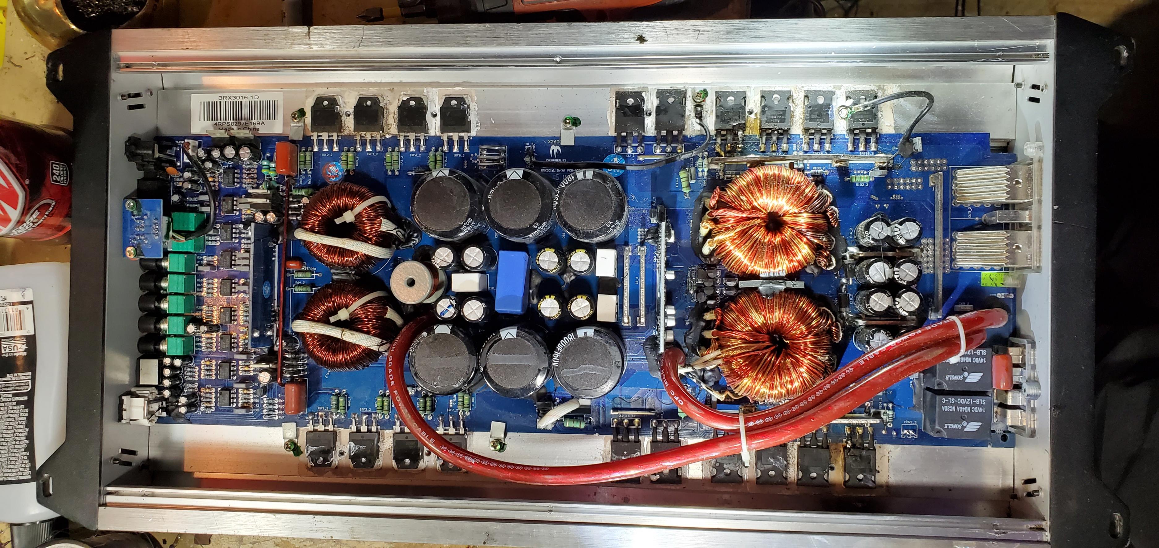

Hifonics BRX 3016.1D waveforms

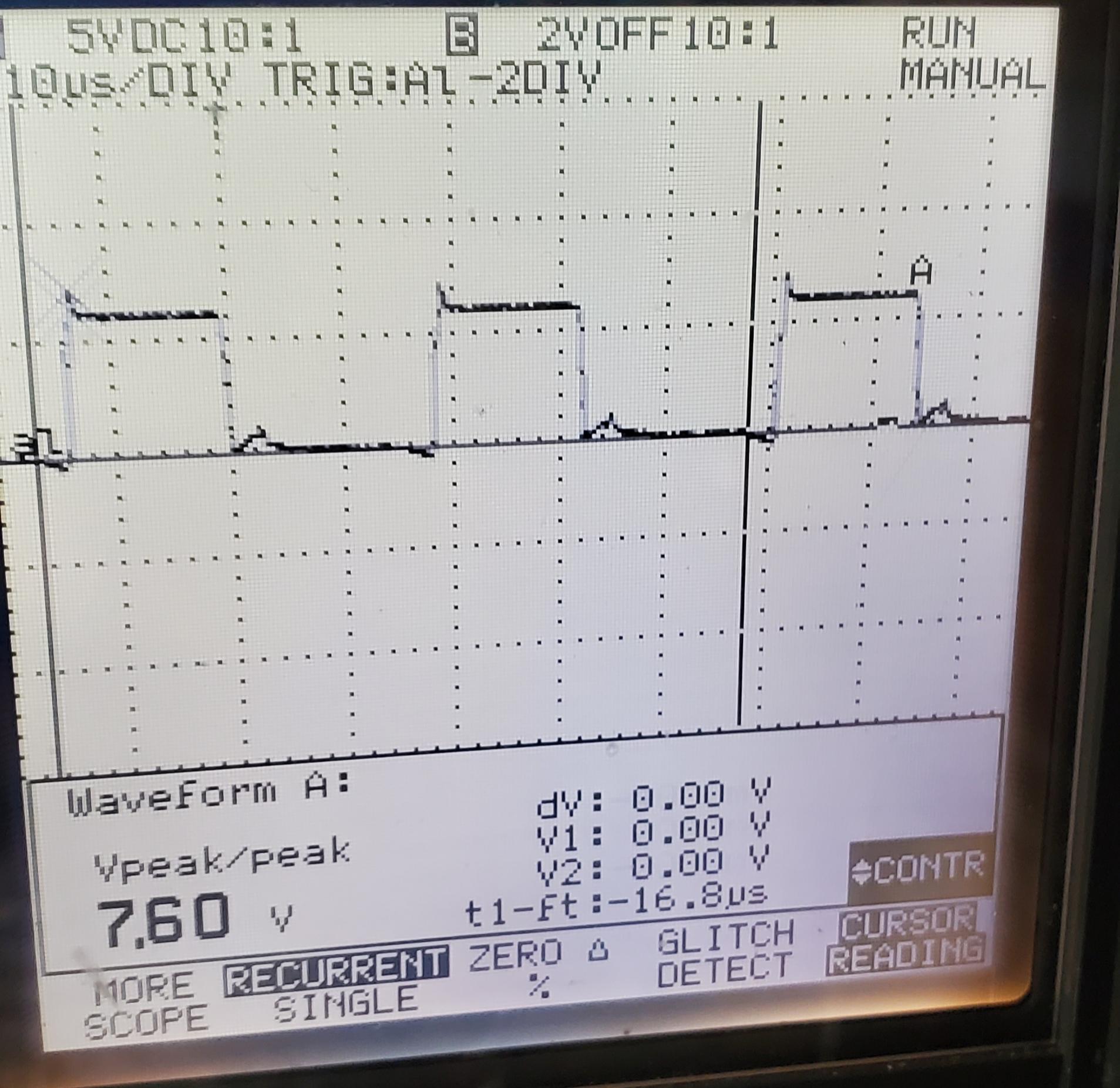

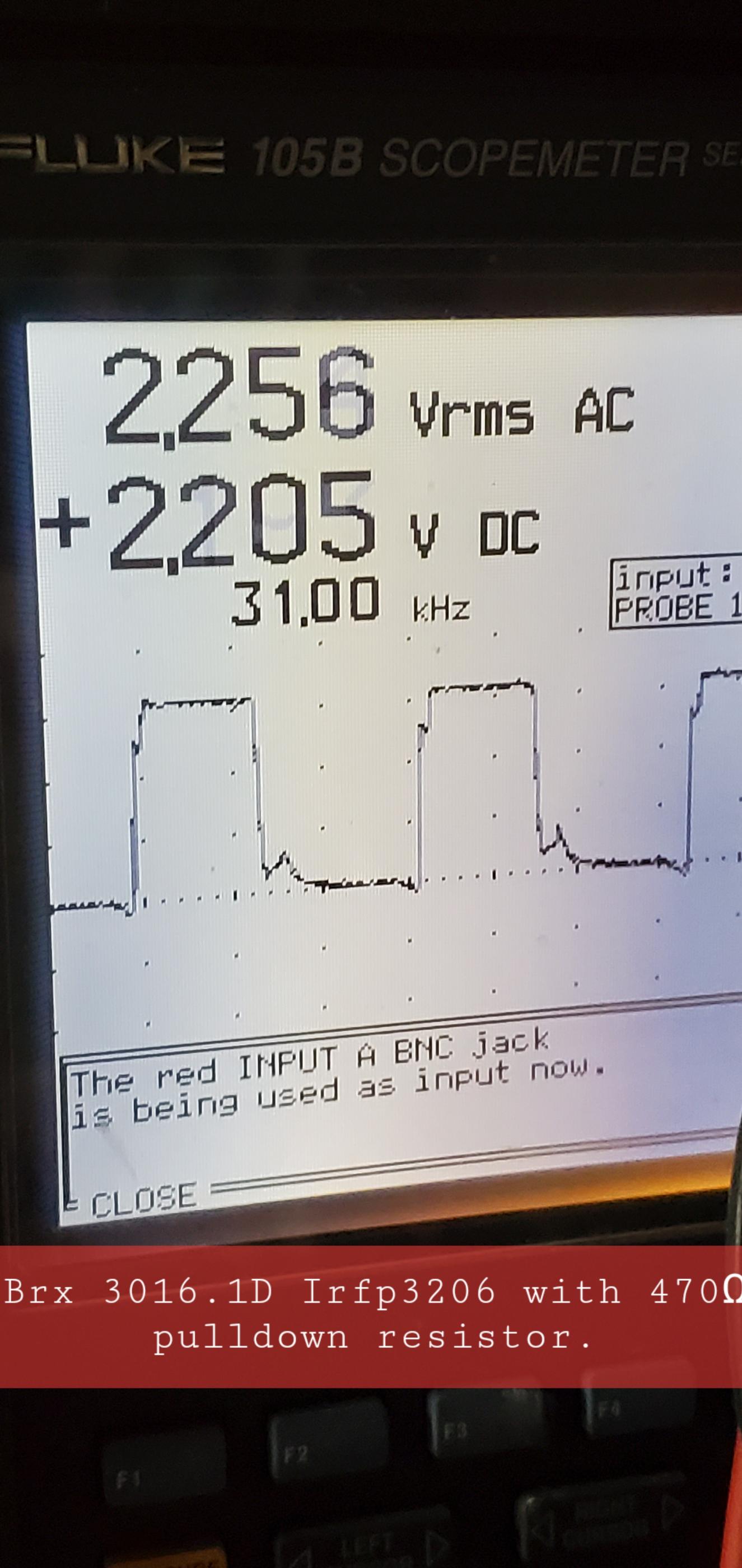

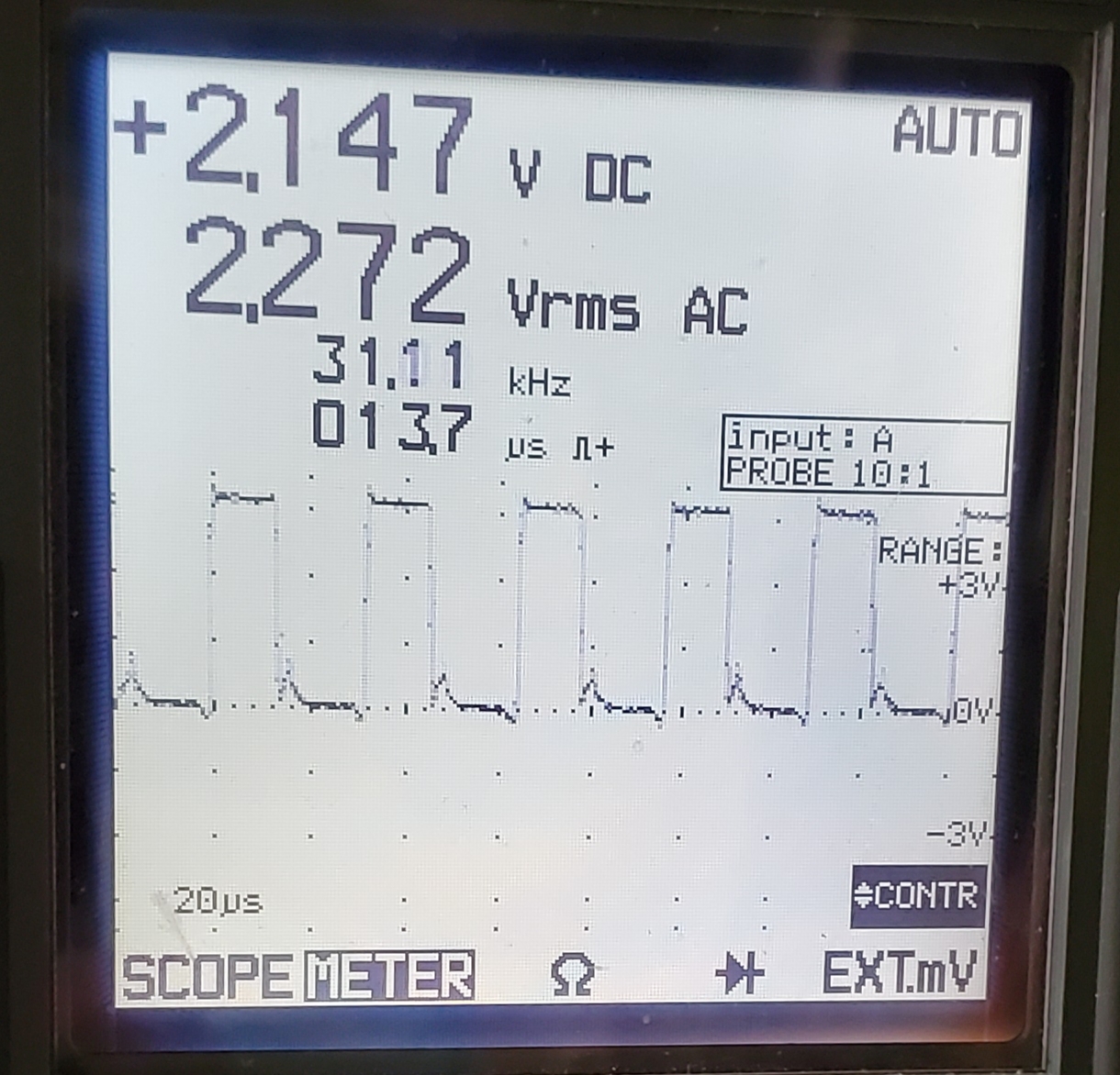

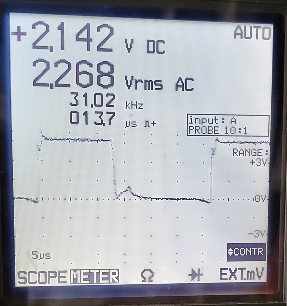

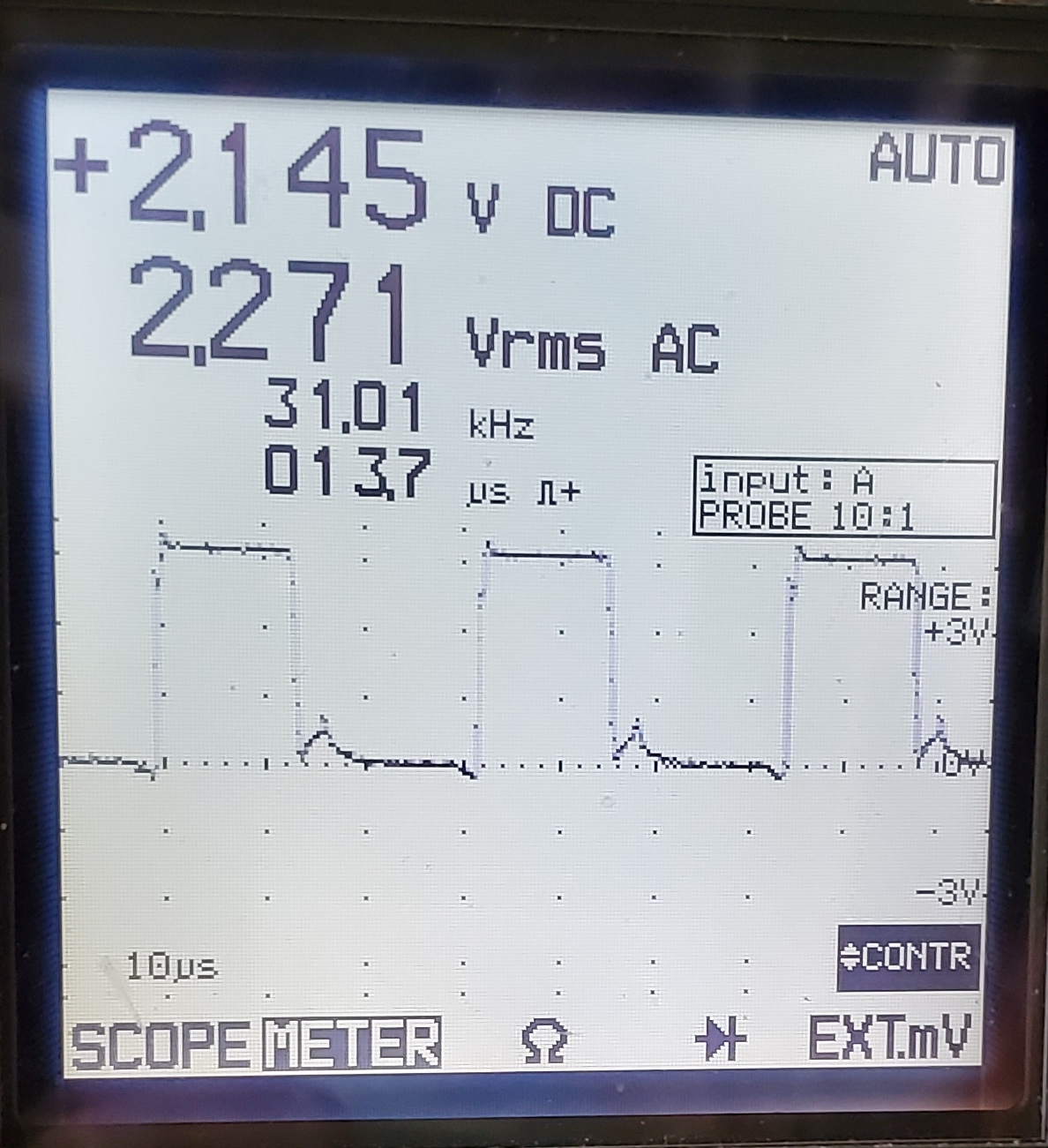

I adjusted r60 / r61 to 100ohms. Is the notch circled in red of any concern? I think this is the part of the waveform from the NPN pulling the signal up?
Taken from the irfp3206.

I just went in for the night but i did check the other side bank of irfp3206s and i have 3.4volts on the gate.
The initial side we started troubleshooting i am seeing 2.7volts.
I did get the BDs from Arrow electronics. Bd139-16 ON semi conductor. They were the older ones marked obsolete. I assume the ones they phased out because they were made with lead.

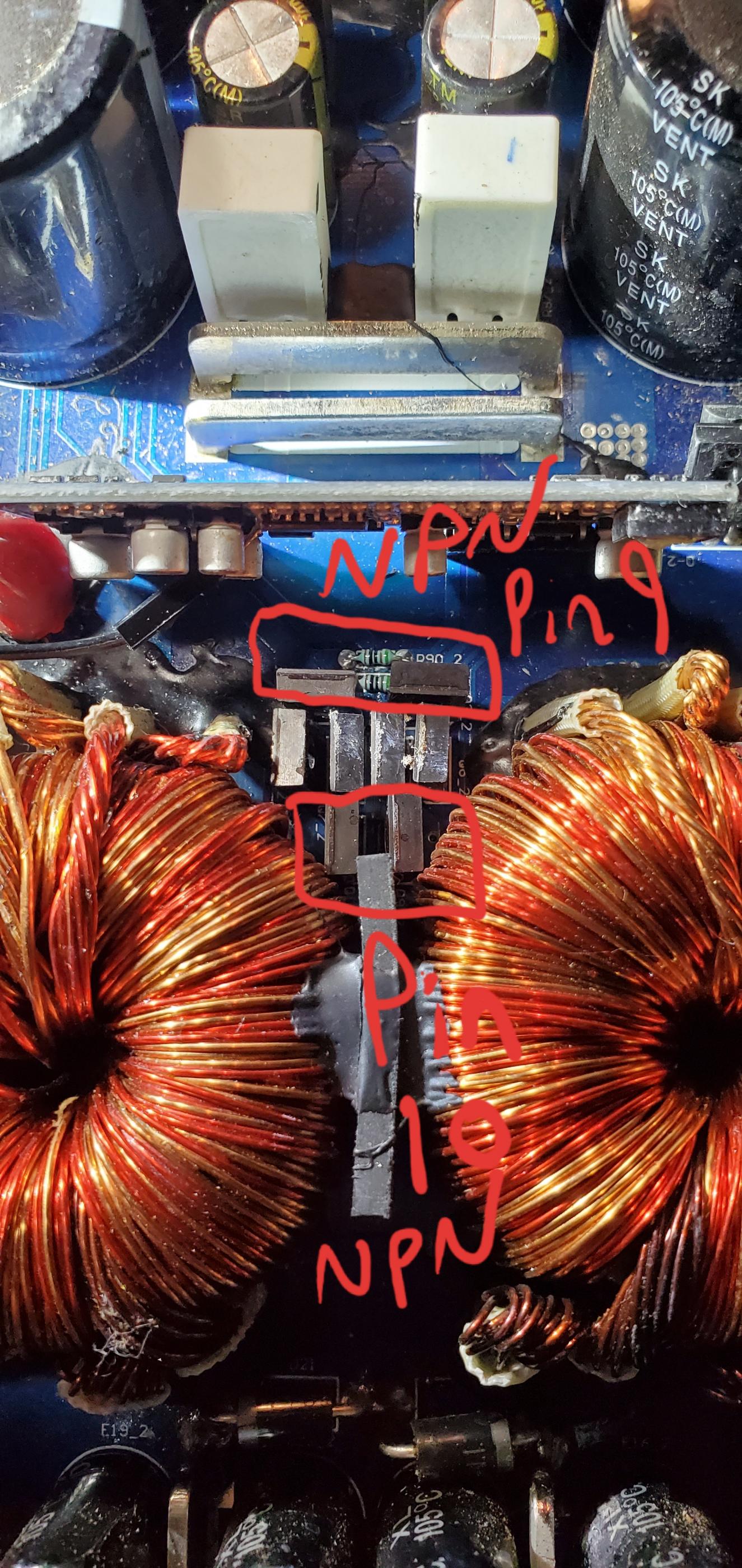

I will proceed tomorrow as instructed and lift the r60 and see how it goes.

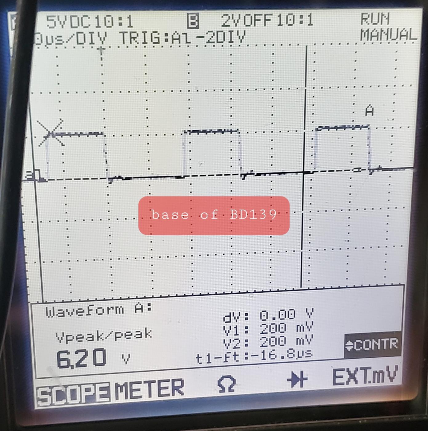

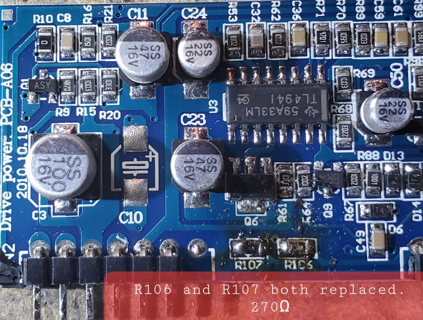

In this amp R60 was originally 270Ω size 0805 surface mount. It is the resistor in series with pin 10 of TL494 and 2 sets of NPN/PNP drivers.
With 12.06V B+ there was an amplitude of 6.5v on the base of BD139.
Now i have an amplitude of 11v on the base of BD139 with a 0Ω size 0805 surface mount in series with pin10 of TL494 and 2 sets of NPN/PNP drivers.
The reason I ask is the resistors were completely black when i replaced them most likely due to failure of the power supply and drivers but i wanted to make sure they weren't to small to begin with. I usually see these resistors in similar amps being 1/4watt through hole resistors.
