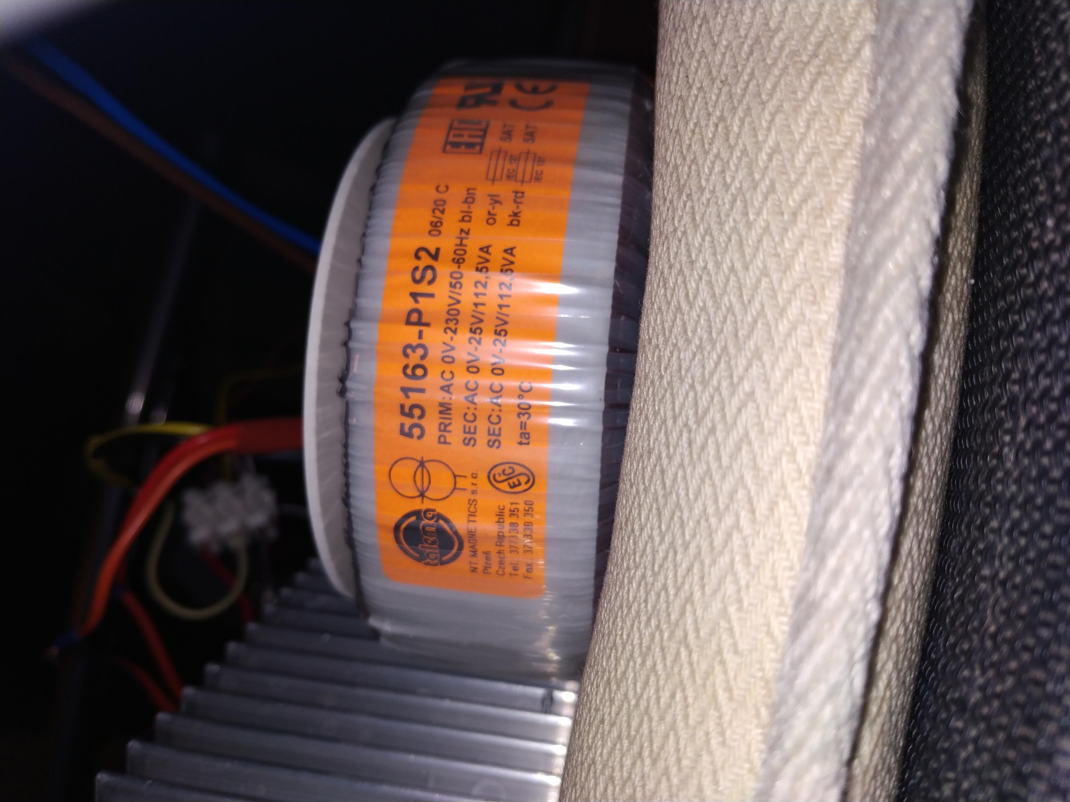

Can I put the transformer in a separate box? Is the transformer 2 x18 volts ok for +-23 volts DC with simple ripple eather?
Yes, you can separate the PSU if you want to. Use thick cables between the PSU and the amp modules. On +-23 VDC the amp will still be fine.

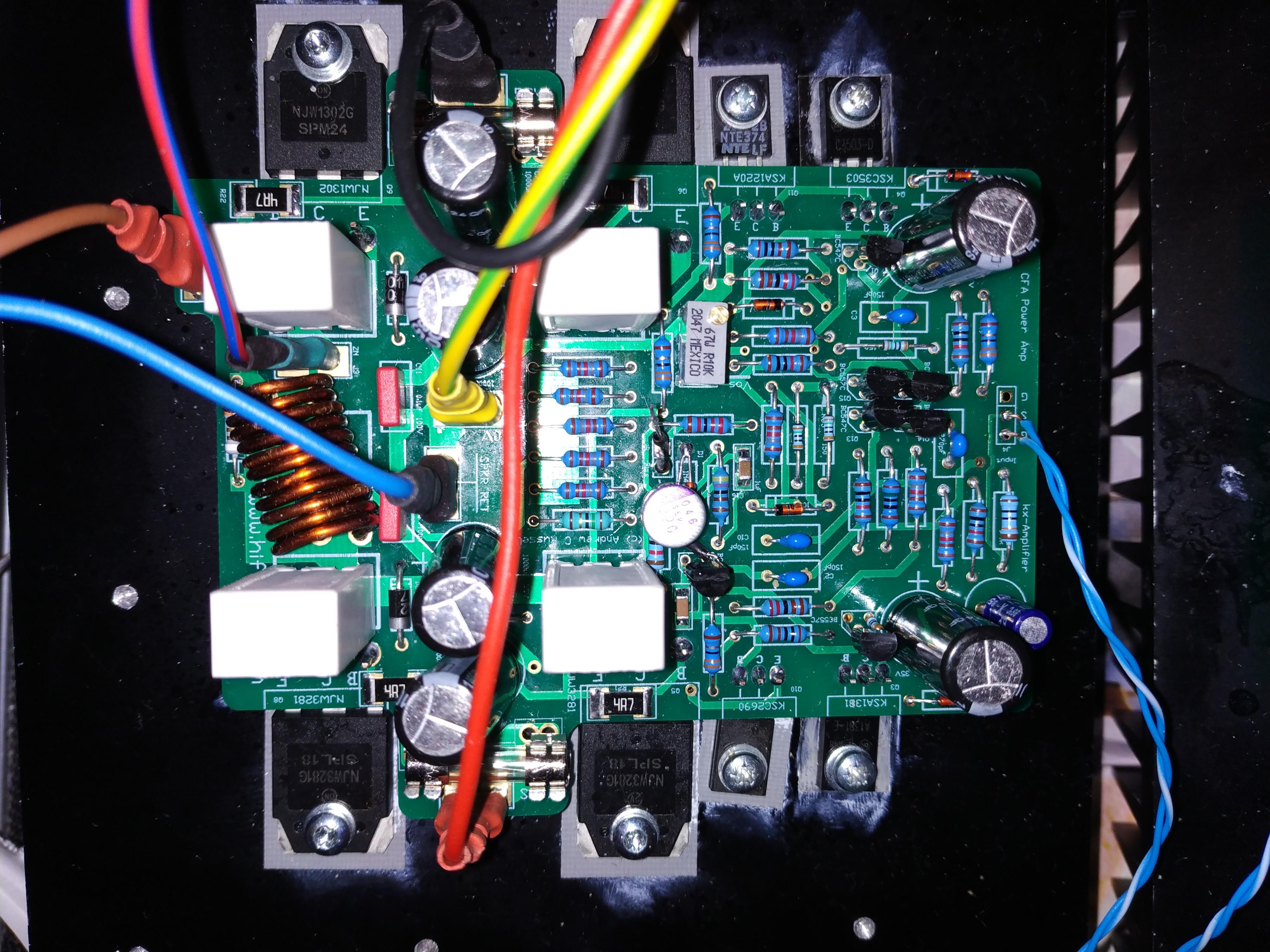

Something is not right. Transformer 250 VA 2x25 volts, J8 open (AAB mode), 400 mV across R14 / R15! +- 30 volt input simple ripple heather, + - 27 volts in the rail! Heatsink very hot.
35 volt output simple ripple heather without connection.
Even in class A I have a strong voltage drop.

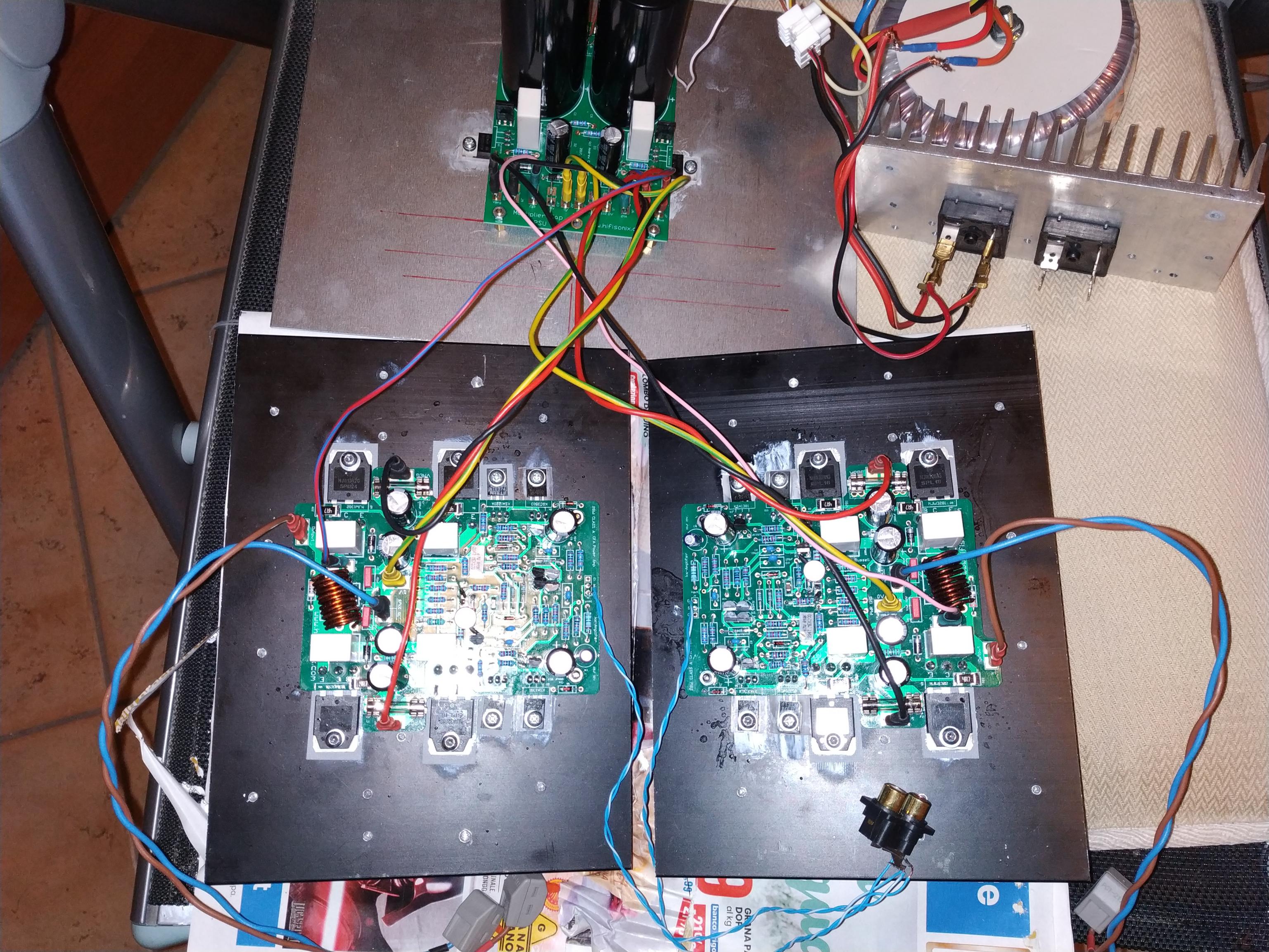

Can you post a photo of your amp, showing the heatsink and PSU?
Is that a flat plate the amplifier is on? I cannot see from the photograph
lamellar heatsink
no.2 x 1,5 kg.
Just to check
Supply rail is +-27 VDC = 54 V total
Each pair of transistors is 400 mV = 0.6A = 1.2A per channel
Total standing power dissipation is 54 x 1.2 = 65W
I am guessing your heatsinks are 0.4C/W = 26C temp rise above ambient so for 25C ambient the heatsink temperature will be 51C.
Can you confirm these temperatures are roughly right?
If you lift R18 and leave the bias switch (J8) OPEN the amplifier will go to class AB and the standing current will drop to about 60 mA and it should run cool - if you try that and it does run cool, we can confirm that there is nothing else wrong.
