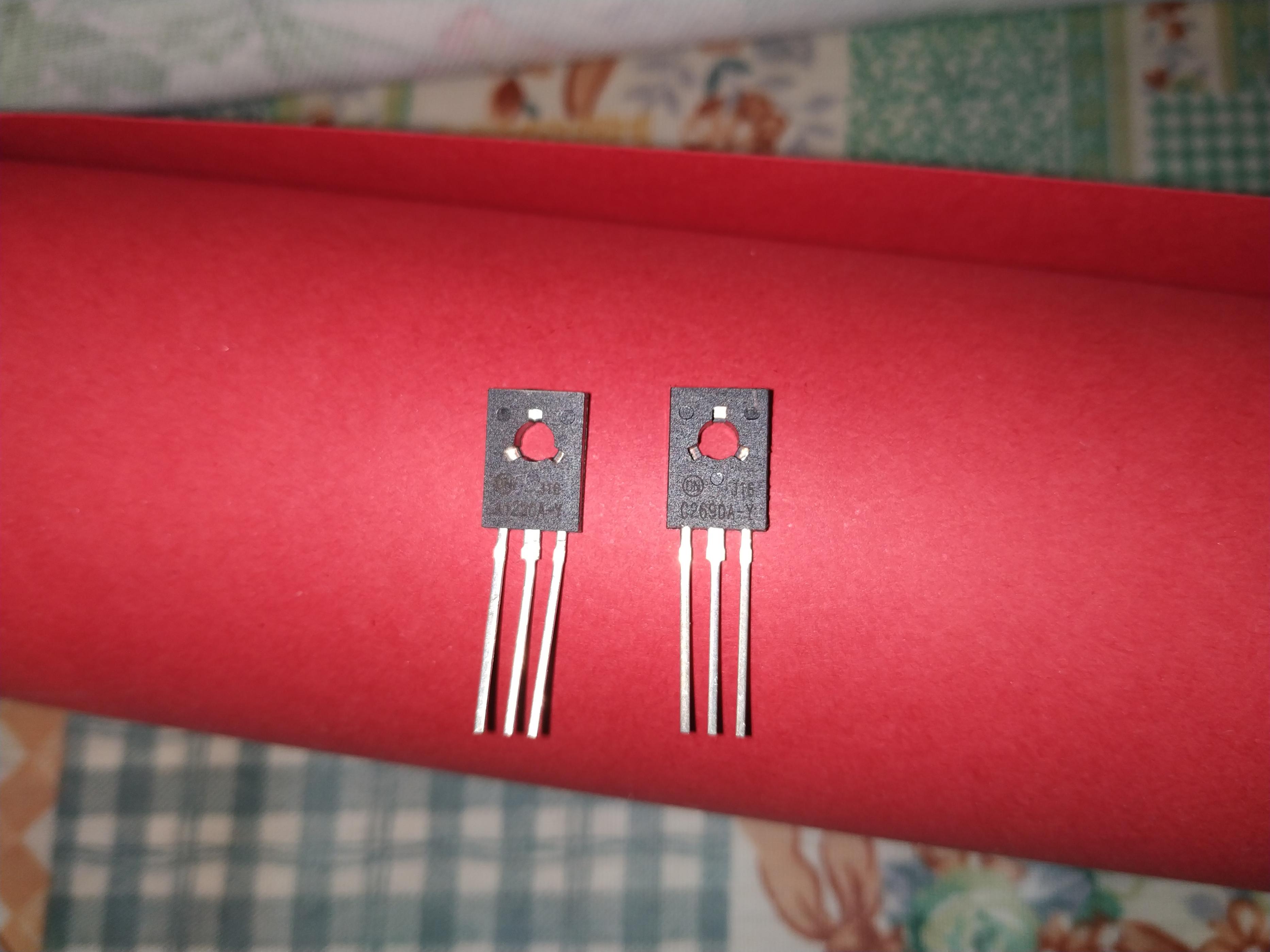

Hi, I bought ksa1220 and ksc2690 on ebay. I don't know if they are fake.
I measured hfe:
20 pcs PNP between 140 and 180 hfe, pinout ECB.
12 pcs NPN hfe 140 approx, and 8 pcs NPN hfe 440 approx, pinout ECB.
Can you give me the answer?
Thanks.

Yes - make sure that both Q7's (ie left and right channel) hFE is within 5% of each other. This will ensure the standing current between the two channels is the same. if you have big differences (say 200 and 600) you can get up to 60 or 70mA difference between the channels.
Davide, I am sorry to hear that, but cannot help feeling part of your problem was to do with buying parts off eBay. You really have to get components from reputable suppliers (Mouser, RS and Digikey) and stick to the design and selected components.

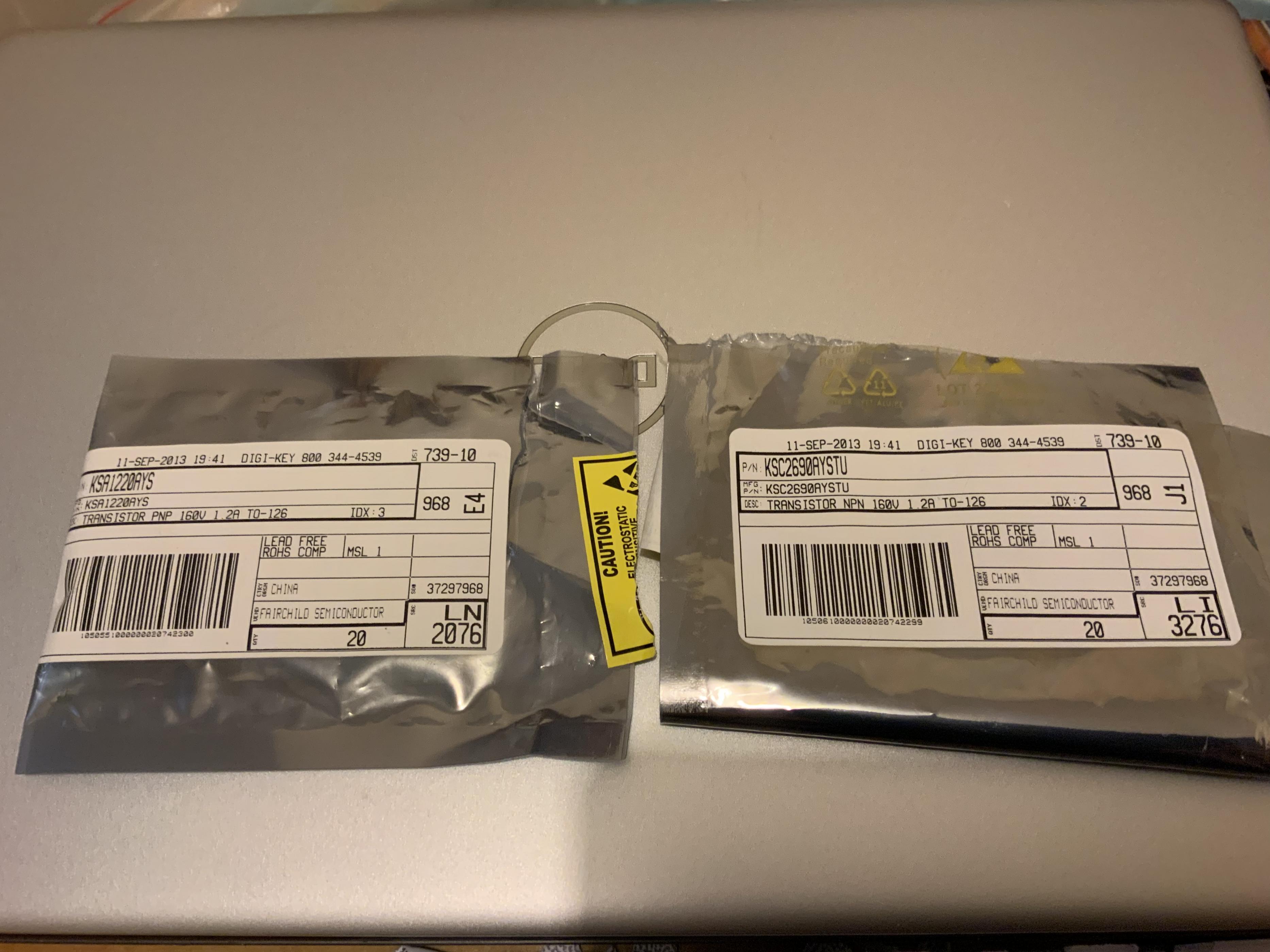

KSA1220AY and KSC2690AY
ebay was the last place to find them.
Hi
If that is the only issue you have then I have more than 10 parts of each bought at Digi-Key.
I can measure closest hfe and then spare 2 pairs of each for your project.
You would only have to pay for shipping.
