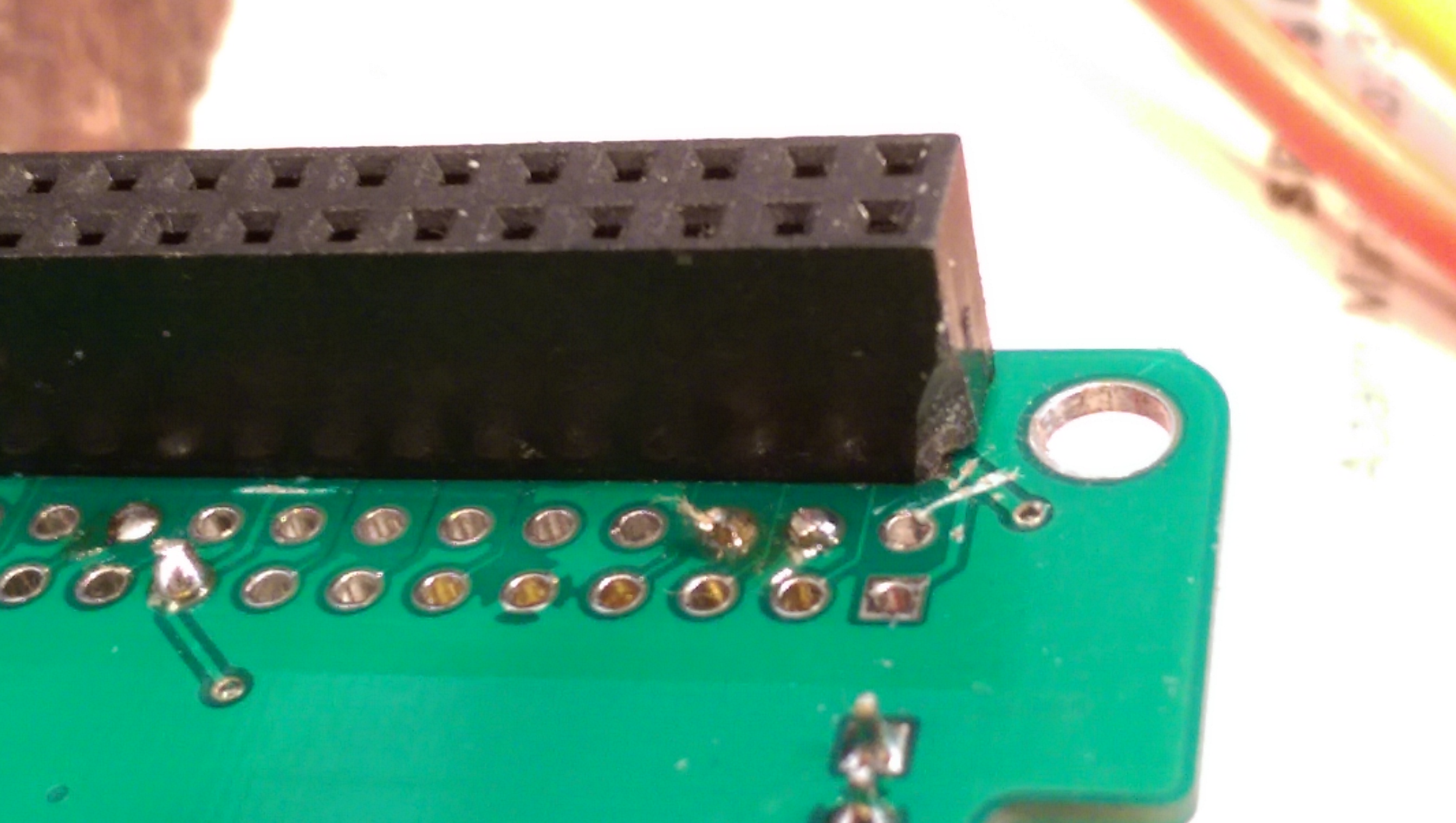

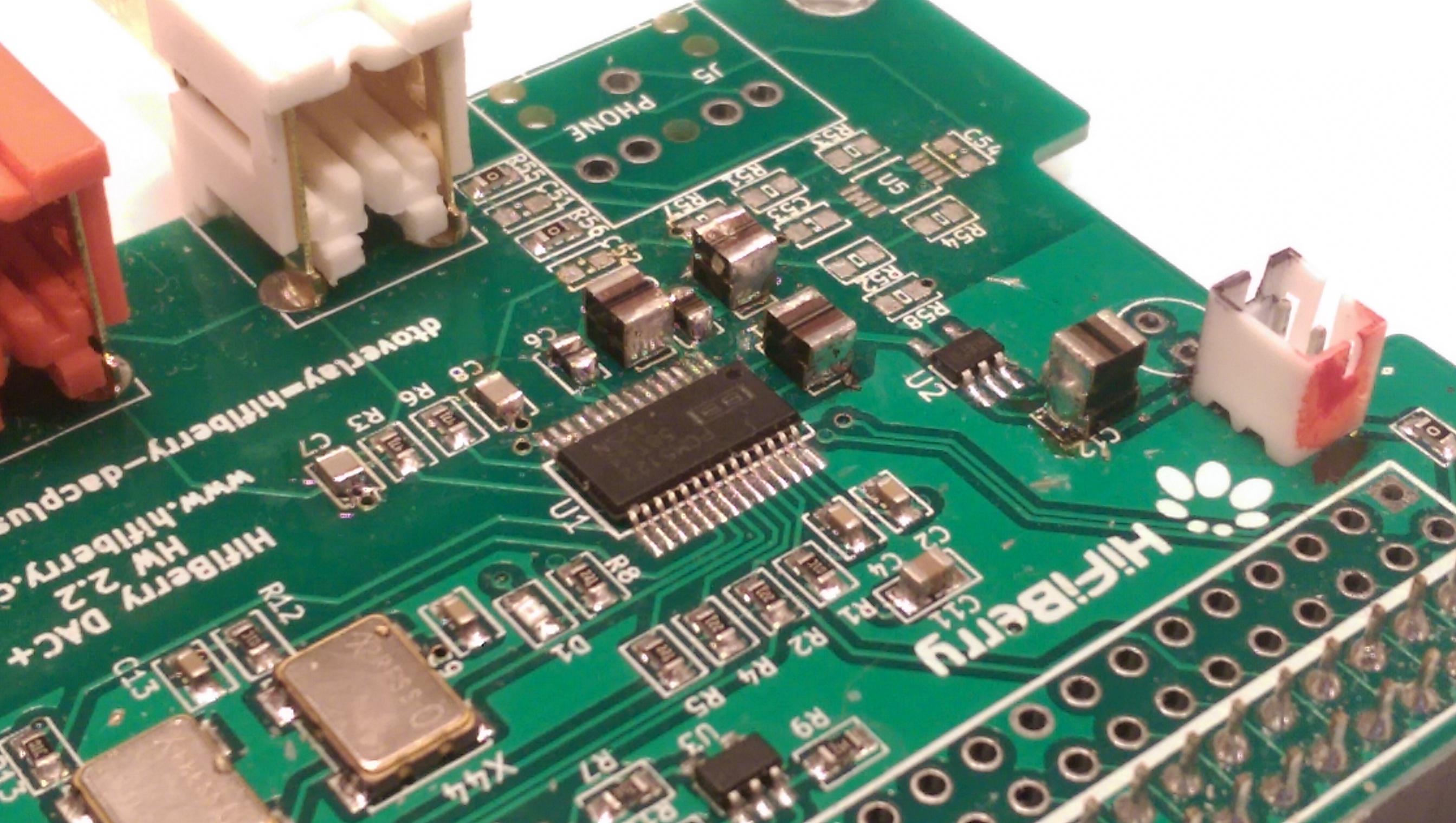

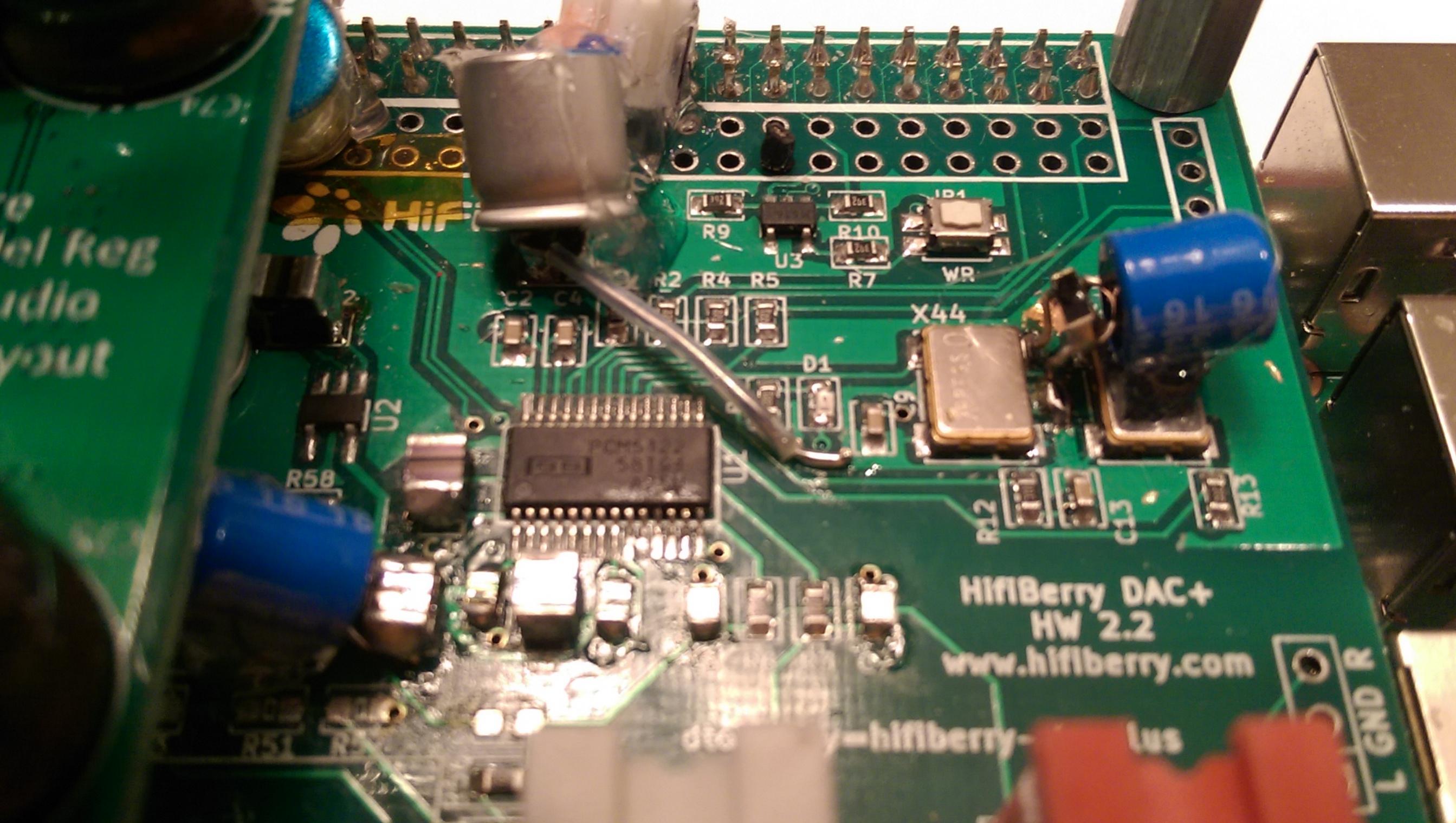

Pistollero, these pictures also show how I converted mine to run off a separate 3.3v supply...
1. Carefully cut the three traces on the back of the DAC card as shown. An alternative is to remove or bend pins 1 & 17 so they don't connect to the DAC anymore. CHECK THIS WITH YOUR METER BEFORE YOU PROCEED!!!
2. Feed 3.3v into the card. I fed it into Pin 17 with Pin 20 as the ground.
3. Link the 3.3v into the clock 3.3v land, as shown in my 3rd picture.
Again, you will get your best results with a regulated supply that is very close to the board... mm matter here, not cm or inches! If I were using an iFi unit (and I totally agree with Soundcheck that they are very good power supplies and beat a lot of bog-standard linear supplies), I'd go with one at 5-7v output and have the final 3.3v regulation mounted right on the DAC board.
And IMHO, you will get the best results with separate supplies and regulators for the digital and analog sections of the board, but a good single supply with separate regulators should still be good step up from the R-Pi 3.3v power feeding the DAC 3.3v and clocks!
