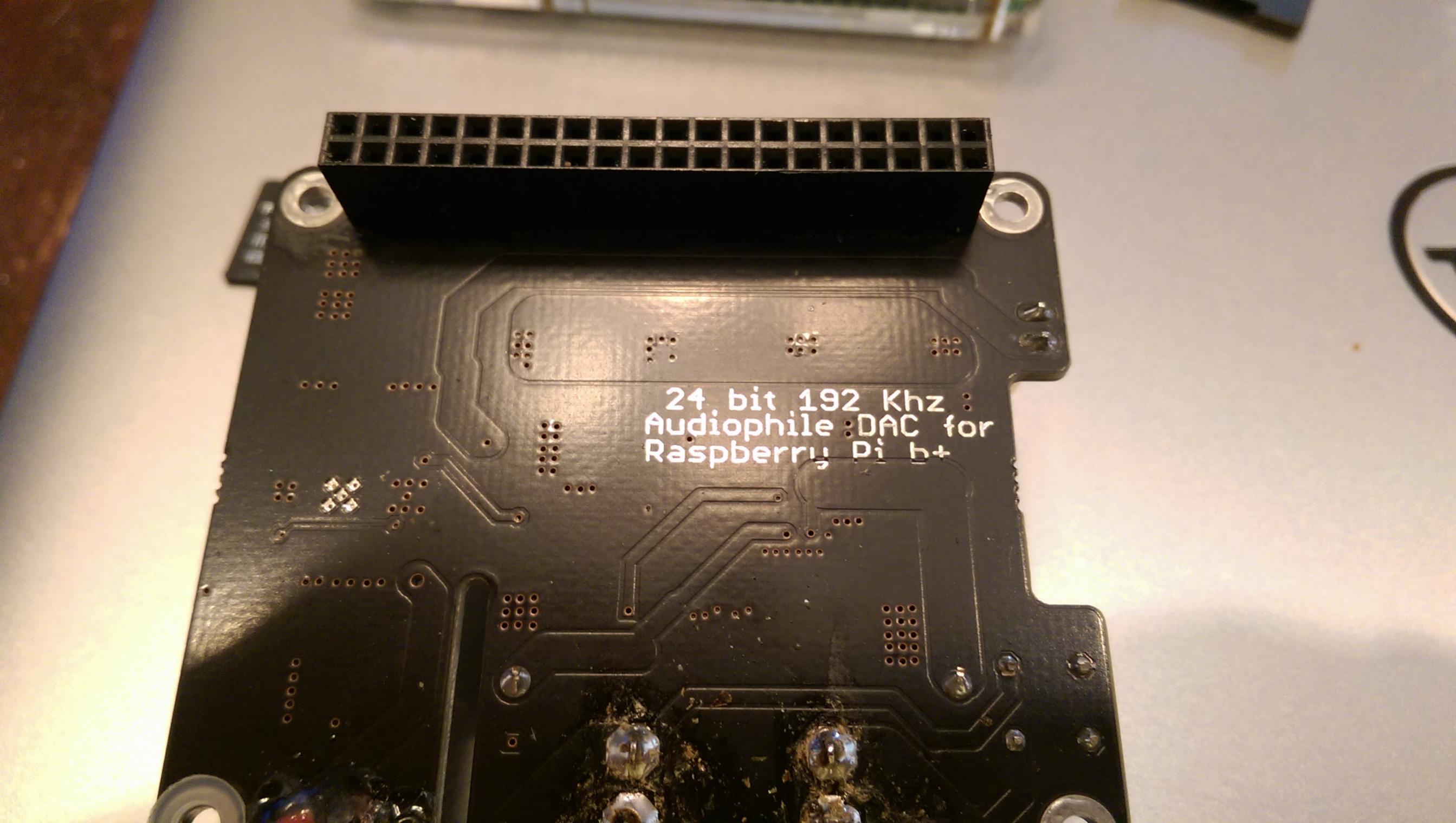

The other had to do with questions about the MamboBerry and 384 playback... first, I've attached a closeup of the clock and there is no Mhz indication on the unit. Based on the requirements of the ES9018, I would expect a clock faster than 80Mhz, perhaps as high as 100Mhz needed for the unit to successfully play 384. OTOH, the datasheet states a max of 50Mhz.
Second, I've attached a picture of the bottom of the MamboBerry... draw what conclusions you want from what is printed there.
My own opinion is that it is likely limited to 192 based on my read of the ES9023 datasheet. OTOH, the ESS datasheets continue to be the sketchiest in the business AND I've seen people going beyond the recommended limits on ESS (and other) silicon successfully in the past, with ES9018's overclocked beyond the recommended 100Mhz ASRC clock with some success. AND since the ES9023 core is based on that of the ES9018 and other sister chips, it may be that it can go higher. AND I have no reason to distrust what the MamboBerry people say. Myself, I haven't tried them above 96 in my setup, I don't have any music above that available on my Pi Players AND don't have SOX upsampling running on the server at this time.
Still, it is a very sweet sounding unit for the $ and is what I consider a minimal-level unit for good sound (with two good power supplies (at least equivalent to the above... and even though I haven't tried them myself, my take on comments about them is that the iFi units are likely very worthwhile here) required for this result, one for the Pi and one for the DAC).
