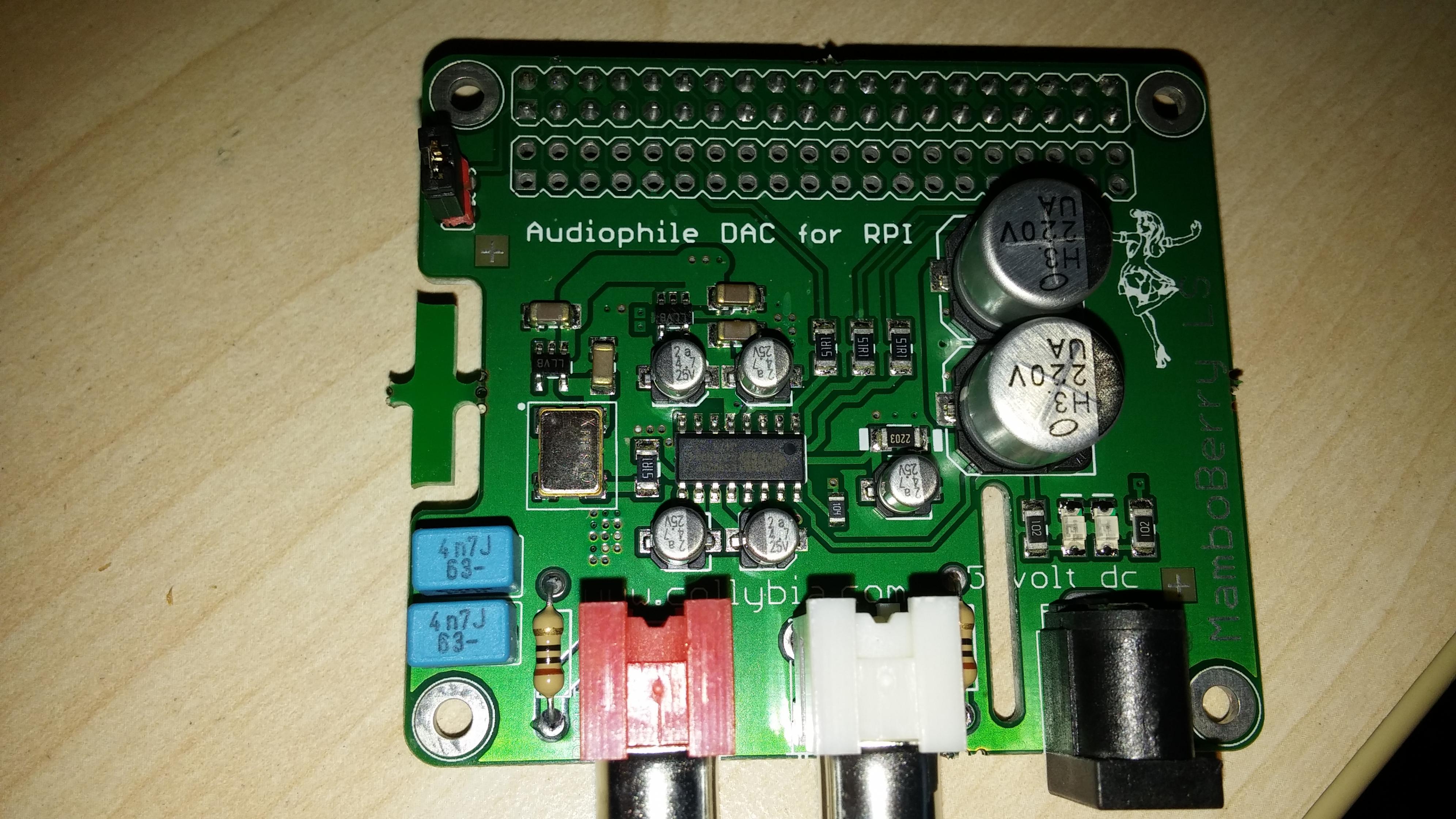

I just received the Mambo Lite. Looks quite nice on the first glance.
Decoupling. Check.
Two separate regs. Check.
Routing. Check.
5V supply. Check.
Cinch sockets. Hmmh. Cheap stuff. I solder my stuff right to the board anyhow. Not any $100 WBT silver binding post/socket could beat that - a $0.02 soldering joint. 😉
DC socket. I'll bypass that one too.
Plan is to power the PI and Mambo with iPower first. Later I'll try to power the Mambo separately with 2*LiPoFe4 + low noise reg from inmate mravlca.
Now.

New Mamboberry DAC Hat
@Soundcheck,
Thanks for the great picture and assessment of the new Mamboberry. The dual regs, one for the DAC chip and one for the clock, should be the main reason for the reported improved sound. I'd say this version is more optimized for a fully separate power supply (BYO supply with a regulated 5v output) while the original one was more optimized to allow just AC from an appropriate transformer. The regulators used on the newer Mamboberry are good, but not necessarily improvements over the ones on the older Mamboberry.
Both versions should be better with the Pi powered separately and I couldn't say which will benefit most from that arrangement.
Also very curious on how it sounds in your setup.
At some point I will likely modify my original Mamboberry to separately power the clock and DAC chip, it looks like it can be done fairly easily after cutting one trace. But that is pretty low on my work-list right now.
Later!
Greg in Mississippi
