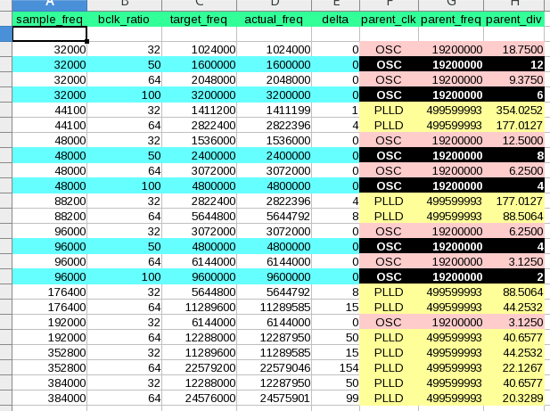

@Clive.
Did you ever come across any patches that were used to enable 384kHz in the past.
The base PI Alsa sources still just won't allow more then 192kHz for any DAC as far as I can judge!??!
And that'll go on until 4.6. If anybody claims higher rates, there must be kernel patches been available/used.
Background:
I still have problems to get squeezelite going @384. It's giving me hwparams setting issues on 384kHz.
These I don't have with sox. I was wondering if I was missing something.
Attached you'll find my patch. That's no rocket since, just some declarations get changed.
Only the patch I wrote. I wasn't aware of the patch, that had been posted to the ALSA mailing list until you posted a link last week. (I was surprised they didn't add a def for 352800 at the same time.)
EDIT: Oh, and if you do add a def for 352800, you'll need to modify the codec driver as well.
And at the risk of giving you more to complain about
