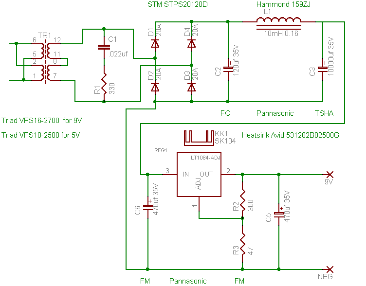

Hope this isn't hijacking the thread, but I'm interested in building my own linear PSU for a RPi and HiFiBerry combo. I've drawn up the following based on a few circuits out there. It's only $21 in materials, and I think the performance should be quite good. Any thoughts or suggestions?
Illinimdg,
Sorry for not responding earlier.
I have a couple of thoughts on this...
1. The LM350 regulator is nothing special and there are better ones available today which will have better performance at high frequencies which is CRITICAL for digital circuits. The one that I've used that has the the current capacity to run a R-Pi/HFB DAC combo is the LT3083.
2. The raw DC supply is as if not more important than the regulation chip and circuit. A 7.5vDC wall wart will not be a good DC source. The only comparable small setup currently available that uses a wall-wart switching supply I know of that is considered good is the iFi one, but they are basically sold as complete supplies and not cheap.
An alternative is the K&K Audio Low Voltage 12 watt supply which he sells in kit form for $48 here: K&K Audio | Other kits. I currently use 5 separate supplies of this configuration, either modified K&K supplies or DIY'd ones of a similar configuration, to feed my R-Pi, this small Zotac micro-computer I use for my LMS server (Amazon.com: Zotac ZBOX ZBOX-PI320-W2 Desktop (Black/Silver): Computers & Accessories Amazon.com: Zotac ZBOX ZBOX-PI320-W2 Desktop (Black/Silver): Computers & Accessories ), a network switch, and a wireless router, with a couple of supplies as spares for future additions (such as a larger storage drive... right now I use either a 128Gb or 256Gb SD card to store music in the Zotac, but that only holds less than a quarter of my rips).
There are better options, but I consider this supply as sold by K&K to be a minimum DIY supply for these applications.
Greg in Mississippi

Hey Greg, thanks for the reply! Yeah, I wondered if the wallwart wasn't up to snuff. You wouldn't happen to have a schematic you'd be willing to share for the LT3083? I'd prefer to DIY if I can, if only because I'm cheap. 😉 If not, I'll have to strongly consider the K&K offering. Thanks, and cheers~
LOL... you mean buying a schematic, a board, and a bag of parts is not DIY enough for you? I've checked, you can't provision his kit for much different than he charges for it (the magic of quantity discounts!).
Tell you what... I respect Kevin's work on behalf of DIY'ers and don't want to give away Kevin's tricks in his supply (I know of two in there), but if you get one I'll let you know what I do with my version of his (which is mostly different caps for hopefully more and better filtering).
Let me know.
In the meantime, a bit more adventurous supply, but IMHO better one, is John Swenson's choke-filtered supply, which is the predecessor of his almost $1k JS-2 supply from Uptone Audio. He had published it several places, so I have no issues sharing it here. If it were me, I'd build it as-is except replacing the LT1085 circuit with the LT3083 circuit from the datasheet.
Greg in Mississippi

Well, now I'm a bit embarrassed! Granted, I couldn't exactly do a BOM cost roll-up off the picture; I've just seen kits like that have some rather high markups, which seems odd for the market (being DIY and all). But if you say the K&K kit is well-priced, then I'm happy to patronize him. If you don't mind dropping me a PM with your mod tricks, I'd be grateful!
As for the Swenson PSU, is it this one?
If that's not the one you had in mind, would you mind posting it as well?
<SNIP>
LOL! You didn't like the one I posted already?
Yup, that's the one. It is very good. Better than the K&K, but for about 2x the cost and space due to the choke.
