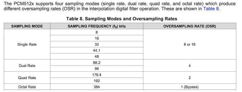

The driver seems to be limited to 192kHz.
What goes out to the DAC is this:
Basically sox resamples to a .rate_max of 192000.
The DAC pcm512x codec source (this is not the driver) shows 384kHz as .rate_max though:
[/CODE]M512x_FSSP_384KHZ;
pcm512x.c: .rate_max = 384000,
pcm512x.h:#define PCM512x_FSSP_384KHZ (3 << 0)
[/CODE]

OK. I just looked at two basic Alsa kernel 4.4 sources:
/linux/include/sound/pcm.h
/linux/sound/core/pcm_native.c
and the I2S driver:
/linux/sound/soc/bcm/bcm2835-i2s.c
Bottom line. Alsa just supports up 2 192khz on this kernel - independent of specific DACs.
Even if technically 384khz would be possible with the DAC+ Pro. At least patching above files and a kernel update would be required to enable 384khz - as far as I can see it.
It's more than just a HifiBerry driver update.
I don't think though it's too difficult to introduce 384kHz as samplerate. Perhaps there are patches available somewhere!?!?
Clive. Please, correct me if I'm wrong.

Found it now!
Here is the Alsa 384khz patch and related developer discussion.
That pretty much confirms my earlier findings. 😎
From here it is just a tiny step to get it into the HifiBerry DAC+ Pro driver universe -- I'd guess.
EDIT: Just checked all sources from kernel 4.4 - 4.6 - Above Alsa patch is not part of it! If we want it in, we have to do it ourselves.

What do you folks think this:
means ? 😉
Code:
cat /proc/asound/card0/pcm0p/sub0/hw_params
access: RW_INTERLEAVED
format: S32_LE
subformat: STD
channels: 2
rate: 384000 (384000/1)
period_size: 1024
buffer_size: 8192
means ? 😉

Yep. I managed to get it working @384kHz.
3 files need to be patched in the kernel.
Above listing shows the actual samplerate that goes out to the device during playback.
For now I made it work with sox as player only.
I'm still facing problems to get squeezelite/LMS going.
Somehow squeezelite thinks that 192kHz is still max.

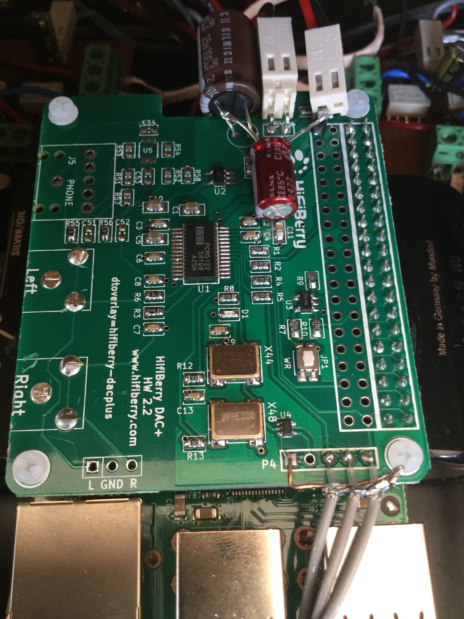

Hello all,
Today I replaced the ExpressO TCXO's with NDK NZ2520SD's
For the ones interested in replacing the ExpressO TCXO's, BE CAREFUL!!
Since there are no frequency markings on the ExpressO's you have to look what's
printed on the PCB. The printings on the pcb are WRONG!!
The TCXO marked "44" is NOT the TCXO for 44.1/88.2/176.4 KHz sample frequency
The TCXO marked "48" is NOT the TCXO for 48/96/192 KHz sample frequency
You need to solder as below:
22.5792 MHz TCXO at "48" marked spot.
24.5760 MHZ TCXO at "44" marked spot.
This caused me a LOT of troubles experimenting, and too many times of de-soldering.
I finally succeeded and it works, but pcb looks like a battlefield right now 🙁
So, the 44.1 KHz TCXO (22.5792MHz) is the one next to the I2S pins.
