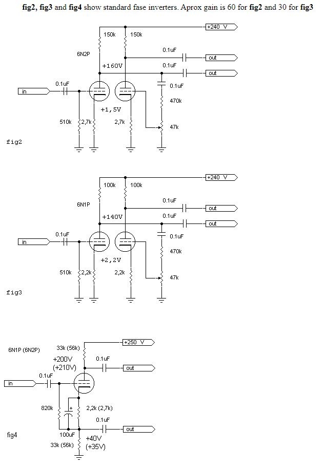

Ok, how about this first attempt at a circuit.
I have an existing pre-drilled/cut chassis so don't want to use interstage Tx.
If anyone would like to put into a SIM that would be brilliant!
I think that's a lovely start, some quick notes, however-
The input capacitor to the first triode in your long-tailed pair can be made a decade smaller in value, as the grid resistor is bootstrapped by the tail resistor. .01Uf would work well.
The plate resistor for the second stage will likely need to be adjusted in the actual built circuit, in order to bring the output swing equal between each plate. You have a good starting point so far on value. Also- if you replace the tail resistor with a simple current sink you can make both plate resistors equal. This will also give you more headroom for lower THD swing at higher output.
As drawn, I do not think you will have enough swing to bring the 6AS7G outputs to full output. And once you are close to the differential pairs full capability you will have high THD. Hard to tell exactly where that limit is with what I have access to at the moment, but figure some 75-90 volts peak before some 5% or so THD per 6N1P plate. This will be fairly audible and it will sound somewhat compressed depending on the balance and if it falls more 3nd or 3rd harmonic. The lack of swing will be brought even lower by the additional global negative feedback.

Here is a bit of a simulation, using 290V for B+. I added an LM334 to be able to use most of the B+ to the 6N1P while keeping the LTP properly balanced. I'd prefer something like a 6N6P to be able to ramp-up the LTP current. I'm not sure how good is the 6AS7 model I used though.
