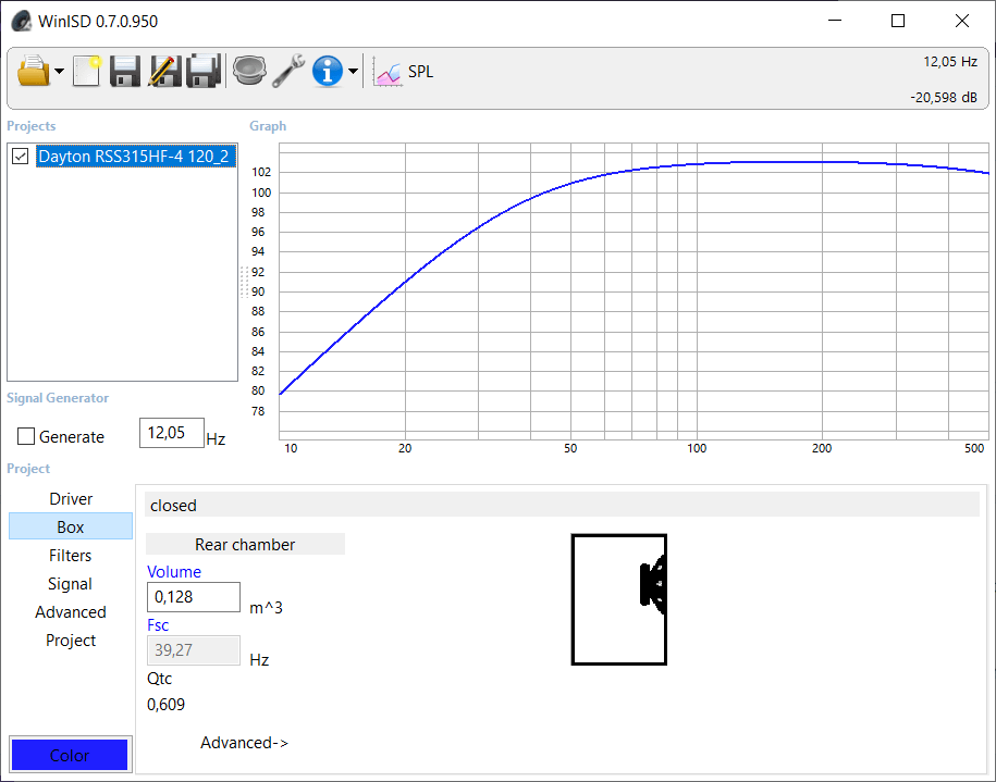

I put all data in WinISD and the frequency rollof is less steep at 128 liter (2 subs) compared to 40 liters (2 subs)
The SPL curve in WinISD (with my amplification) has much more output than what my satellites can achieve.
Therefore shaving the top at the subs makes the "flat" frequency range towards the low end extend even further down.

Agreed, You will have some room to cut and some room to boost at lower frequencies.I put all data in WinISD and the frequency rollof is less steep at 128 liter (2 subs) compared to 40 liters (2 subs)

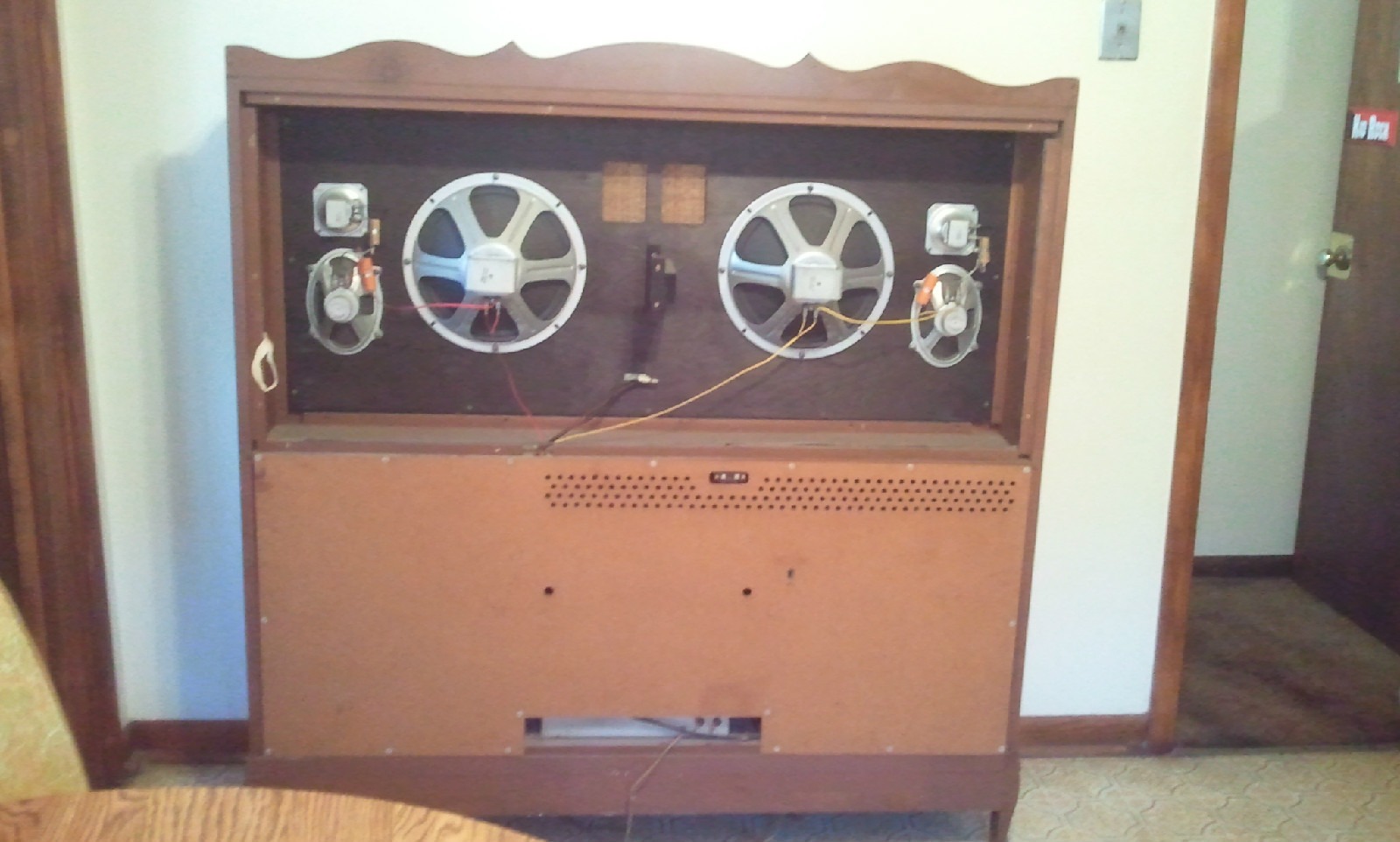

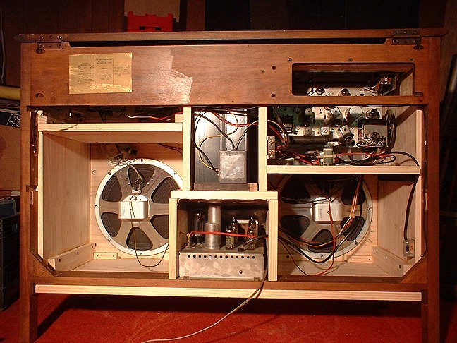

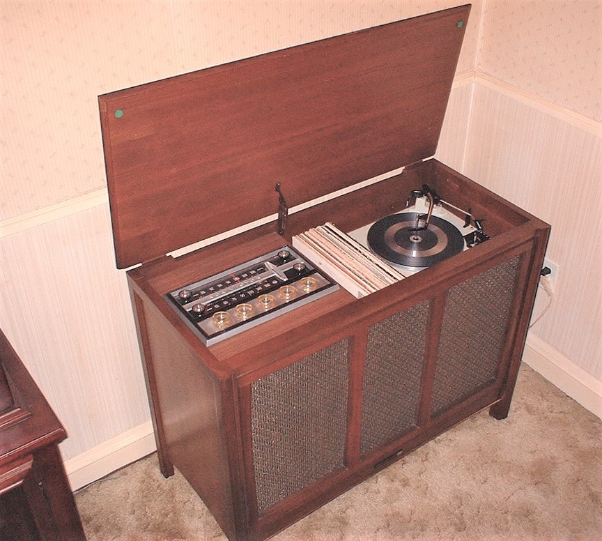

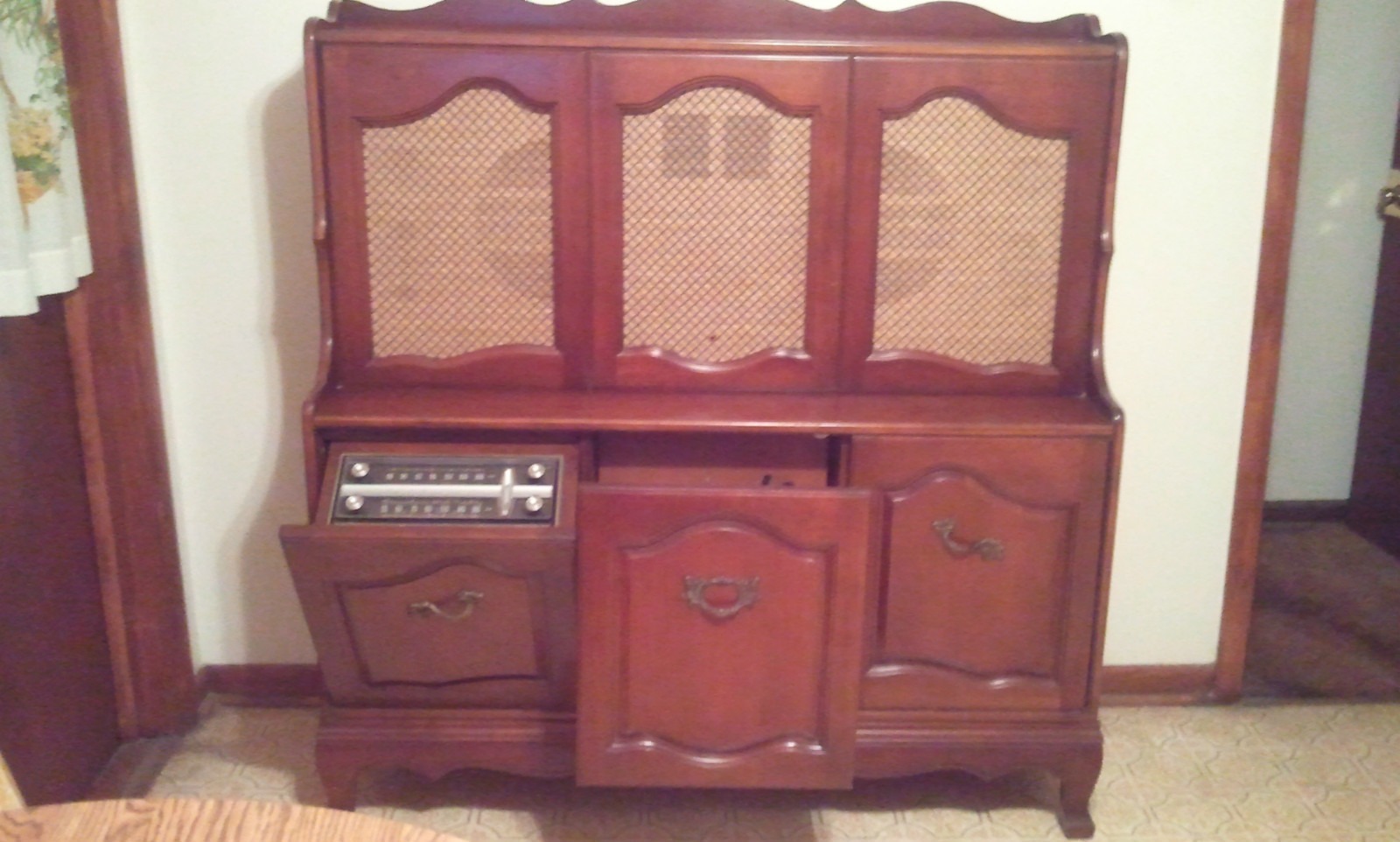

When I was young, my parents had an expensive ($620 in 1964 dollars) stereo console in a unique style cabinet.@wiseoldtech - I'm going to bet you are hearing reflected sound from the back of the cone coming back out through the cone with a shallow box. It would tend to reflect higher frequencies. If the box is indeed sealed, then the pressure inside the box would limit rear cone movement and lower than atmospheric pressure (vacuum), when the cone moves forward, would limit forward movement.
It was an RCA Victor "hutch style" advertised as having "ear level" sound.
I often had to turn the bass control UP to the max to satisfy my enjoyment and got yelled at by pop for messing with the control.
Even then, it lacked the "punch" of my rock n roll albums.
The speakers were in the upper portion of the "hutch" - a 3-way system with a pair of 12" woofers with a common port. - I think the back panel was around 8" from the front.
The 1963 RCA Victor console I own now, is a compact lowboy (spinet) version, with the exact same "high end" electronics and amp (PP 6BQ5's- EL84's) as my parent's console.
And using the same woofers, it produced substantially more bass "punch", much deeper, I'd estimate 3 times the bass level.
Of course, I've completely restored and modified my console, along with the speakers to suit my taste, but these photos will show what I was talking about.... cabinet depth vs bass output.
One of them is a rear shot of the "hutch", the other is my "spinet' in early stage of modifications.
There are a number of things at work here, especially the low corner placement of the "new" cabinet. I have always wanted to rebuild an older cabinet. Both of those look AWESOME. With 3 times more bass, there is definitly something to your observation.
I noticed the older cabinet had a midrange and tweeter, does the "new" cabinet have a midrange and tweeter? This is just curiosity.
Yes, the new console has a 3-way speaker system.There are a number of things at work here, especially the low corner placement of the "new" cabinet. I have always wanted to rebuild an older cabinet. Both of those look AWESOME. With 3 times more bass, there is definitly something to your observation.
And the new woofers are long-throw high-compliant types with cloth roll suspensions with huge ceramic magnets.
The console puts out incredible low growly bass when called upon by the music.
And the added 3/4 inch wood lining and bracing of the cabinet kills any resonances well.
Plus, a 38dB sub-sonic (under 25Hz) filter eliminates any feedback at high volumes to the Garrard 3000 turntable.

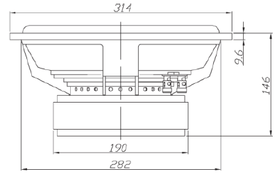

I mentioned earlier that the depth is approx. 22-23 cm but now I did a real measurement and the actual depth is 23 cm + 2 cm for the panel were the woofer will be monted in so that makes 25 cm in total.Falls in line with Altec's rule of thumb for not closer than 1.5x the driver's mounted depth and seems reasonable with a shallow and/or high Xmax woofer design it will be longer.
The Dayton woofer has an installed depth of 146 - 9,6= 136,4 mm
250 / 136,4 = 1,83
I am not sure how the sloped angle of 12 degrees diverts the reflections even more but I will be out of the critical zone

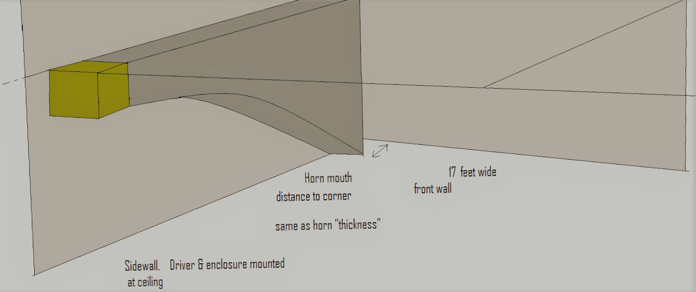

The angle won't "divert" low frequencies, but the cavity below the subs will provide upper "horn loading", raising output above around 80Hz.
Are you planning to use any DSP/EQ on the subs?
My comment referred to [and in retrospect, should have posted] a typical parallel baffle, side and/or back wall, though from theory/experience doesn't apply to > 12 deg included slopes or high aspect ratio cabs.I am not sure how the sloped angle of 12 degrees diverts the reflections even more but I will be out of the critical zone
Bass modules disguised & integrated into the room? What this is a pair of bass horns along two side-walls spanning the entire height, floor to ceiling, the length spanning the entire side of the walls. The driver sealed enclosure mounted up high, built into the rear corners. As expected, the room would have to be symmetrical.
