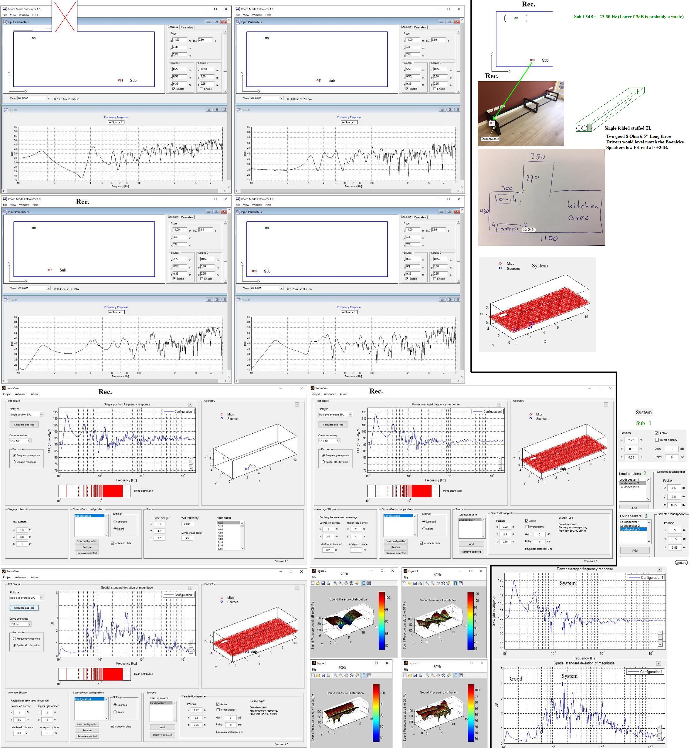

Hi Bjorno,
I am not familiar with the software so I am not sure what I am looking at.
I see you used my data to come up with a subwoofer design.
But the multiple graphs are confusing me.
I guess I would need a step by step explanation per drawing / graph. :confused:
Also the dimensional sketch with the floating red plane Is not clear to me.

A quick answer would be: To extent the Boenicke W5’s f-3dB: Add an adequate Sub that provide no more than Octave below Boenicke W5’s capability.
The floating Red plane is multi position measuring points used for Program Calculations but only the outcome of the White Rectangular Area(Your Listening Area) is used and presented at the Graphical result.
/ If input 50 W Rms(Channel to a Pair of these: SPL Max.= 10x (log (50+50)+84.5 dB= 104.5 dB ~Max: Thus a minimum SPL requirement for an added Sub less ‘Room Gain’ would be quite adequate. Normal SPL should be taken at a ~+3dB. 104.5+3= ~107.5 dB/
My previously Posted Picture:
This is an approach to figure out the Room behavior in prior to choosing a particular Sub that suits your Living Room. So in order to understand a plausible LF(Low Frequency) Room contribution I made two different type of Plots using the Room Mode Calculator and the Room Sim Program both are trade of tools and earlier used here at diyAudio.
Both yield different outcome as the Room Mode Calculator just use RT60 to predict an average Room Absorption affecting the Magnitude of Amplitude in the Graphs but not exaggerating the very low FR end like the Room Sim does that show a maximal possible boundary gain + in additional the probable Statistical FR Amplitude Average Level(No doubt: Your room is good in that respect). I.e. the Room Sim Program Graphs is depicting a Room with no Air leaks (a sealed Room) contrary to the Room Mode Calculator that show a behavior more what is expected for a Domestic average Room. The Room Sim program use average Wall Reflectivity for bouncing FR Rays* (Room Sim uses Ray Tracing Methods instead of Room Modes Calculations) to map influence on the Boundary Gain. I assigned a very low RT60 and a relative high Reflectivity to (Thumbs up if plausible!) 'boxing' in the two (extremes?) of possible 'Room Gain' considering the Room Layout and the design of the walls(Your submitted Pictures and rough Sketch).
Note: Not shown is why I left out the side extension of your elongated Room: I considered the influence is minor compared to the first of occurring Standing Waves and the substantial Window Losses+the Reflectivity of the Kitchen Area that should be beneficial for the return of strong Standing Waves around the Lowest λ/2 Room Resonance directed towards your Listening Area.
*If the RT60 is measured or estimated to be α= 0.8 s then the Room average Absorption α is:
(0.160 x V)/(α x S) where Room Volume= V(m^3) and Total Room internal Area is S(m^2) then the Average Reflectivity R is = sqrt(1-α); here= 0.924 as used in my Program running.
/ Looks like the Room has some Boundary Gain to add to the Sub for both of the Two previously Posted Room Simulations beginning at ~30 Hz and lower. My conclusion is: There is no need for a Sub to reach lower than ~25-30Hz: and if measured, will probably produce Levels above ~105 dB due to the beneficial expected Boundary effects. The BW (Bandwidth) needed to cover (extend)the FR for a Pair of Boenicke W5’s is quite modest, so a simple ~Max 25-30 to 70-80 Hz Sub should be enough./
