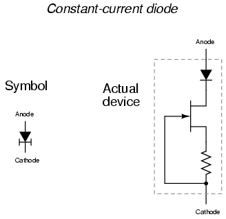

CRD=CCD
Current regulating diode=Constant current diode
A normal PN-junction diode is included in series with the JFET to protect the transistor against damage from reverse-bias voltage, but otherwise the current-regulating facility of this device is entirely provided by the field-effect transistor.

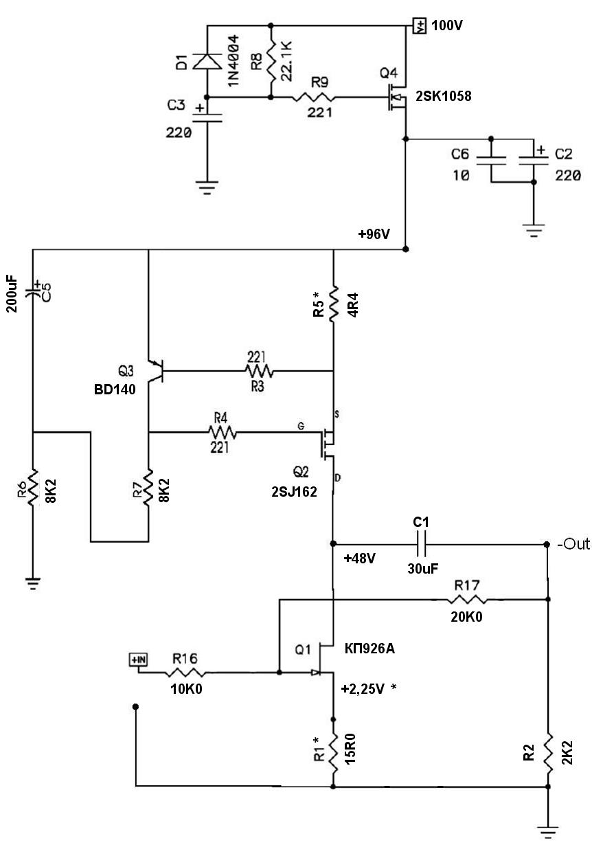

housing said:Thanks for your advice!
Please see the attached schematic. Is it possible to use the pair of 2SJ28/2SK82 in place of 2SJ18/2SK60? 🙂
Or should I start a new thread?
Sorry, didn't see the post. Sadly, no - maybe if the power supply for the output stage was higher. As it is, the standing current would be quite high.

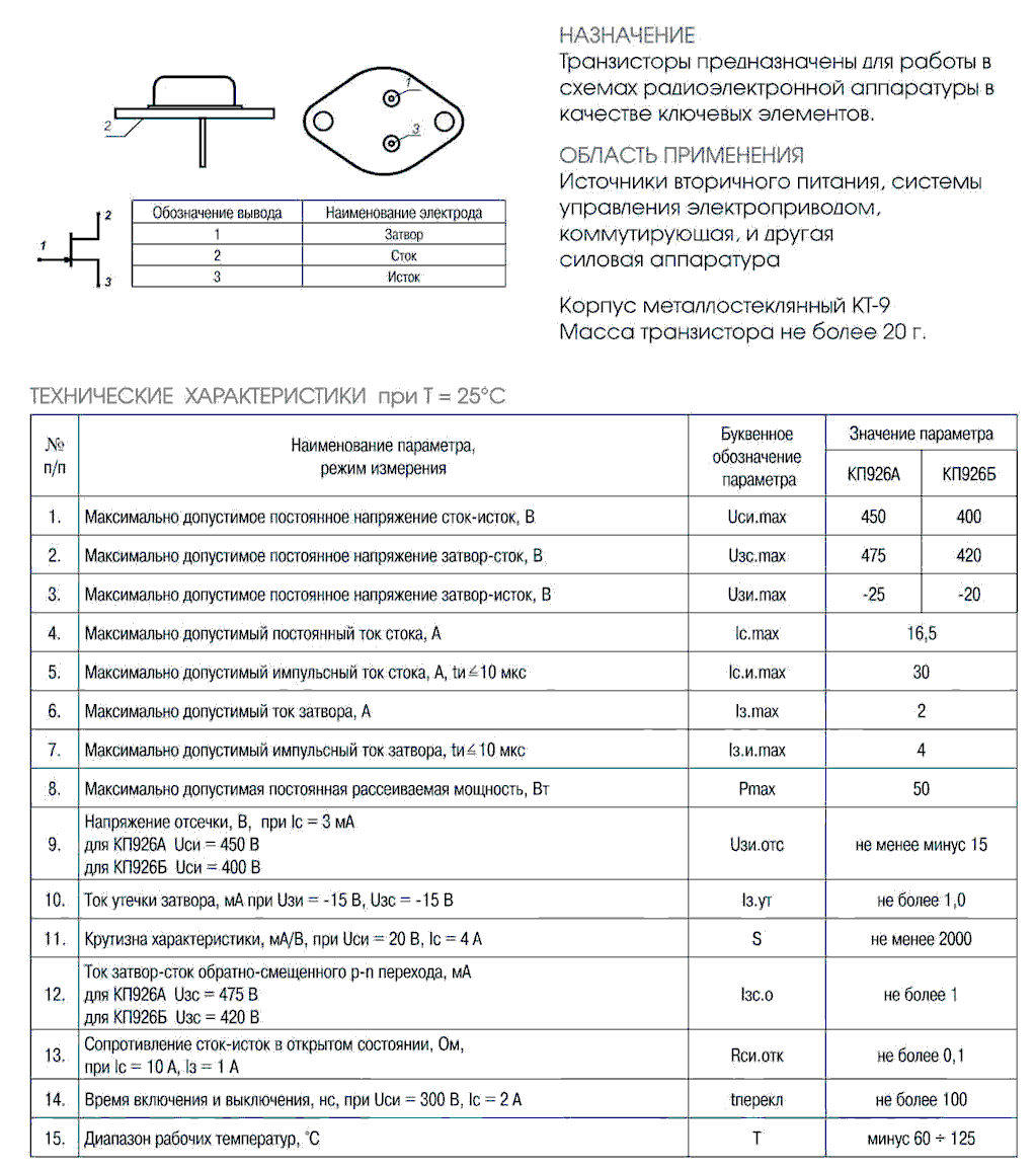

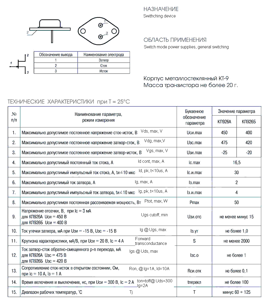

The funny thing is that КП926А(Б) are in production as we speak... ТО-3 BTW
NOS are $10 apiece
I've talked to the manufacturer just lately. Moreover there are lower voltage parts...
Attached is current datasheet
Alex
P.S. There is nothing in english version of site

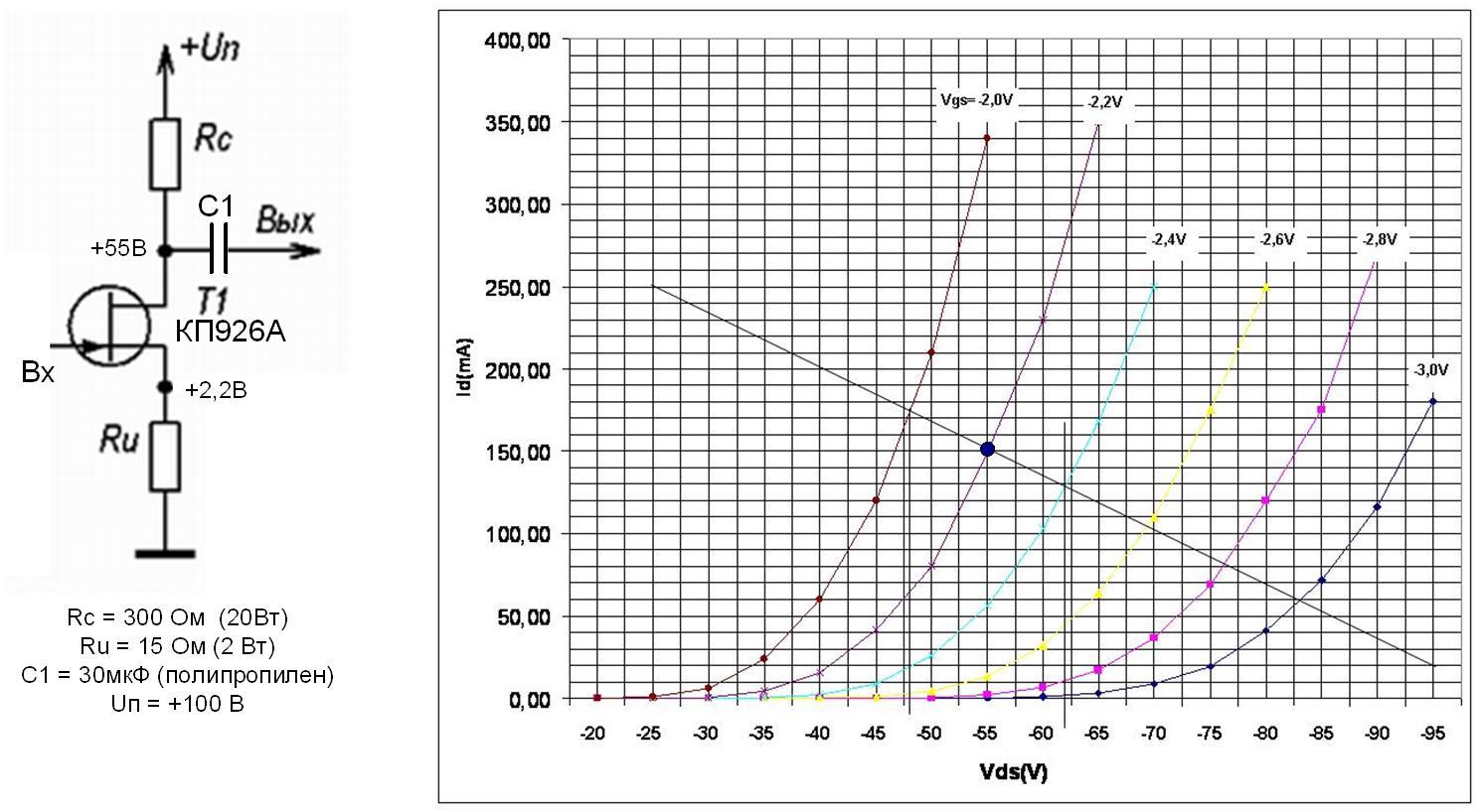

...high voltage JFET's ..probably which can support voltages of magnitude 150V...
Hi
450V is ok?
unfortunately no complementary devices,
but, look,
100V pp from one se device,
1V at the input,
not bad😱😕

The "KeyPi"926 is SIT(static induction beast) like a SS triodeyes
