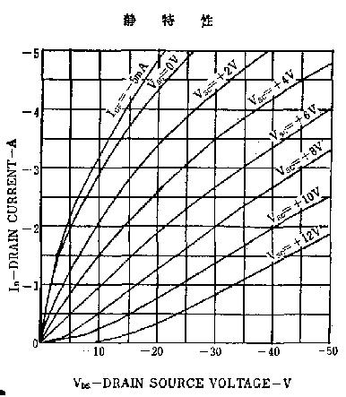

The memory will not go away and it would truly be a blessing for many audio designers if a company decided to produce them again. When they were originally made, the anizotropic etching process was new and expensive, today it would be an easy thing to do. The characteristics are indeed very triode-like (see attachment).

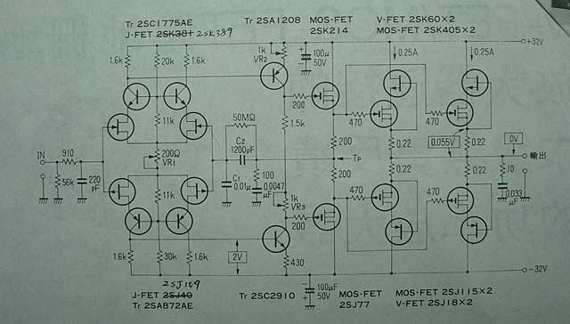

BTW 2SJ18/2SK60 are 5A 160V types, 2SJ28/2SK82 are 10A 200V types. The first were used in class AB amps, the second in Sony's class D offering which is still bleeding edge even today (500kHz fixed frequency design from 1978!).
The problem with these parts, apart form the price, was the very fact they were depletion mode, with Vp of about 25V for the J18/K60, and a whopping 55V on the J28/K82. Unlike small signal FETs which can self-bias due to small Vp and small currents and not waste huge amounts of power, the VFET needs an auxiliary power supply, which MUST be present before the application of the main power supply, otherwise in a class AB complementary amp, your output is shorting the main power supply.
By teh end of the Sony VFET amp line, they used a hybrid power stage, composed of a BJT/VFET cascode, which circumvents the need for extra power supplies.
2SJ18/2SK60 can still be found on occasion, whereas the other VFETs are practically unobtainium: about the only way to get them is to buy broken VFET amps on Ebay, but since these have a following, prices are up. For instance, a working pair of 2SJ28/2SK82 (normally impossible to find) can easily go into the 100$ price region.
Just for fun, here are the Id / Vd @ Vg curves for the 2SJ18:
